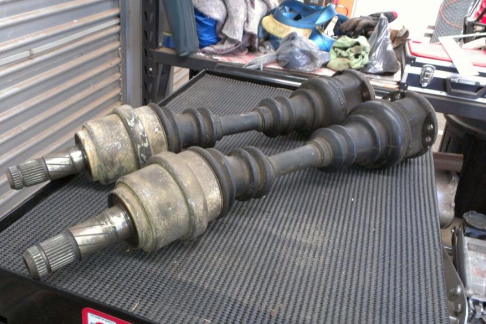

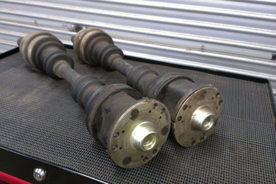

Riceburner Posted May 22, 2014 Posted May 22, 2014 Hey guys, I have some 300zx CV shafts from a Z31 Californian model. Are these of any use? Quote
NZeder Posted May 22, 2014 Posted May 22, 2014 Too long for use in a 240z/260z good for a z31 mind. Quote
NZeder Posted May 22, 2014 Posted May 22, 2014 You could shorten the shaft and have the splines lengthened at one end then refit the cv joint then they will work. The z31 turbo and r31 cv shafts with the 4 bolts at the hub end are shorter and do work (however most flip the cv cage to shorten by a little, we made a new custom axle for the short side then use the standard shorter axle on the long side. You do have to strip the axles completely to do this but you want to rebuild the cv anyway they will be 30 years old and all) Quote

tir33d Posted May 23, 2014 Posted May 23, 2014 They look like my 280zx R200 shafts. How much? If someone can confirm they are the same. Quote
NZeder Posted May 24, 2014 Posted May 24, 2014 They look like my 280zx R200 shafts. How much? If someone can confirm they are the same. look the same but very different. Longer and the bolt pattern is the same but on a much large pcd. So will not work. Quote
