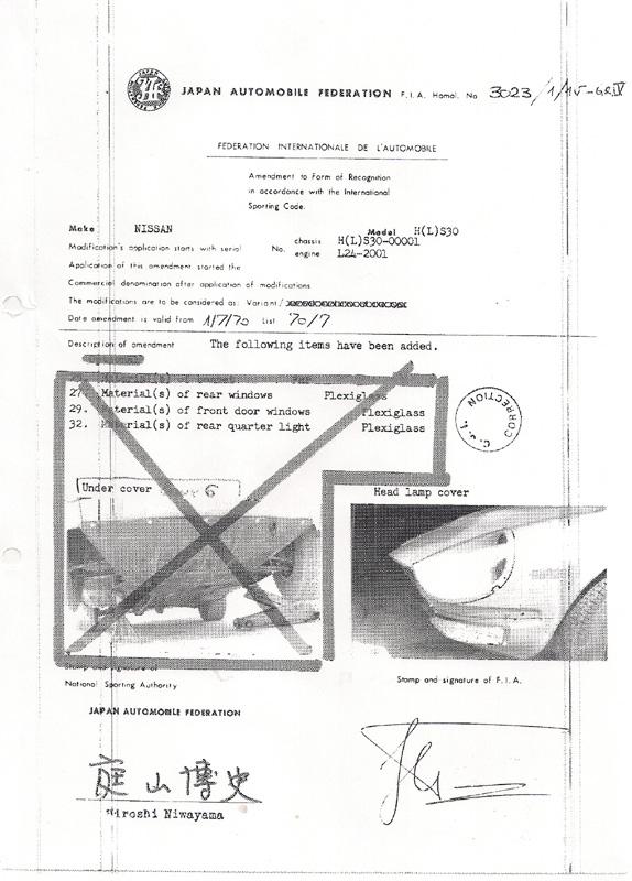

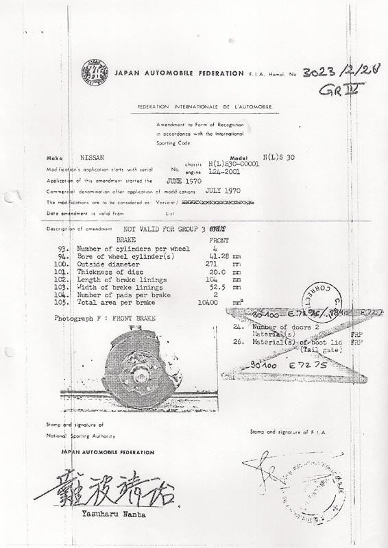

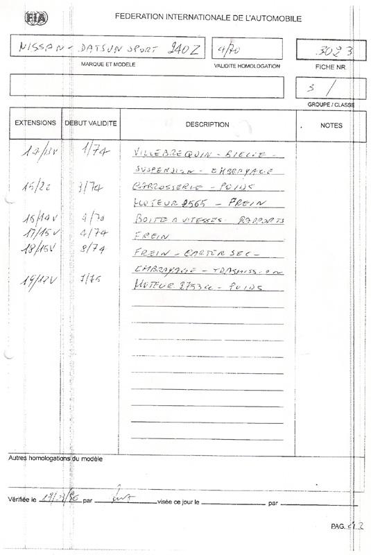

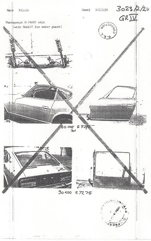

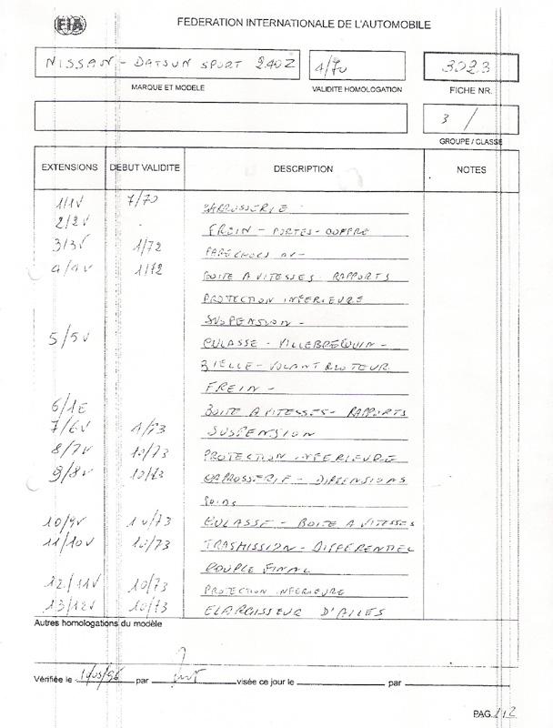

d3c0y Posted November 13, 2013 Author Posted November 13, 2013 They're all cheating so it doesn't matter So Z-Gs, where does 2B stand on them? Cause technically it's a specific model not aftermarket parts just added to the car. Quote
PZG302 Posted November 13, 2013 Posted November 13, 2013 No problems to run the ZG nose in 2B, plenty have in the past as the panels were listed in the homologation papers with the part numbers. Best bet is to ring or visit CAMS office and get a copy of the FIA homolagation docs. But, ask for a set that has not had the ineligible parts for PRC covered up as you need it for sports car racing not rally, or you may get a copy from europe or direct from FIA. I know they cost a few dollars now. I have a set of S30 papers but all the really good bits are covered with a note saying "not eligible for PRC". In regard to the block, some events it was worth me saying I had a stroker when I had the 2900 in to bump me up a capacity class where I was faster..... Quote
d3c0y Posted November 13, 2013 Author Posted November 13, 2013 After a quick search I came up with these and hopefully this is a good start. Quote
d3c0y Posted November 13, 2013 Author Posted November 13, 2013 Can anyone read french :/ ? Fifth image Quote
