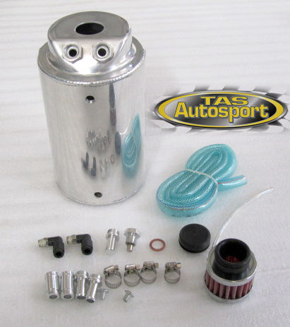

Scoota G Posted November 9, 2013 Posted November 9, 2013 Perhaps if you had the bracket for the carbon canister and then got one of the catch cans in the following link (2 Litres) Would that suit your purposes. They are a similar size. http://www.ebay.com.au/itm/130837356563?ssPageName=STRK:MEWAX:IT&_trksid=p3984.m1423.l2649#ht_444wt_770 Quote
