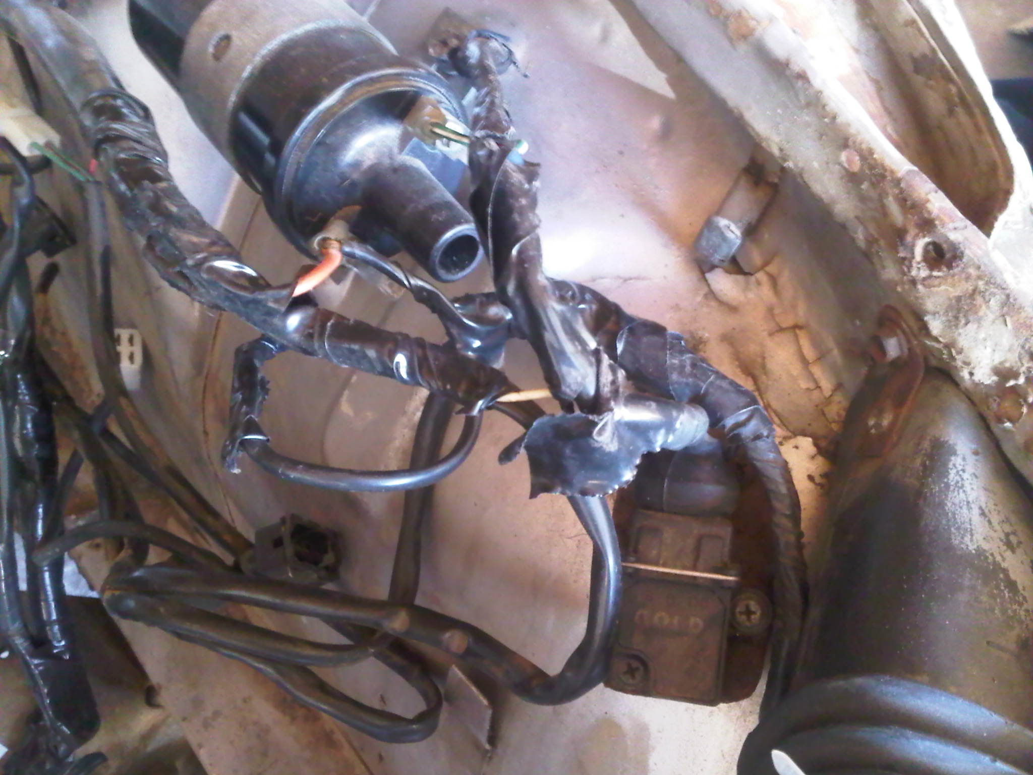

Retro Z Posted September 5, 2013 Posted September 5, 2013 Hi Guys. Wondering if anyone can tell me what this item is. Its a little square box screwed directly to the sheet metal just in front of the coil and behind the fresh air duct on the passenger side tub/bay It has a plug that looks almost identical to the TPS plug on my efi intake with 3 wires. I recently unplugged it and one of the pins snapped off as it was corroded, so i need to replace it with another or something similar. Is it some kind of ignition module? My car is not going yet so i cannot test to see. The engine is a L28et from a us spec late 280zxt (p90a/f54) with microtech Lt-8 ecu Was previously installed and running in a early 260z 2+2. Now in a late 240z. Any help would be appreciated. Quote

Moderators Zedman240® Posted September 5, 2013 Moderators Posted September 5, 2013 I'd say it is a transistor of some sort; looks like that bracket is a heatsink as well. Check on the HybridZ site for more info if they have any. Quote
Retro Z Posted September 5, 2013 Author Posted September 5, 2013 I'd say it is a transistor of some sort; looks like that bracket is a heatsink as well. Check on the HybridZ site for more info if they have any. thanks Dimitri i just put up a post on Hybridz. Google the part number ? yeah i have already done that, aswell as visit repco/burson and the code brings up nothing on their systems Quote
Six_Shooter Posted September 5, 2013 Posted September 5, 2013 Have you looked in the FSM yet? The markings would be consistent with a coil igniter. Quote
Retro Z Posted September 5, 2013 Author Posted September 5, 2013 Thanks for the help unfortunately i don't have the FSM. i only have a 240z L24 specific fsm. Can you elaborate on where i may be able to find a replacement? I haven't been able to find anything similar on N/A 280zx's that are wrecking (parting out). Quote
Administrators gav240z Posted September 5, 2013 Administrators Posted September 5, 2013 Definitely looks like the ignition module I had on my wait for it... 'Mitsubishi' distributor. http://www.viczcar.com/forum/index.php?topic=935.0 But it looks different, I have heard you can fit an ignitor module (another Bosch Module) to a Z distributor (seem to remember it was a Ford). Perhaps someone hooked that up as a modification when they couldn't find a ZX module? Do you have an electronic distributor? Quote
pauly_adams Posted September 5, 2013 Posted September 5, 2013 http://www.xenons130.com/reference.html there is a link to the manual Quote
Retro Z Posted September 5, 2013 Author Posted September 5, 2013 Definitely looks like the ignition module I had on my wait for it... 'Mitsubishi' distributor. http://www.viczcar.com/forum/index.php?topic=935.0 But it looks different, I have heard you can fit an ignitor module (another Bosch Module) to a Z distributor (seem to remember it was a Ford). Perhaps someone hooked that up as a modification when they couldn't find a ZX module? Do you have an electronic distributor? Thanks Gav. The mystery thickens. Yes i do have an electric distributor its the same as this one pictured with the same plug aswell. Uploaded with ImageShack.us Uploaded with ImageShack.us Quote

Administrators gav240z Posted September 5, 2013 Administrators Posted September 5, 2013 If I had to take a serious guess I'd say it's part of the 280ZX optical distributor set up found on the turbo models. Quote
Retro Z Posted September 5, 2013 Author Posted September 5, 2013 Hi guys thanks for all the help. I have managed to find out what it is after a few hours of scouring the net. Its a universal Tridon ignition module used for nissan/subaru/toyota. I was googling the whole number and brand (as pictured) previously to no avail but i found it under TIM036. Just ordered it so hopefully my car should run once installed. thanks again guys. Tai. Quote
