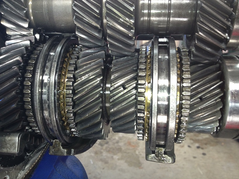

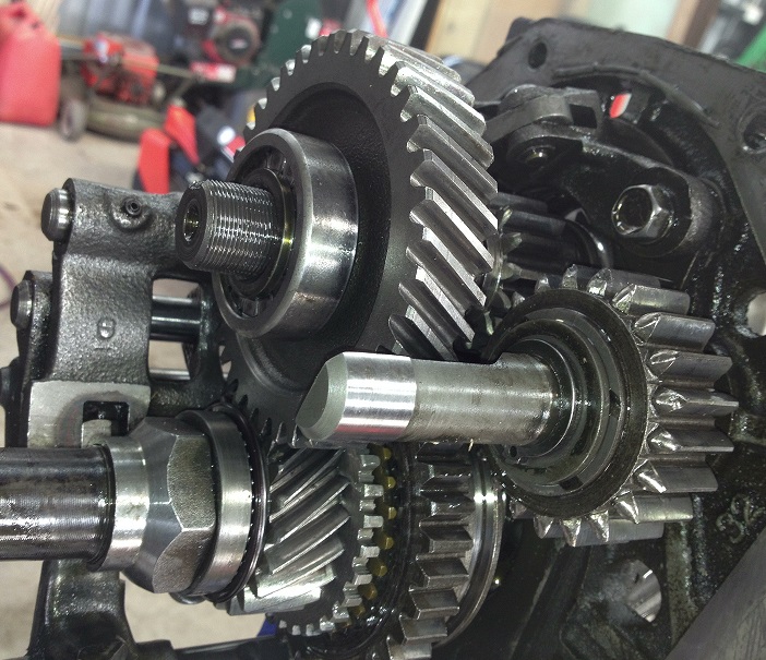

Riceburner Posted June 28, 2013 Author Posted June 28, 2013 Bearing came out, I just needed an extra set of hands on the pullers and muchos grunt to get the fifth gear syncro hub moving on the shaft. All pulled down. I'll need to get the Lseries bellhousing plunge cut 2mm, bearings, syncros, fifth gear, seals, main/counter shaft nuts. Possibly a CR set. A few things (see pics), I noticed some funny colors on the syncro hubs.... Could it be oxidising from the failed bearing? Also the reverse counter gear has some decent chips on the edge is it still usable? PPG/Pfitzner offer gearsets but they state on the website no warranty unless the sandwhich plate is modified to stop oil starvation on sr20 which is the same as rb20, is this a worthwhile mod (see pic)? I have it out so it's easy to do. Quote

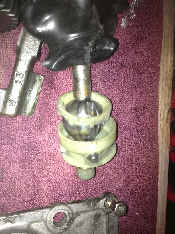

Riceburner Posted June 30, 2013 Author Posted June 30, 2013 Can anyone tell me what I'm missing from the shifter mechanism? It looks like maybe a circlip and a spring or bush? Quote
dat2kman Posted June 30, 2013 Posted June 30, 2013 There should be a loose internal circlip that sits on top of the upper white plastic ring. Also under the rectangular shift plate cover, a detent ball and spring, held in by a bolt, head is larger than others, it is a wpecific length. Quote
