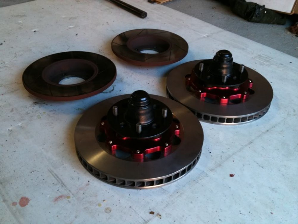

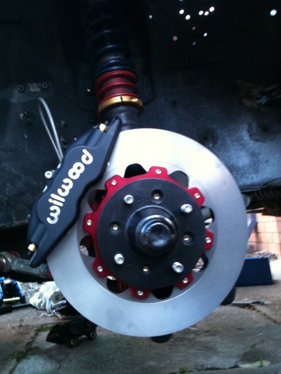

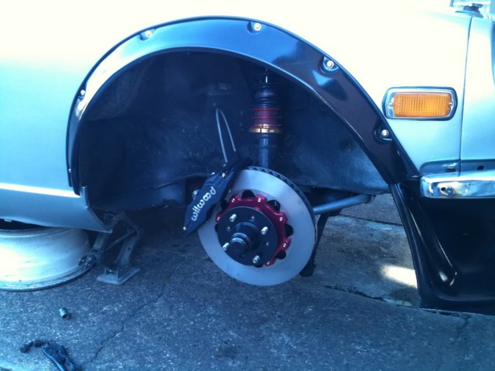

sco_aus Posted July 1, 2011 Author Posted July 1, 2011 So I finally got around to installing my AZC brakes yesterday with the help of a friend. I still cant believe how easy it was. But we had a small problem: On the back of the caliper where the brake lines bolt into, they have a sort of nipple. This nipple was leaking on both calipers, but I had some thread tape laying around which fixed, but im not sure it would hold on the track. If anyone has any ideas, or if you think that should be fine, let me know... Anyways, pics: Quote
Moderators Zedman240® Posted July 1, 2011 Moderators Posted July 1, 2011 If you don't mind me asking...how much was the total? I have another 260 that needs that treatment.. Quote
sco_aus Posted July 1, 2011 Author Posted July 1, 2011 For 4 pot calipers, brake lines, 12.2 inch HD alloy rotors, pads and brackets, including postage was $1070ish. I consider it quite cheap considering if you paid a brake shop to replace all of the above parts on a standard car + labor, it would be similar prices... This is much better... Quote
Administrators gav240z Posted July 1, 2011 Administrators Posted July 1, 2011 For 4 pot calipers, brake lines, 12.2 inch HD alloy rotors, pads and brackets, including postage was $1070ish. I consider it quite cheap considering if you paid a brake shop to replace all of the above parts on a standard car + labor, it would be similar prices... This is much better... Nice is that the front brakes only? My rear drums are well trashed or at least the master cylinder is gone in them. Always wanted a good set of brakes on the 240z. Quote
sco_aus Posted July 1, 2011 Author Posted July 1, 2011 Yeh that's front brakes only. I am running R31 rears which should be more than enough with a decent set of pads. Quote

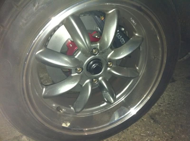

SS30RR Posted May 3, 2012 Posted May 3, 2012 nice brakes brotha......I've got the same kit........need to play around with mine though.......not sure if its' the pad but initial bite is not great. Quote
sco_aus Posted May 3, 2012 Author Posted May 3, 2012 Really, my initial bite is painful, it brakes so bloody hard and is hard to drive in traffic, but I have a 1 inch MC, not sure if you have the same. Quote

SS30RR Posted May 5, 2012 Posted May 5, 2012 Really, my initial bite is painful, it brakes so bloody hard and is hard to drive in traffic, but I have a 1 inch MC, not sure if you have the same. I'll check what MC I have. Could be it's seen a few track days now and just needs a bleed.....a little spongey now that I think about it. Quote
SS30RR Posted July 7, 2012 Posted July 7, 2012 What pads are you running? Hey I noticed on mine the outer pad wears out quicker than the inner. Good idea to check on your pads regularly and rotate left inner to right outer to get good wear out of them. Forgot to check what MC size, will do tmrw. Quote
sco_aus Posted July 7, 2012 Author Posted July 7, 2012 The pads are the ones that came with the kit and I haven't driven it enough to even wear them, infact I doubt they are even bedded in properly lol. Thanks for the tip, I'll keep an eye on them. Quote
