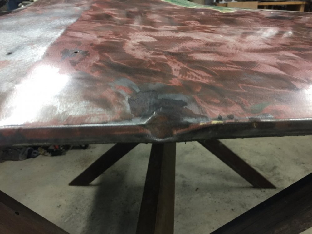

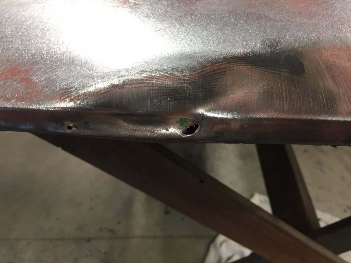

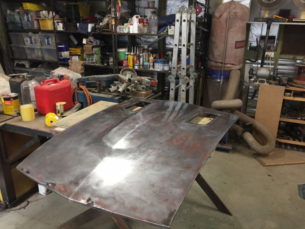

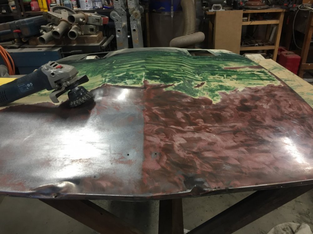

  14. Hi Guys Started a full resto on my recently purchased 77 GSR30 a couple of weeks ago and have now got to the bonnet which is proving a challenge. I'm using paint stripper and mechanical follow up with a grinder and wire wheel. I did the front guards and the nose cones without any major issues but did need to do up to 3 runs with the stripper (Poly Stripper - Dichlormethane) and then a final run over with the wire wheel. This car has had 3 paint jobs in its life by the look of things and the second one looks to be a 2 pack which has set like a rock on the bonnet and probably on the roof and doors when I get to them. The top coat which is crazed and peeling comes off easily, as does the first coat once you get the 2 pack off. The picture below shows my attempts at softening the yellow 2 pack layer and the result I get on the right with the grinder and wheel after the top green coat is removed with stripper. the shiny finish on the left is a test with 120 grit in the orbital sander. I'm conscious of the heat issue with the grinder and as constantly cooling with a damp rag and moving to different parts to limit the amount of heat I'm generating. The $64,000 question: is this approach ok, or am I doing some sort of irreparable damage? Does the second coat seem like a 2 pack and that' s why it is so hard to remove? Third question, what is the purple coloured finish on the right? On a different note, there are a couple of significant dings on the leading edge of the bonnet and I was hoping I could get some advice as to the best way to attack them. Have attached close ups below and thought maybe I could run a fine cut along the top edge so I could pull the front out and knock the top down then patch and fill. Not sure if that would work so any suggestions would be most appreciated. Thanks again. Cheers Paul
