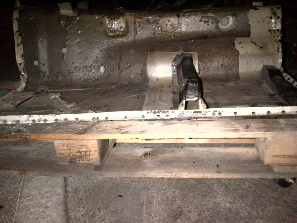

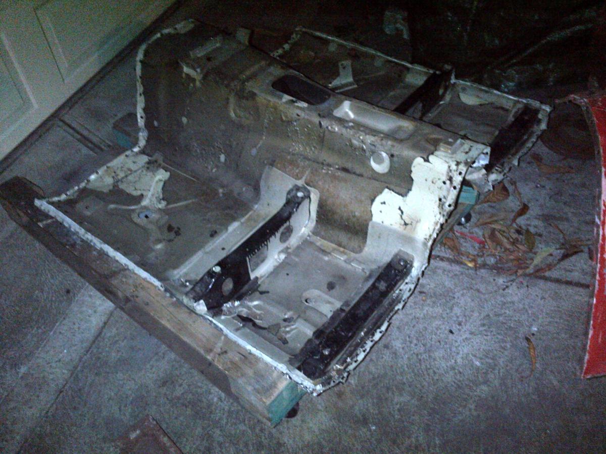

  5. gavz right. it also has the larger transmission tunnel spot welds have beem drilled out otherwise if fits right over the same space - perahps a racing project for a 240 if you want to fit a larger tranny?

  7. In really excellent shape, couple of tiny surface rust patches, late type seat brackets i think. not sure what these are worth, will put pic up soon PM me if interested can put on a timber pallete with wheels for shipping
