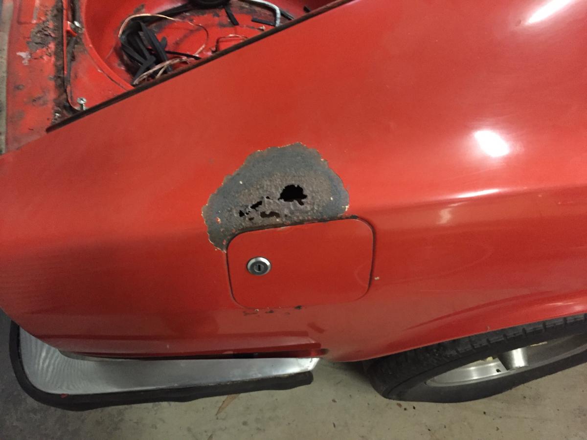

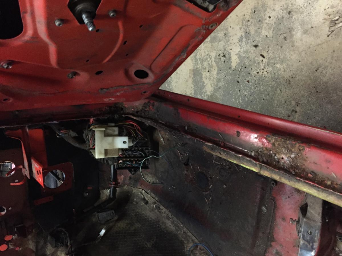

So its been ages since my last post and there's been a fare bit of progress. The car has been completely stripped to a rolling shell and handed to my panel beater for blasting and all hanging panels off. He talked me into taking off the rear quarters when he saw the dog legs and a small amount of rust on the rear window surrounds. BEST DECISION EVER... As you can see from the photos, if we hadn't taken them off i would've been looking at bubbles on my nice new doglegs in 3-5 years. Other areas that came to light were the passenger foot well/ lower battery tray, beneath the slam panel, where the A-pillar meets the inner guard, and once all the leaves were vacuumed out from under the beaver panel there was a square box that the blower motor bolts to that was rat s*#t... and just a touch on the firewall. Also found that the car has been in an accident at some point in its life and a pretty shitty attempt at a repair been done on the drivers side, floor is a little beet but easily fixed. So a bit more than i first thought, I'm a little disappointed by how much was found in total but its not the end of the world.

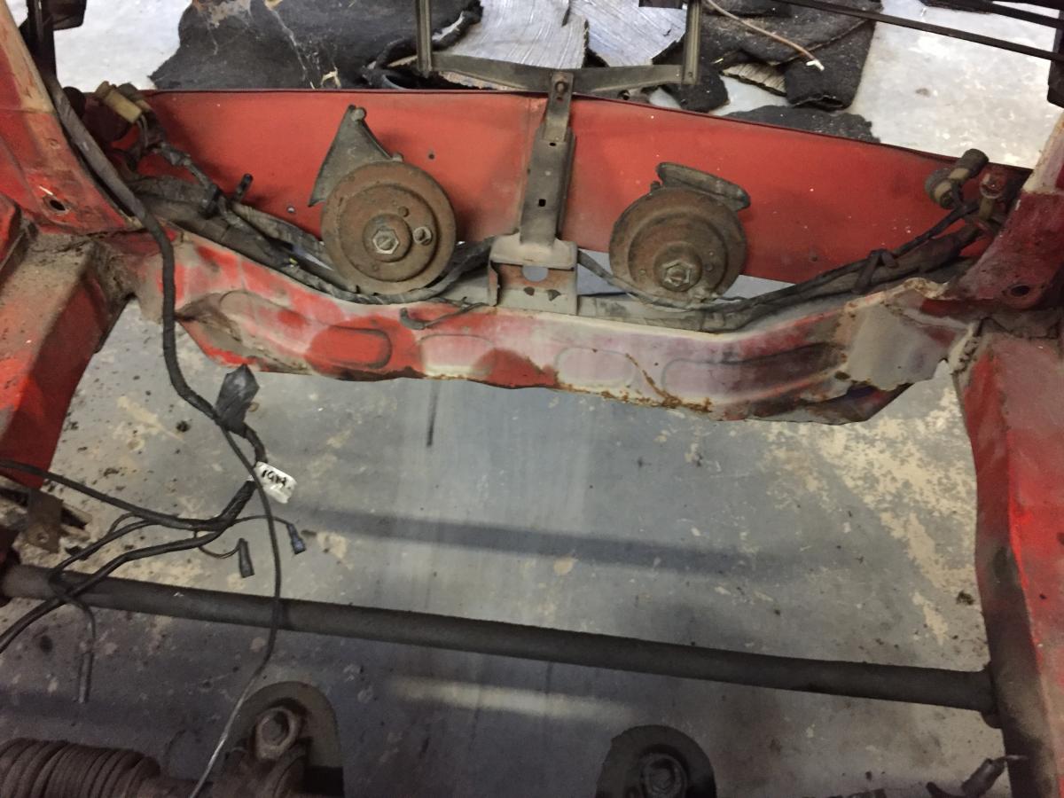

Just thought I'd throw up some photos summarising the areas that need attention that I've come across after stripping the car. Apart from the areas in photo's the floor rails will need to be replaced, not necessarily rusted out but beaten to hell so may as well weld in some new ones with thicker sheet steel while I'm at it. The radiator support is the same, Not rusted but who ever owned this is the past must lived down a rough dirt road cause its beaten to hell as well. Had a chat with dattocam and he thinks he'll be able to help with most areas that I've outlined which is incredible, can't thank him enough. And getting the floor rails bent up at the local steel supplier in town. Quick question would be: What gauge of steel would people suggest for the floor rails? And would it be ok to cut the floor rails after they taper up into the chassis rails and just weld in the straight section?

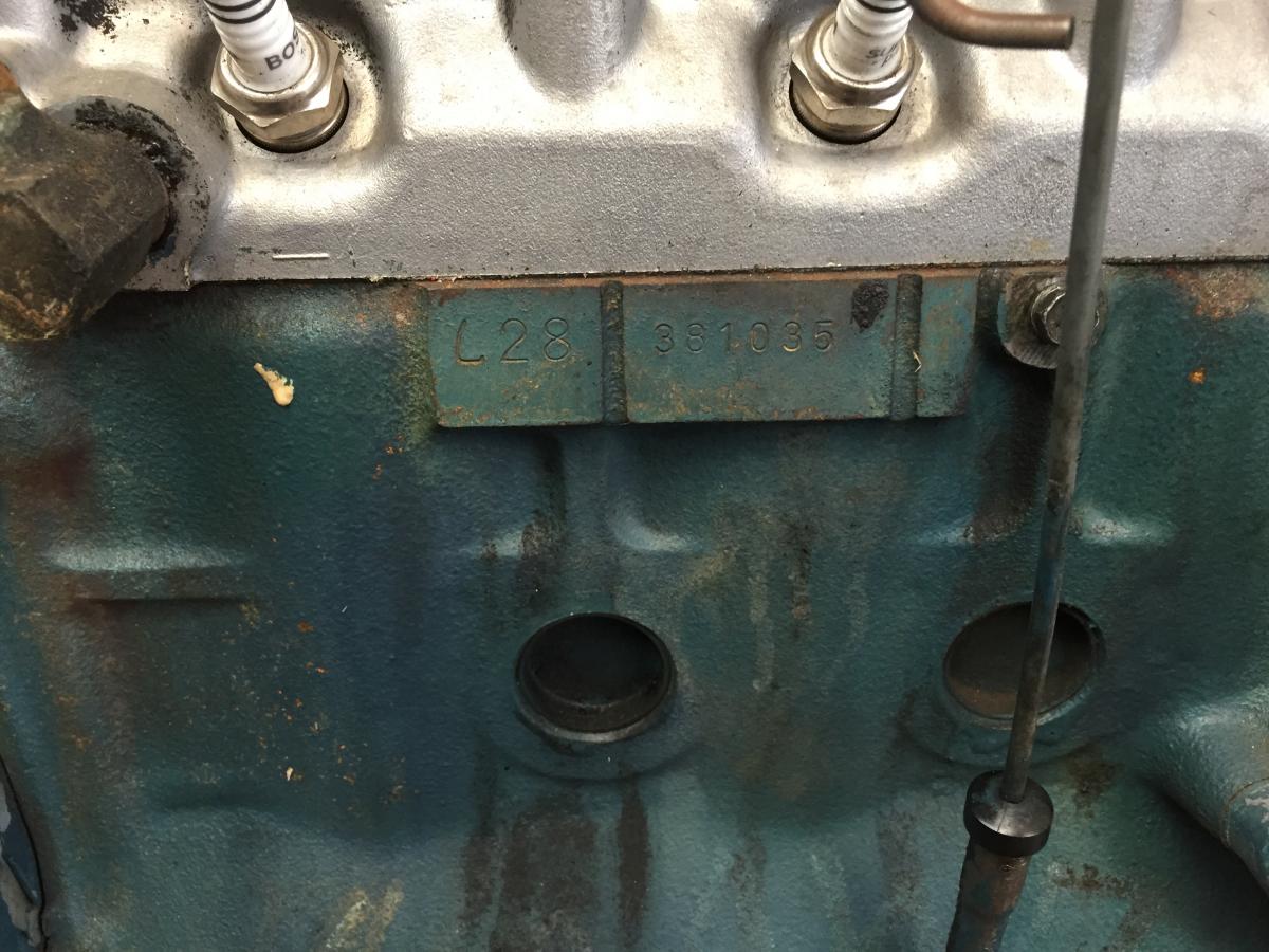

Thanks for the encouragement Jeff. The more I pull the old girl apart, the better the starting base looks. After pulling out the trans, I saw the full extent of damage to the floor rails. Drivers side is sold however it looks like someone has taken to it with a mash hammer! and the passengers side the same, with a bunch of rust right at the rear of it. Apart from those and the few spots pictured above everything looks pretty tidy. The L28 has been freshened up by the looks of it recently, which might might lead to some money saving in replacing bearings rings etc (depending on how money is looking when I start on the motor) dash looms etc look excellent, apart from some backyard looking radio loom install and a rough relay install which I'm assuming was for lights, also a blown out connector coming from the indicator stalk that had been bypassed, which is all small things that should be easy for a handy sparky such as myself to address The hard part will be to keep the momentum going when the car goes to the panel beater...

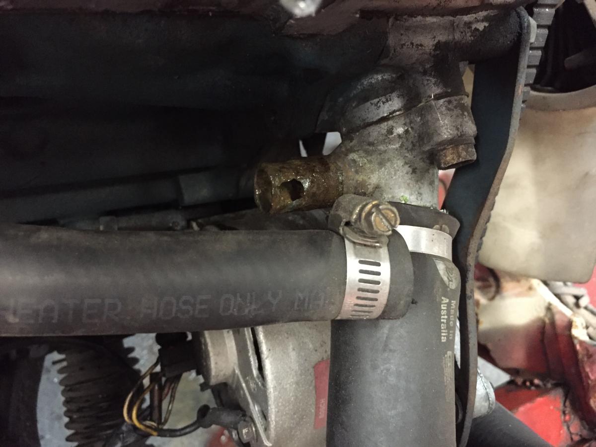

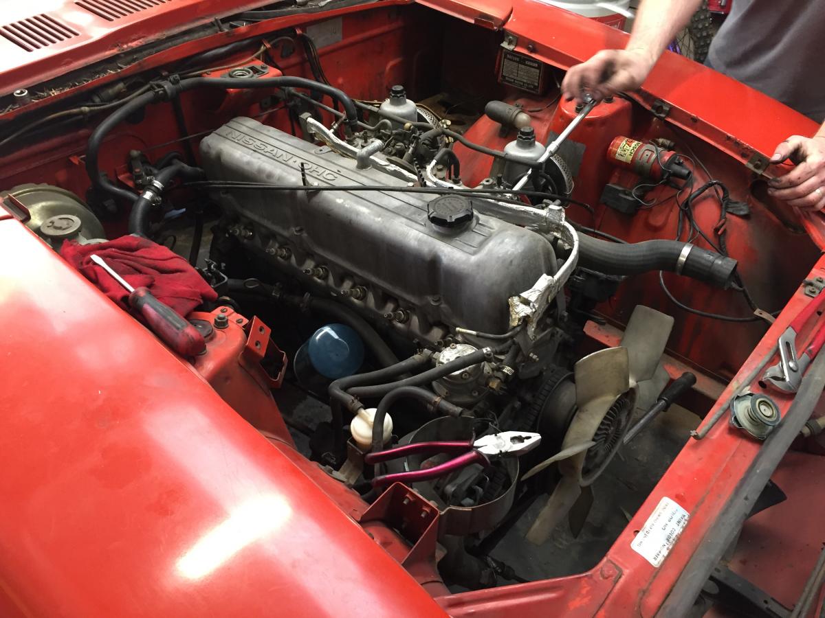

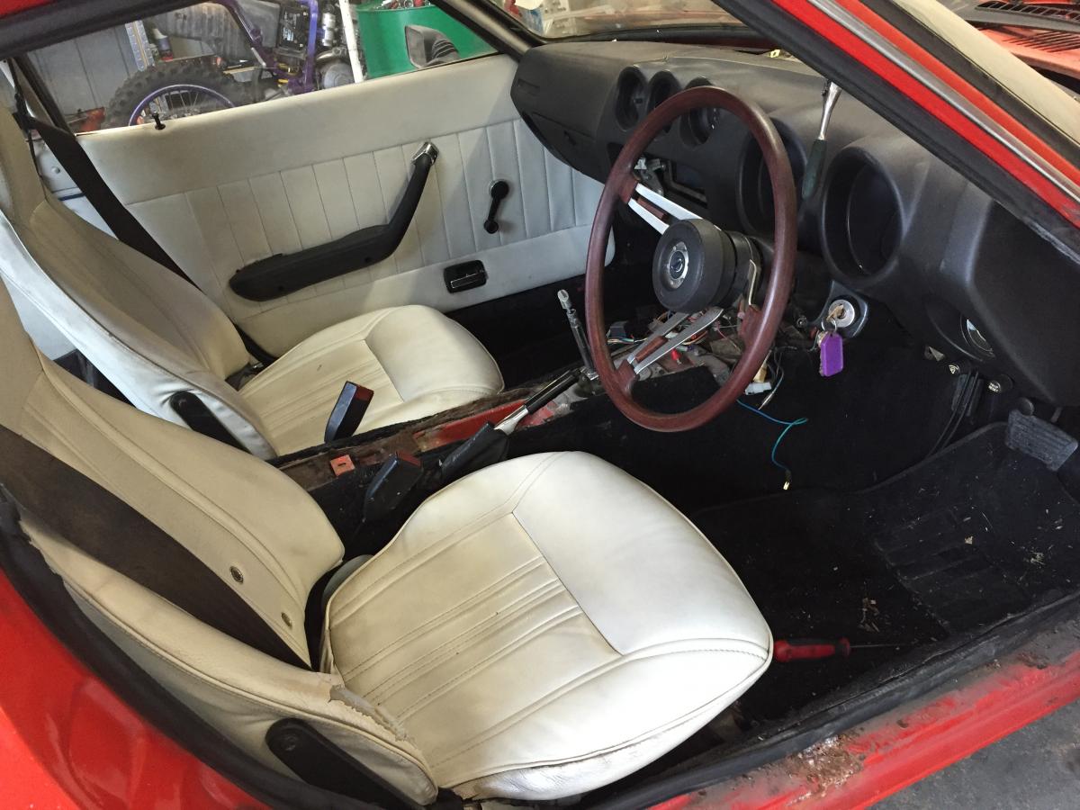

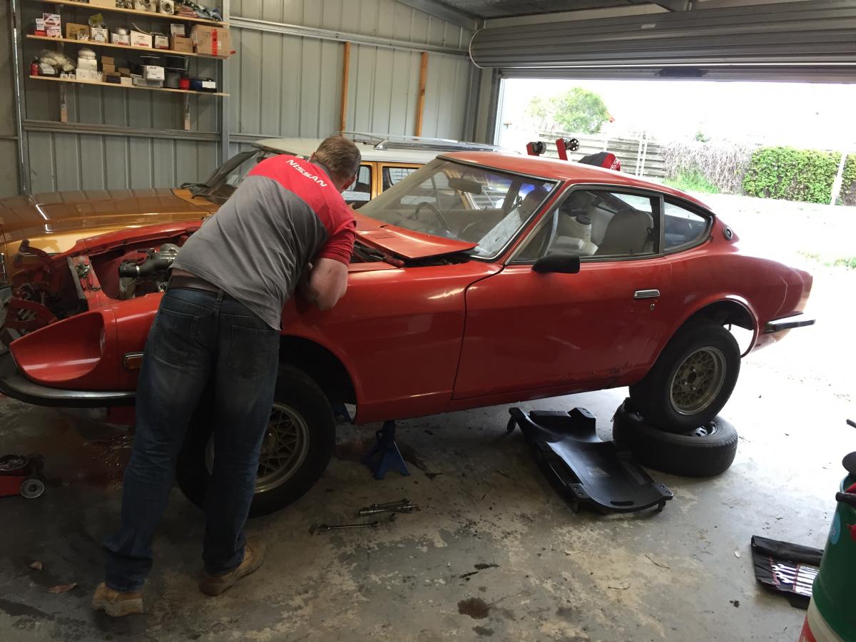

Made some progress today. Thanks largely to the help of my brother in law. We managed to remove the engine, transmission came across some rotten coolant housings. Going to have to sort them out. Also started on the interior, removing the dash and seats. Found the original trans tunnel vinyl hiding under some grotty carpet. Pictures attached

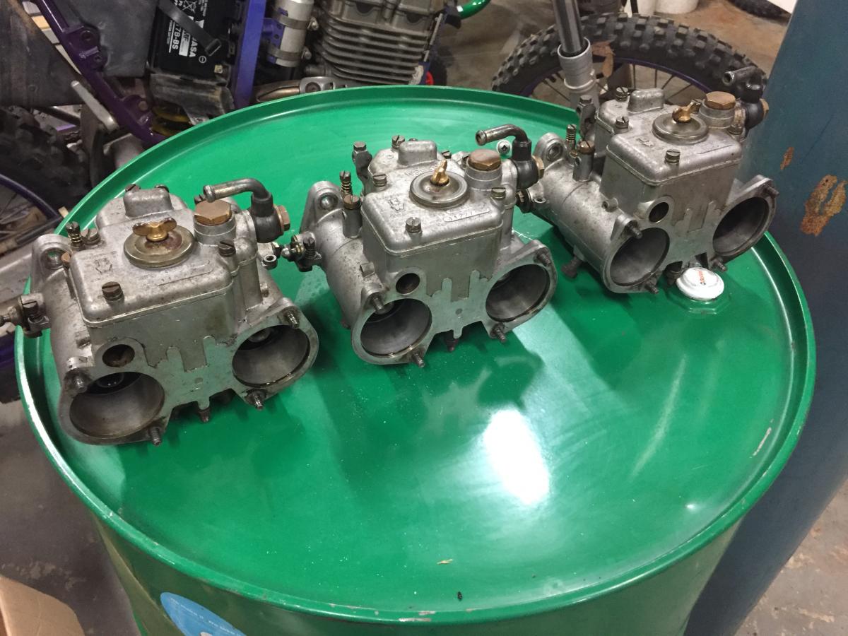

Picked up these bad boys yesterday also. All fairly close numbers and all jetted alike. Not like the 40mm mikuni fiasco that unfolded in one of the for sale posts. They came with linkages and soft mount gaskets also which helps. Might just need some gaskets and one of the chokes is damaged, God knows how...

Might keep 2 then and offload the a pair with the manifold and linkages.
