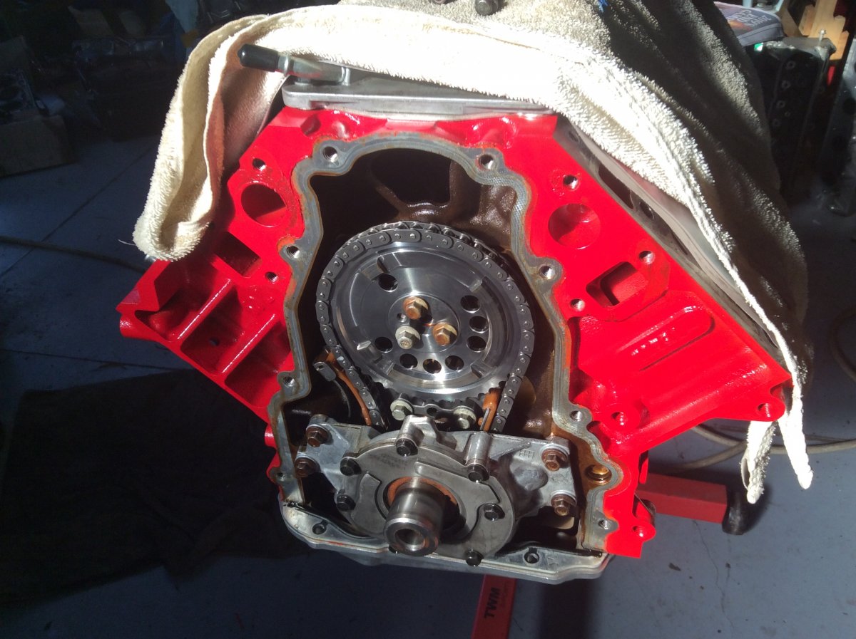

  1. After waiting for a new spigot bearing I installed the fly wheel, clutch and gearbox today

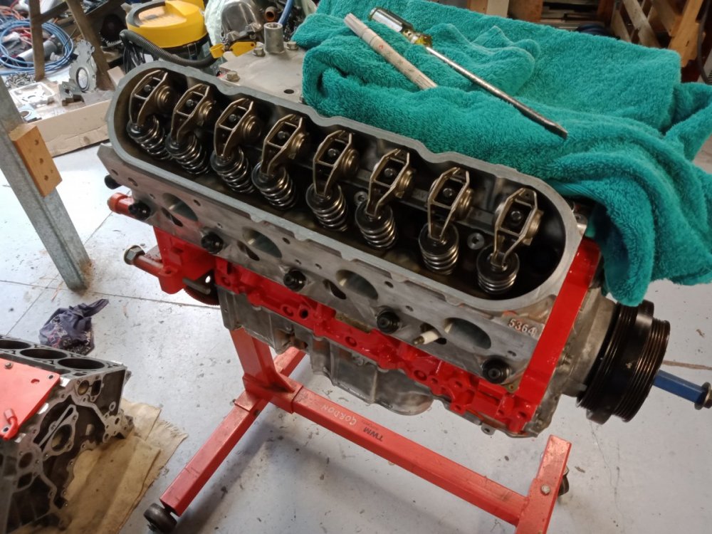

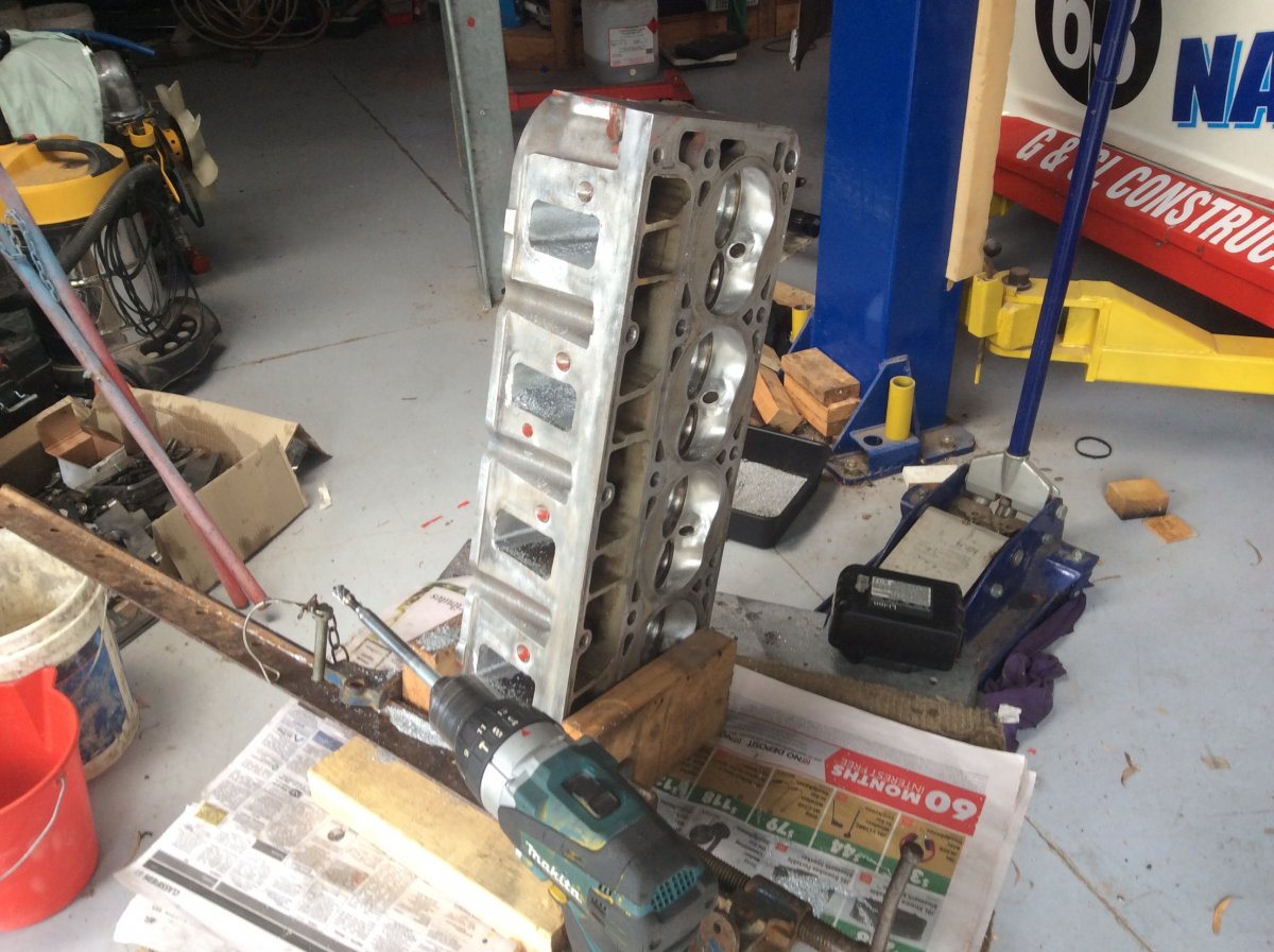

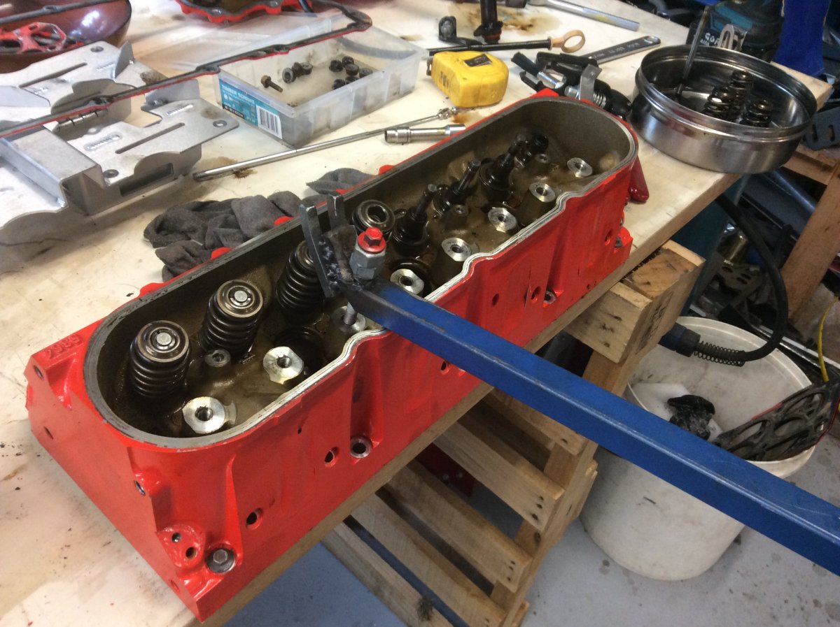

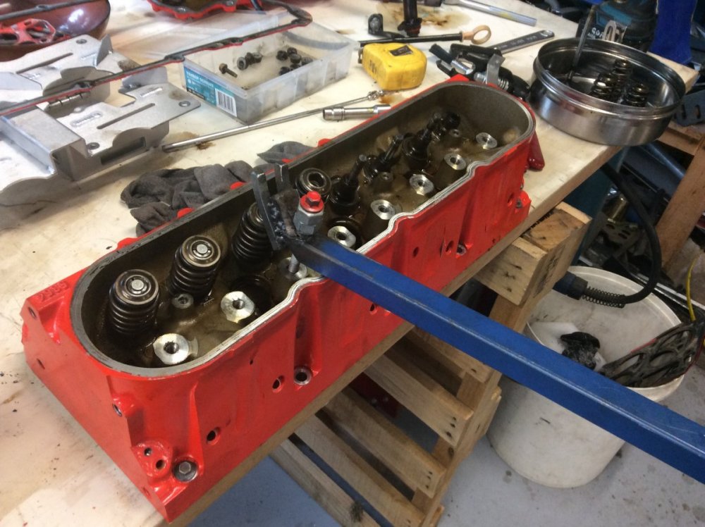

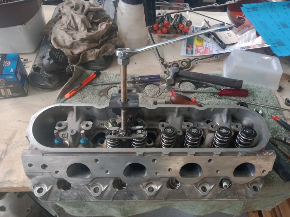

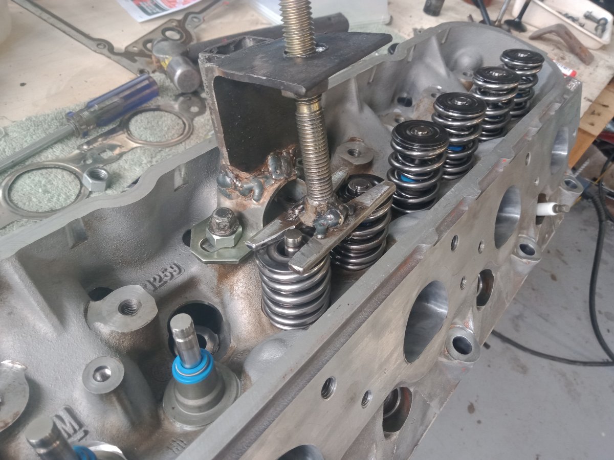

  2. It's been awhile. Finally finished the head's. I estimate about 70 hours. Fingers crossed they work. I made myself a tool to install the valve's. Made it much easier. So the motor is back together.

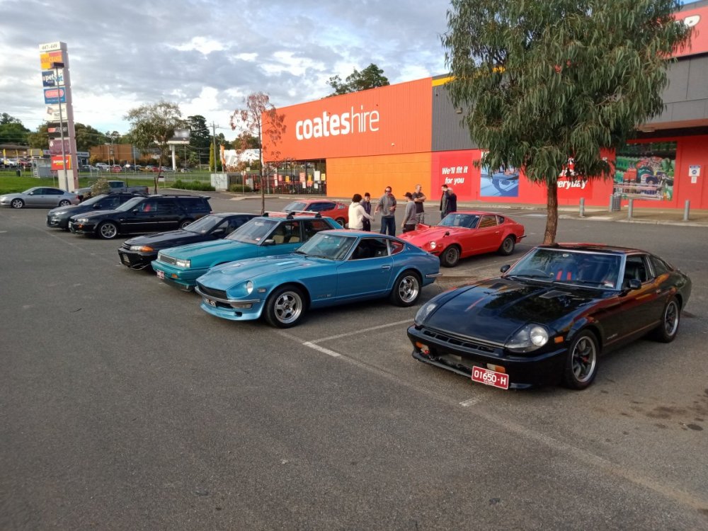

  3. What a good turnout. 9 cars and the weather was perfect. We saw lots of other car groups. Thanks to all the guys great chatting with you all at the Marysville Bakery.

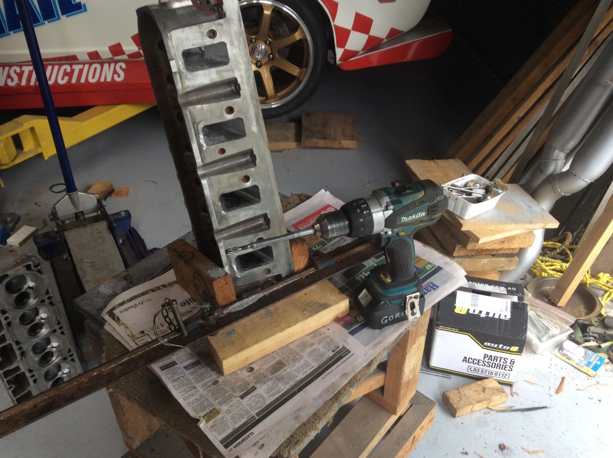

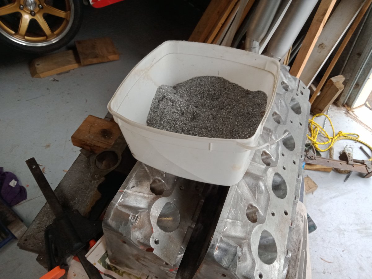

  8. Still working on the head's. All shaping is done. Spent a few hours on the exhaust ports with 80 then 120 grit, long way to go. Then the inlets. So much fun .NOT! removed some alloy.

  11. Still going on those heads. Finished the metal removal and shaping. Next will be the finished surface. Once I’ve finished my work on the heads I’ll send them to get resurfaced.

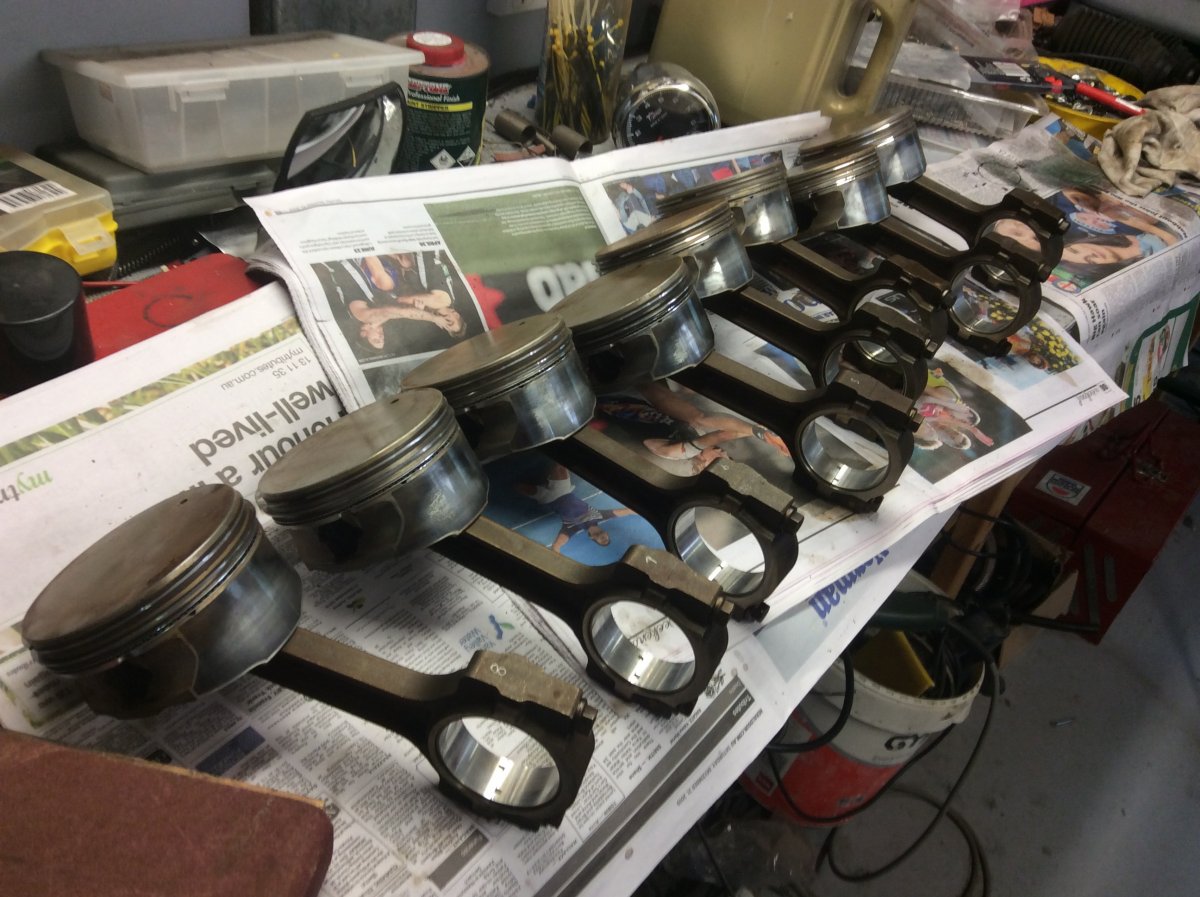

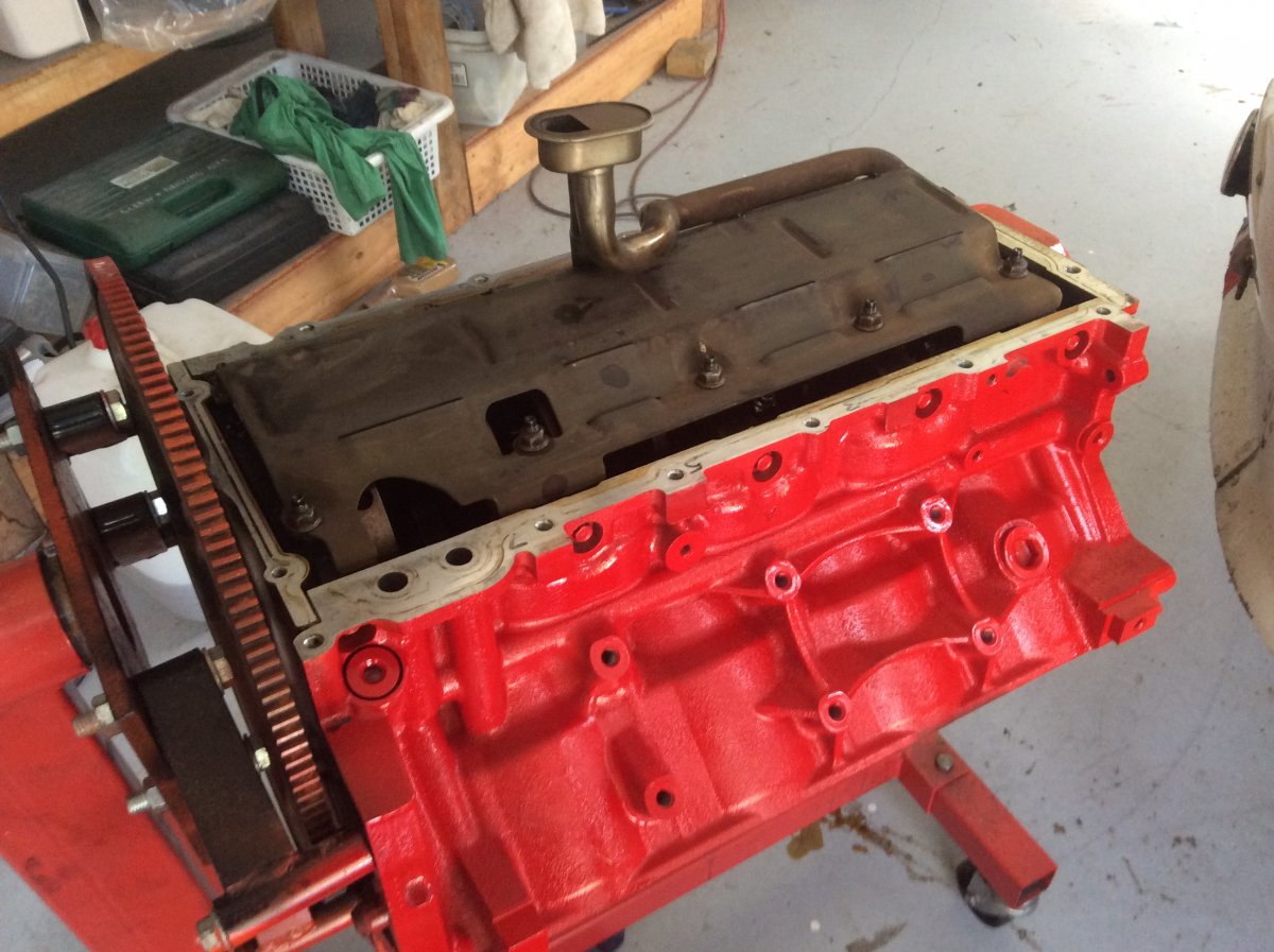

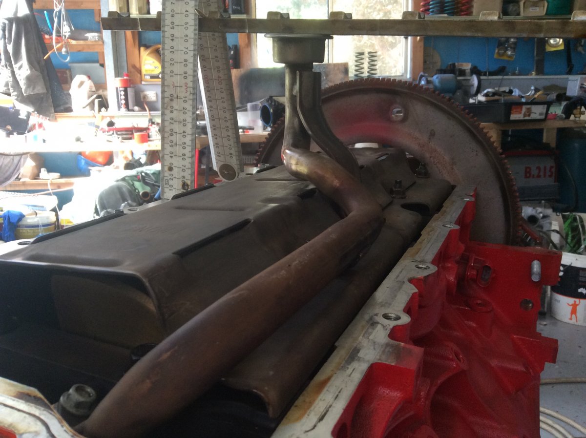

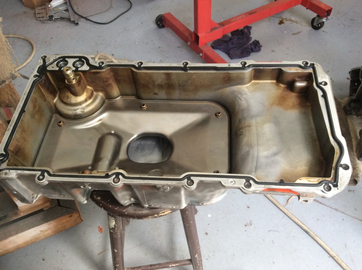

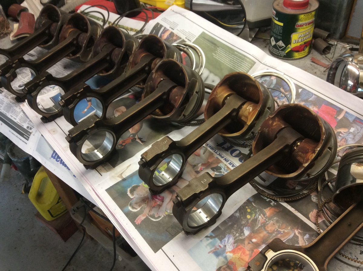

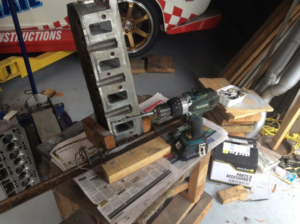

  12. I’ve been working on the heads, porting the intakes and matching the ports. Taking a lot longer than I thought. I’ve ordered some more Carbide burr tips. The Aluminium type cut through a lot quicker and take more material. So while waiting for the new tips I’ve started the rebuild on the bottom end. The pistons are back in, windage tray. I’ve had to adjust the length of the oil pick up to the new depth of the cut down sump. It’s going to hold 8 litres just touching the windage tray, plus the oil cooler and accumulator. I’ve marked the dip stick and recorded the depth per litres and a mark level with the windage tray.

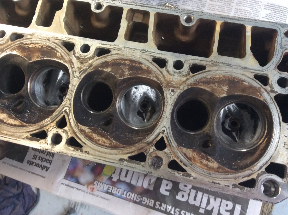

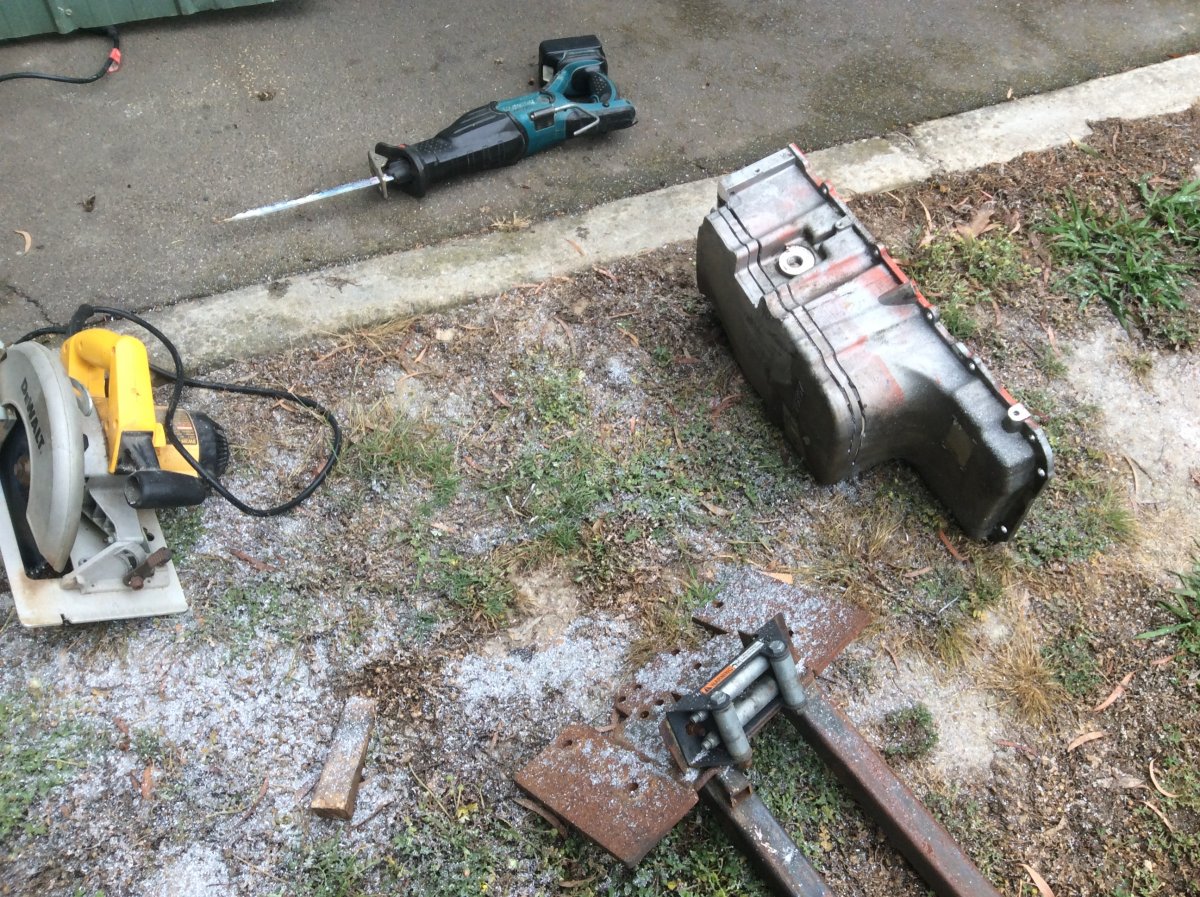

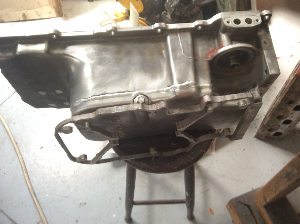

  13. Haha. The Chevy orange has already been taken care of. . There’s a fare bit of carbon build up on the pistons and in the heads. Got them soaking atm. The valve springs can be saved from the lower motor. Twin springs for bigger cam. the sump that’s come with the ls2 will fit and holds more litres than the other one. It’s a little deeper, to deep for ground clearance so I’ve taken a 20mm slice out and got my mate to re weld. Came up pretty good. Still 2 1/2 litres more oil. Total 7 1/2 lt

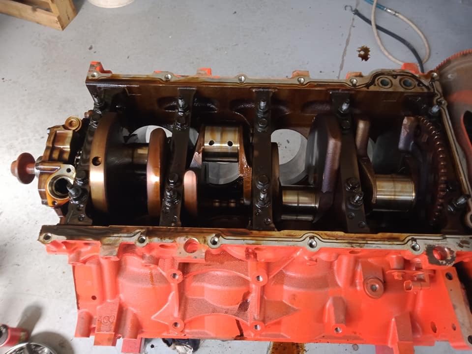

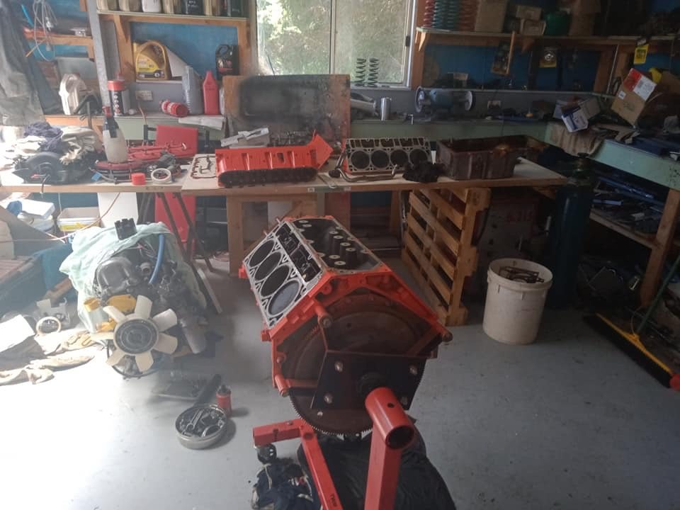

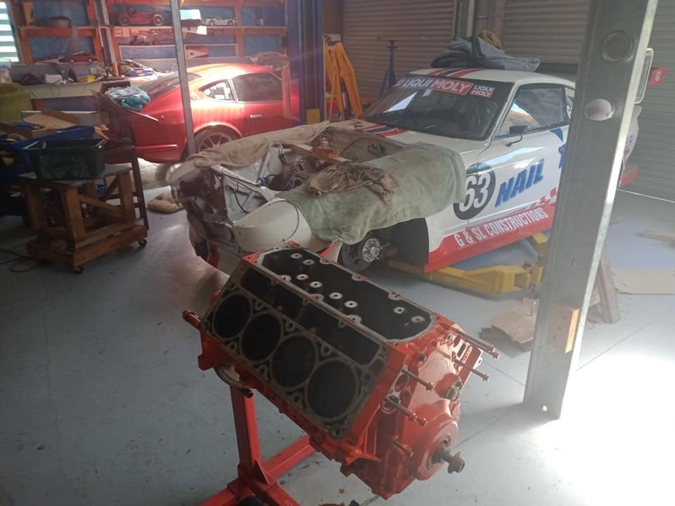

  14. Let the holidays begin. Two weeks in the cave. The path is well warn. But in the coming weeks it will get deeper. After a second hand motor was found at a ressemble price (ls2 6.0) The old motor was stripped down with not much to salvage. the second hand motor has been stripped. Lots of cleaning checking and sourcing some new parts.

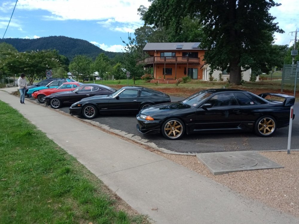

  18. Hey. Marysville arrival. https://photos.app.goo.gl/chdgqctUo25nVZVQ7

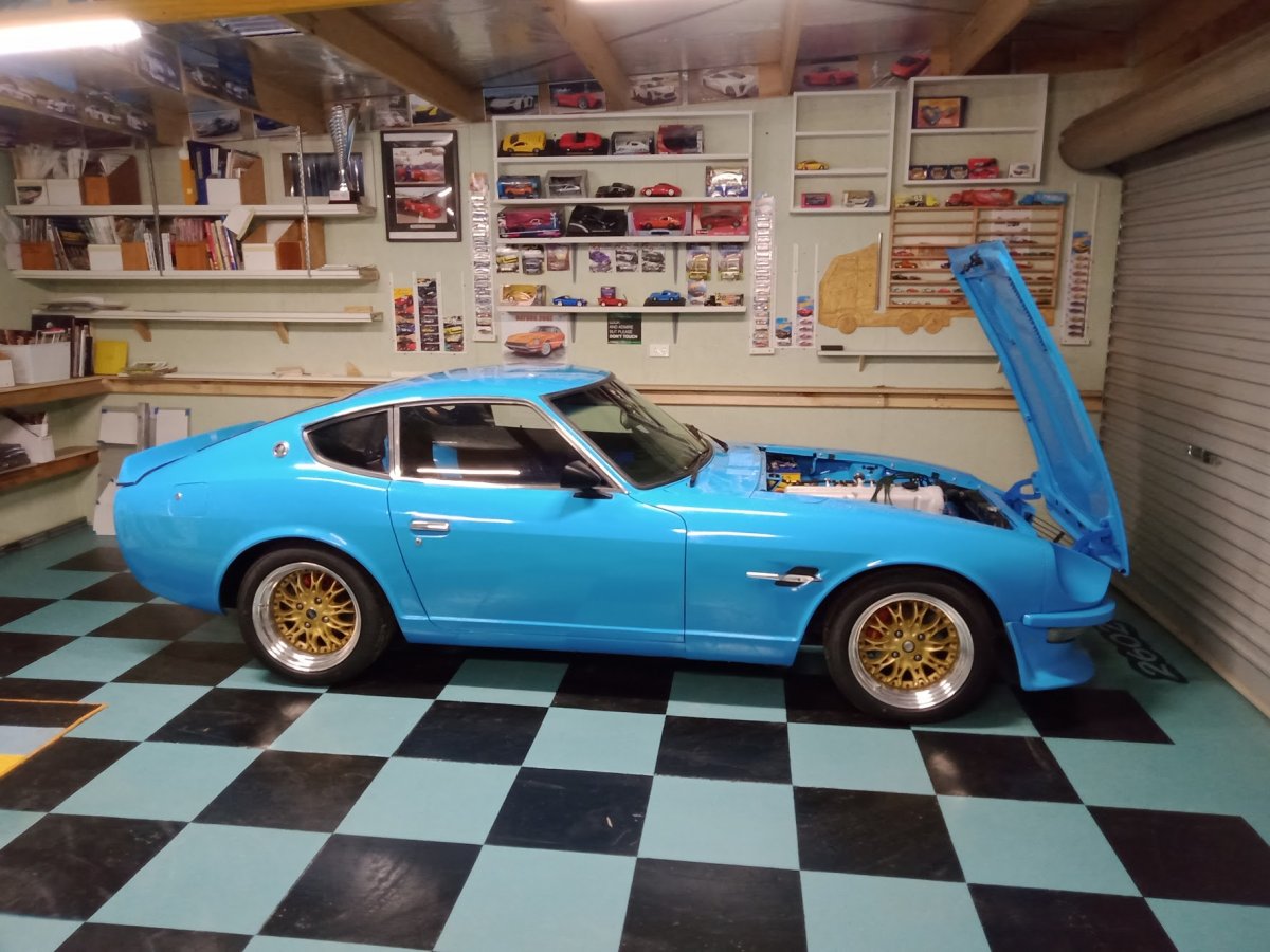

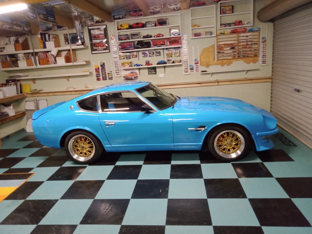

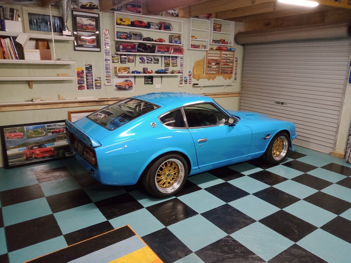

  21. Had a play with the blue zed today. Getting it cleaned up for the VicZed bbq on the 24th of November.
