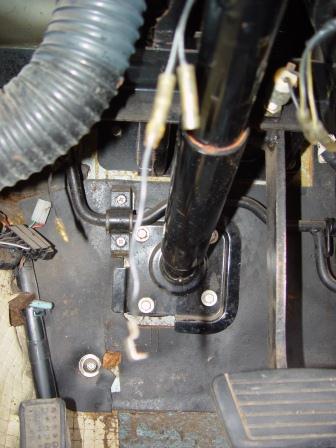

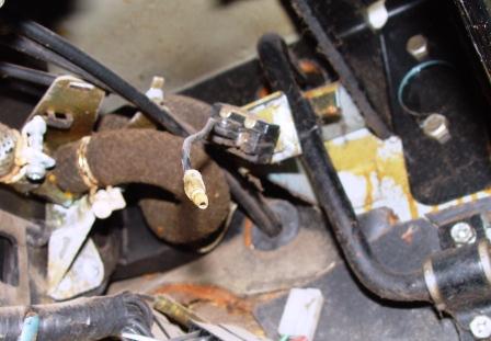

  18. It is indeed the kick down switch, however and for an unknown reason, the wires will not reach the switch. The strange looking connection was in fact part of the switch that had broken off. Maybe someone has wrapped the wires around something making them too short, but at this stage, I can't see where. If anyone has a spare switch from a wreck, please let me know.
  19. It looks like Green going into Black, however it is not long enough to connect one to the other. I will look in daylight and see if there is a terminal missing from the switch and if I can see any other connectors not going anywhere.
  20. So you're saying that the 3 wires and the switch should be connected ? I don't think they are long enough but will check in the morning and if it does look like that's where they go, I will try and reconnect them - assuming that I can get that strange connector on the back of the switch - if it isn't broken and hence the reason why it is hanging down. Yes, it is an auto, but I haven't driven it. There is a problem with one of the carbs and I can't get any power to the back 3 cylinders. That's yet another problem to sort out !
  21. I found these 3 wires today, not going anywhere. The second photo shows a wire coming from the switch behind it, and this is connected to the accelerator pedal. When the accelerator is pressed hard down, this switch clicks. Where is this wire supposed to go, and what is the purpose of it ? Wire set number two is in a similar location. As you can see, there are two of them. The one with the strange end on it is live with the ignition on. The other one is not. Again, I can't see where this goes, particularly with this strange terminal at the end. Sorry about the focus - the camera wanted to focus on what was behind it, but if you know the wires, you probably know what it's for.

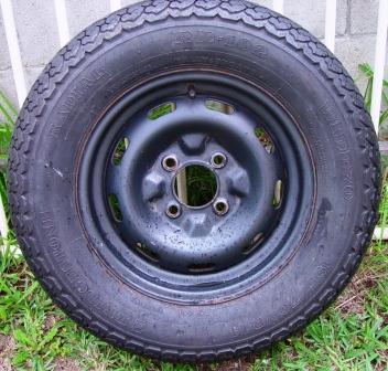

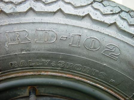

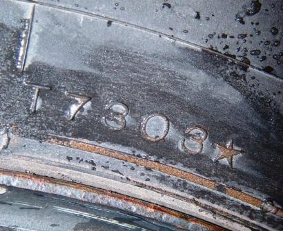

  22. I was having a clean out of the boot today and pulled out the spare wheel. If I am reading the date code correctly, this might just be a factory original. It is a Bridgestone RD-102 Wide 70, and the date code, I think, is T73-03 (March 1973 ?). My car is a '74, and only done 96,000 km so I guess it is possible. Anyone know what tyres were fitted originally and if I am reading the date code, or some other numbers ? While I was having a clean up, I also decided to remove the centre console to do some crack repairs, and noticed that the radio has a spare fuse attached to the power wire. Another factory touch ?

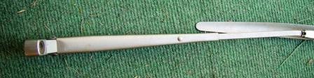

  23. I'm looking for a left hand wiper blade for my 260z. Same as the photos below. I have two right arms, and I presume that there should be a left and a right - probably with the left being a different length. Anybody got a spare ?
