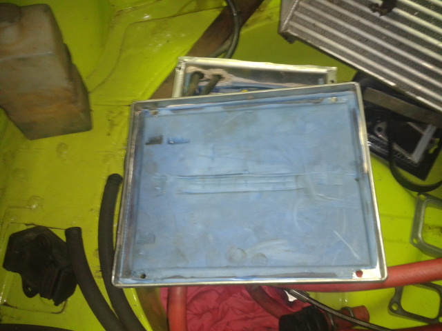

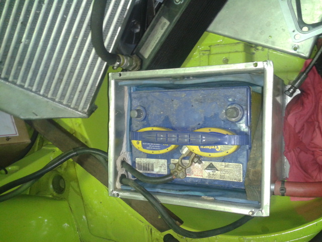

Scando Posted July 9, 2012 Posted July 9, 2012 Maybe some pics would help, so........ Show us ya box! You're so forward. I don't normally send people photos like this but......I guess as long as you promise not to show them to anyone else One shows inside the box and the other shows the underside of the lid so you can see how it seals. Quote
Scando Posted July 9, 2012 Posted July 9, 2012 Hey that looks very similar to my box. Reminds me of the scene out of knocked up where the obstetrician says "you do look like your sister" Quote

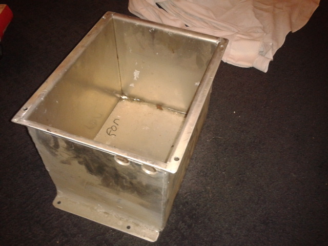

Scando Posted July 29, 2012 Posted July 29, 2012 Did you get this sorted? I found this while I was doing a big cleanout yesterday. I use a full size battery and it was 30mm to short but it would be fine for a smaller race type battery. It would need a lid made up. Let me know if you're interested. Quote
