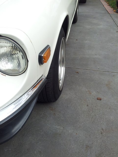

I now have 15x8 -3 on the front, I just haven't taken many photos of the car in the last couple of months because it looks a bit sad while it waits for it's new rear wheels:
20120509_144519.jpg?t=1336538820
Unnecessary front stretch will be changed when I get my new rears too.
