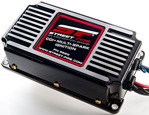

luvemfast Posted April 17, 2012 Posted April 17, 2012 Has anyone got any experience with these? Made by MSD, but clearly a cheaper division. http://www.street-fire.com/cdiignition.html http://www.street-fire.com/pdf/5520.pdf Pro's Half the price of the MSD 6AL-2 ($145 delivered vs $290) Has a rev limiter Con's Less volts (435V vs 535V) Is it Digital? (Does it matter?) Any other pro's & con's? Quote

d3c0y Posted April 18, 2012 Posted April 18, 2012 OK call me daft, but i just read the MSD site and: They all put out 530v and 135mJ (6AL-2 does 535v which i think is a bit of marketing) They are all controlled by a microprocessor (there's your "digital") They draw the same current So the main thing is that the 6AL-2 has two rev limiters and comes in a different box. To be honnest i doubt you could pick the difference between an AL-2 and an AL. Even the 6A has the same specs! The Street Fire CD, however is down a heap on spark - 435v and 95mJ (i think the mJ rating is more important than the volts - it's the energy of the spark). It's probably running cheaper MOSFET transistors if i had to take a guess which is also the bit that will most likely fail in the unit. So FWIW unless you require staged rev limits for your trans brake, i would probably buy a second hand 6AL and save myself the coin. Quote

luvemfast Posted April 18, 2012 Author Posted April 18, 2012 Found on MSD forum only the street fire line in made in china, except the 5520 box. which is made here in the states. So that backs up your theory about inferior internals Jake I'm after- Multi spark Higher power spark Rev limiter Digital So a 6AL (6425) will do the job. Quote
