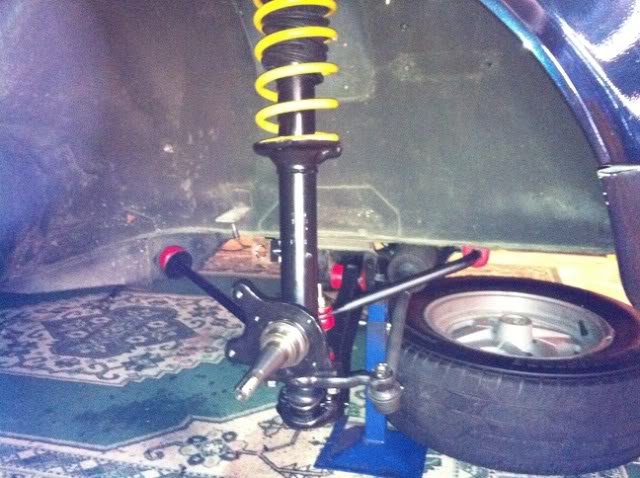

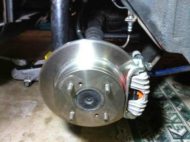

luke240ZED Posted February 21, 2012 Posted February 21, 2012 Hey Ash, Hope your well. All the goods are finally in and the brakes are sweet Pulls up extemely well now with the Hilux fronts and R31 rears and a reconditioned master. I was probably more impressed with the steering! With the new ball joints, tie rods and nolathane bushes, I have no shake at all in the front end. I thought it was the steering rack but now I would say it was the old stiff ball joints. Now, my XR700 ignition has just crapped itself after 10 years which is pretty good going in my opinion. So I am looking at buying another. Can you get a hold of these and if so, what price can you do? Cheers Luke p.s. a few pics of the final install Quote
