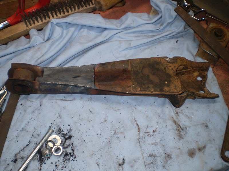

1600dave Posted January 31, 2012 Posted January 31, 2012 I just cut and welded mine, then added a plate on the bottom and plug-welded a small section of square tube inside the "U" (which you can just see on the inner end in the pic below) for a bit of re-inforcement. I also went withJason's idea of making it "not so obvious" - all painted up and with the welds smoothed off, you can't really tell that they've been modified. Another thing to consider (depending how much you lengthen them by) is that you may run out of adjustment on the tie-rods. If you get stuck, I have a lathe and the correct left hand threaded tap (cost me a small fortune even at mate's rates) to make longer ones. I could knock up a pair for you if you want. Ignore the bit about 20mm in the pic below, that's just how much longer I needed when I put 30mm into the LCA's. Also ignore that they don't look quite like 280ZX ones - I have cut off uneccessary brackets (eg swaybar mount) and removed a little of the LCA sheetmetal as I'll be running a custom adjustable sway bar. Quote
