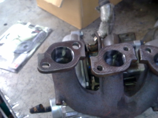

peter mc Posted November 7, 2011 Author Posted November 7, 2011 just a pick of the exhaust manifold and some goodies Quote

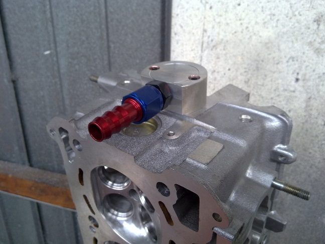

peter mc Posted November 7, 2011 Author Posted November 7, 2011 HI Tom We will be running a drain on the rear of the head as well as the mods to the block to get the oil back in the sump .i will show the oil mods this week as i do them Quote
Scando Posted November 7, 2011 Posted November 7, 2011 Hey Pete, is that the oil return fitting that Spool make for the back of the head? Good thing? Looking forward to seeing the oil mods. Quote
garvice Posted November 7, 2011 Posted November 7, 2011 Pete, One of the spare heads I picked up had a pressed in -10 fitting and I thought the bottom of the opening was a bit high to be real effective. Was considering welding a box around the welsh plug like this but a little less intrusive. What are your thoughts? Brad Quote

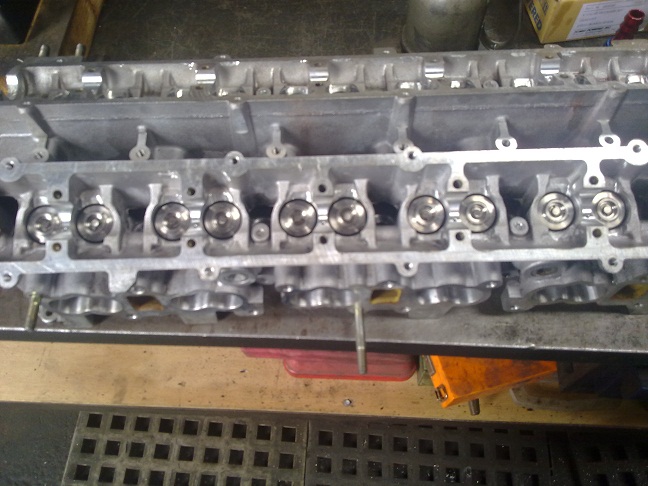

peter mc Posted November 7, 2011 Author Posted November 7, 2011 yep iv seen that more than once the kits you can buy all do the same thing but you should do the head and block first. the back of the 26 head needs some work to get the oil back in the sump will post some pics this week Quote

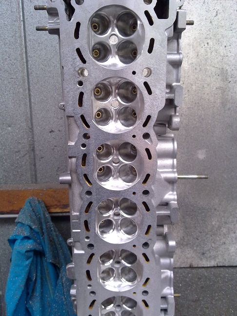

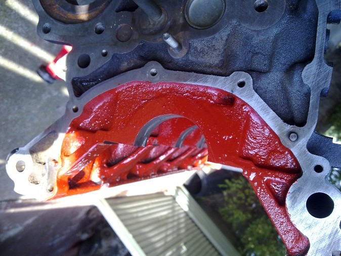

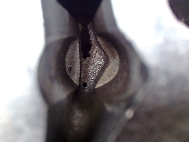

peter mc Posted November 8, 2011 Author Posted November 8, 2011 OK i got a pic of the factory oil return and how nasty they are and a pic off it cleaned up Quote

garvice Posted November 8, 2011 Posted November 8, 2011 Thanks for the pictures of the head Pete. I will have to take another look at the head on my bench. It looks like it was just the two drains at the rear of the head that you did. Quote
Scando Posted November 8, 2011 Posted November 8, 2011 Thanks for the pics Pete, I can see why they need tidying up with that pic of the factory return! Quote

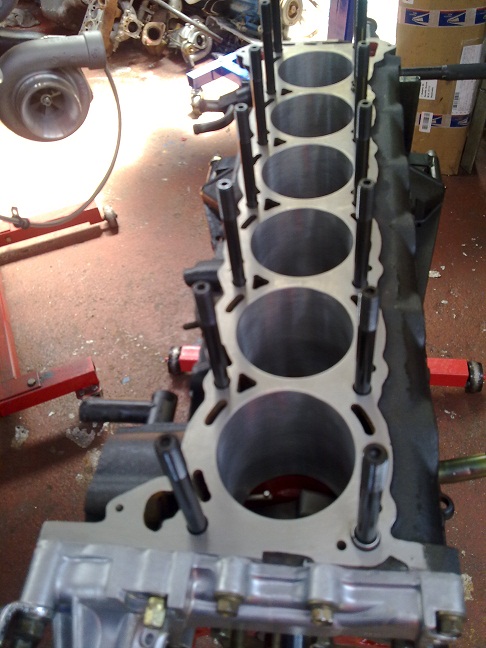

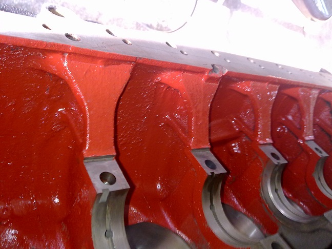

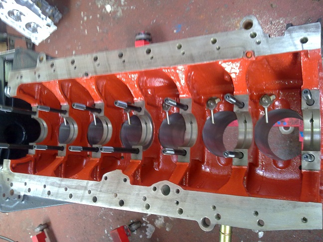

peter mc Posted November 16, 2011 Author Posted November 16, 2011 hi tom getting closer now all back from the shop now get it all together just got the first coat of paint on the inside done hears what it looks like Quote
handsandwhich Posted November 16, 2011 Posted November 16, 2011 This is starting to come together nicely. Can't wait to see/hear this thing on the dyno. Quote

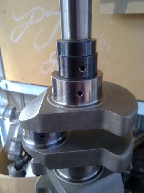

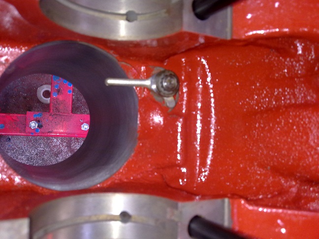

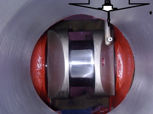

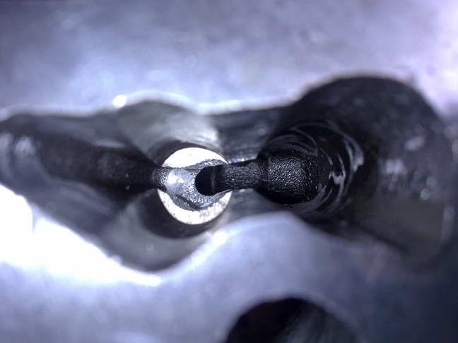

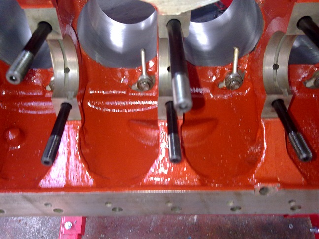

Riceburner Posted November 17, 2011 Posted November 17, 2011 What are those finger thingies in the bores, first pic Quote
peter mc Posted November 17, 2011 Author Posted November 17, 2011 hi Gareth there oil jets Rb26 have piston oil spray to cool the piston ... 2jz and many others do to ,most good turbo engines have them , Quote

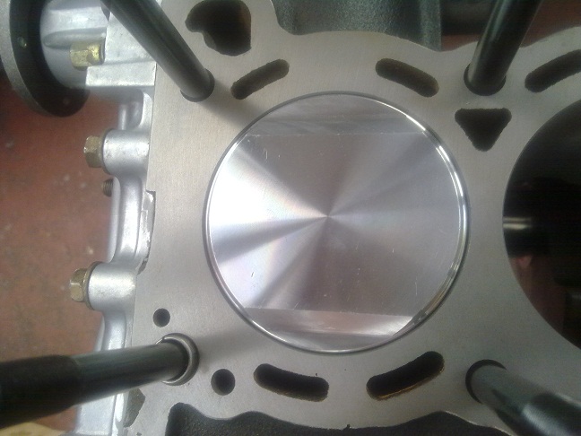

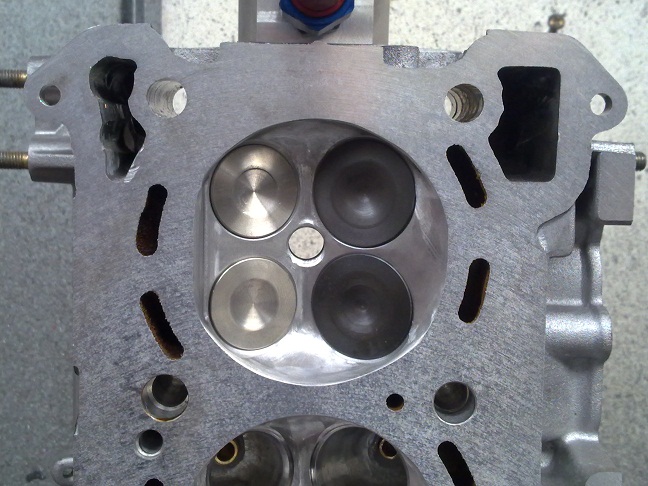

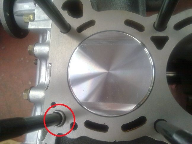

handsandwhich Posted November 18, 2011 Posted November 18, 2011 Looks great Pete. What is this I have circled? Quote
C.A.R. Posted November 18, 2011 Posted November 18, 2011 It's the cylinder head Dowel. Makes it easier to align the head onto the block & helps head-to-block stability. Quote

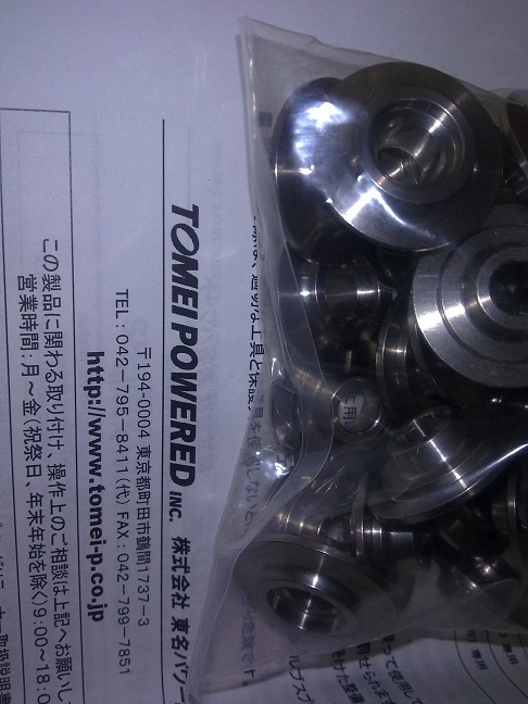

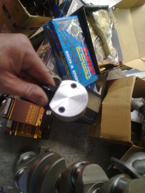

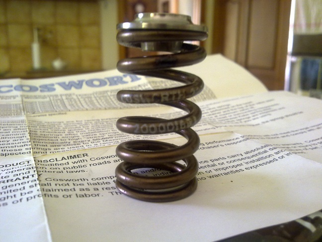

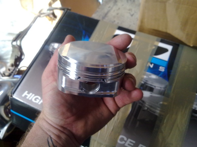

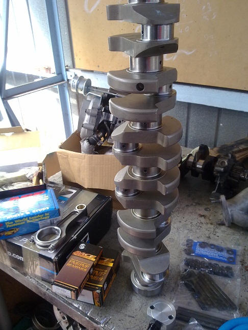

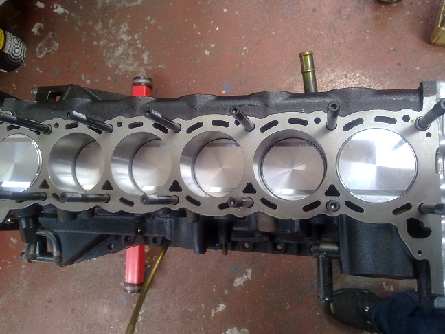

peter mc Posted November 21, 2011 Author Posted November 21, 2011 update time i have the short motor built . will start putting the head together tomorrow now all the parts are hear, the specs on the head have changed , it now has cosworth springs and ti valve retainers from tomei good for 10,000rpm and 35psi and the cam specs are now 11mm lift Quote
peter mc Posted November 21, 2011 Author Posted November 21, 2011 And the ATI 1000hp balancer and pulley is here now and the heads got all the valves in and ready to go Quote

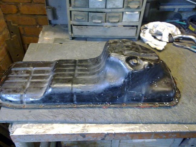

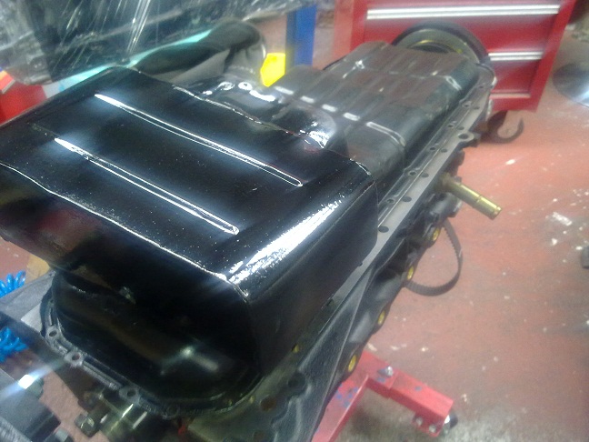

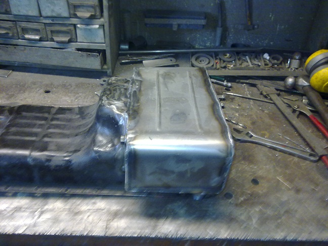

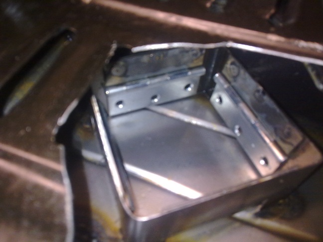

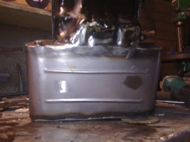

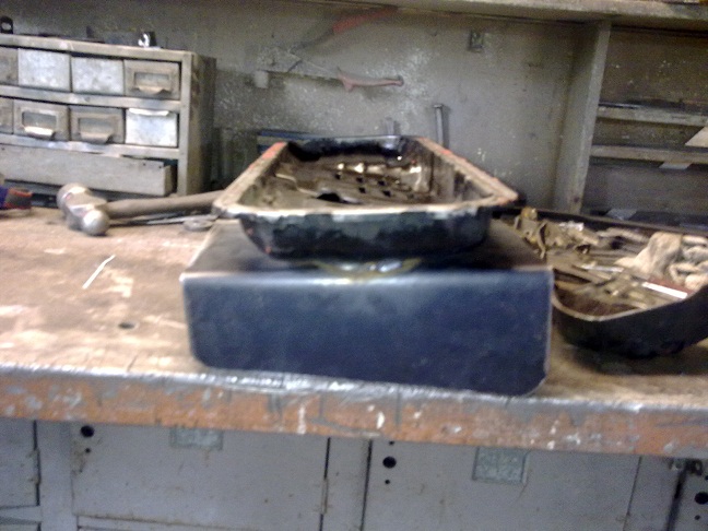

peter mc Posted November 30, 2011 Author Posted November 30, 2011 well bissy day in the shed ,started on the sump we got a on Monday ,we started with a Zr200 and iv added a extra 3L Quote
RB30X Posted November 30, 2011 Posted November 30, 2011 Door hinges, thats brilliant. I'm off to bunnings. Quote
