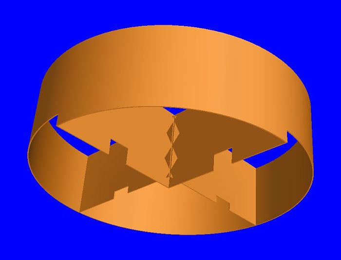

Sirpent Posted September 23, 2011 Posted September 23, 2011 OK So, I know this thread has been slightly hijacked and I apologise for that, however I did speak to a fabricator in my area today and based on the dimensions and what I explained I wanted, he gave me an indicative price of $450.00 for a tank built of 3mm aluminium all TIG welded. The basic design (Rudimentary as I didn't have time to do a more detailed one) would be along the lines of the attachment, Internall it would incorporate 2 cross plates forming internal baffles, each baffle would have lower and upper galleries allowing for fuel to circulate into each chamber, the tank would have one pie shaped area sitting 30mm lower than the other 3 chambers into which the remaining chambers would cascade fuel into creating a 2.4 litre pool or well. I spoke to Peter Mc on the phone quickly and his thoughts are that this pool would be deep enough for an internal pump pick up point, therefore an internal pump running 50+ psi would be required, this would not be included in the price of the tank as wouldn't the inductive (Non Float) sender unit. However the price would include the neck and all associated piping for return and vapours lines etc. I will meet up with Stephen from Grenenger who I spoke to and see what the final price will be and report back. Cheers John Quote

Sirpent Posted October 1, 2011 Posted October 1, 2011 Hi Guys, Alan spot on, I wouldn't have it built without sign off, but I don't think that the complexity of this design will create to many drama;s either, so I will get onto it tomorrow and get a price (Been away 8 days) and at least it may give some pp, an alternative. The only production tank I can think of that may allow the well to be cut out and act as a tank and wheel well in one would be the old XA-XC tank's, but their size would be a major problem, in order to get the capacity they extend a fair way out around the tyre and I don't think the rails beneath the Z floor would allow it t fit, then again, you neverknow, anyone got one sitting around that could be measured up? Quote

Sirpent Posted October 6, 2011 Posted October 6, 2011 OK, Stephen the fabricator got back to me on the price of the wheel well tank, with all required fittings mounts fuel filler and return lines etc, he can do it for $475.00 So I will be going down this track now, I will have mine built and if anyone is interested down the track after the item is finished, I will pass on his details. Cheers John Quote
