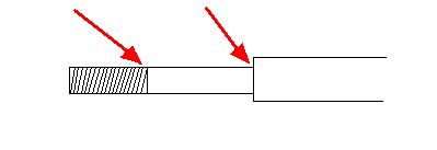

DAZDA Posted September 13, 2011 Posted September 13, 2011 ... and had the right hand T/C rod snap at the bush. Whittie, did it snap at the end of the threaded section or at the step where the larger washers sit? P.S. MS Paint for teh win Quote
Whittie Posted September 14, 2011 Posted September 14, 2011 Snapped at the front, at the step you've indicated. almost had the wheel collapse under the car. Quote

handsandwhich Posted October 26, 2011 Posted October 26, 2011 My rod is thicker than standard The rods that are on my car do not have the step down like in the drawing that DAZDA posted and are 17mm thick the whole way through so they limit the stress point where they normally can break. I have got one of those t/c bush kits like the one below, but since it won't fit over my large rod, I am willing to let them go if someone wants them for $25 + postage. http://www.ebay.com.au/itm/170700782324?ssPageName=STRK:MEWNX:IT&_trksid=p3984.m1439.l2649 Quote

handsandwhich Posted October 26, 2011 Posted October 26, 2011 Haha! I did wonder if you were asking me. I did tell a lie. The ones I have do have the step down, but the threaded section is 17mm diam and the rod is 20mm diam. So a lot more "meat" there and gives a little adjustability with the longer threaded section? Quote
