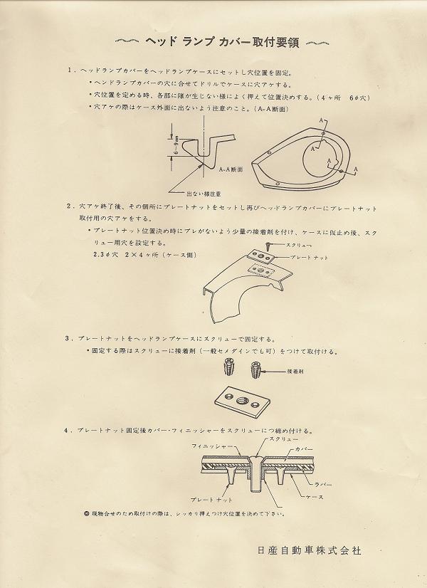

Riceburner Posted August 16, 2011 Posted August 16, 2011 Hi guys, I have just received the new Gnose and I'd like to know the correct way to fit the headlight covers. They have the mounting hardware with them which consists of screws and backing plates. Do these plates go on the underside of the Fibreglass or on the top side? Quote

Moderators Zedman240® Posted August 16, 2011 Moderators Posted August 16, 2011 Gareth, if you want to mount them an easier way, I have the stainless nutserts and correct stainless screws that match the originals if you want... I mounted mine with the original hardware.. first you need to mark the holes on the headlight bucket where the large screws go then screw those small rectangular plates with the countersunk self drillers but first drill a 6mm hole for the main screws to go through. I pre-drilled a small hole for the self tappers anyway. Wait, I'll scan the instructions for you...they are for the "regular" covers but I think they are the same.. Quote
Riceburner Posted August 16, 2011 Author Posted August 16, 2011 I might take you up on the nutsert offer mate. That diagram will help too, thanks Quote
