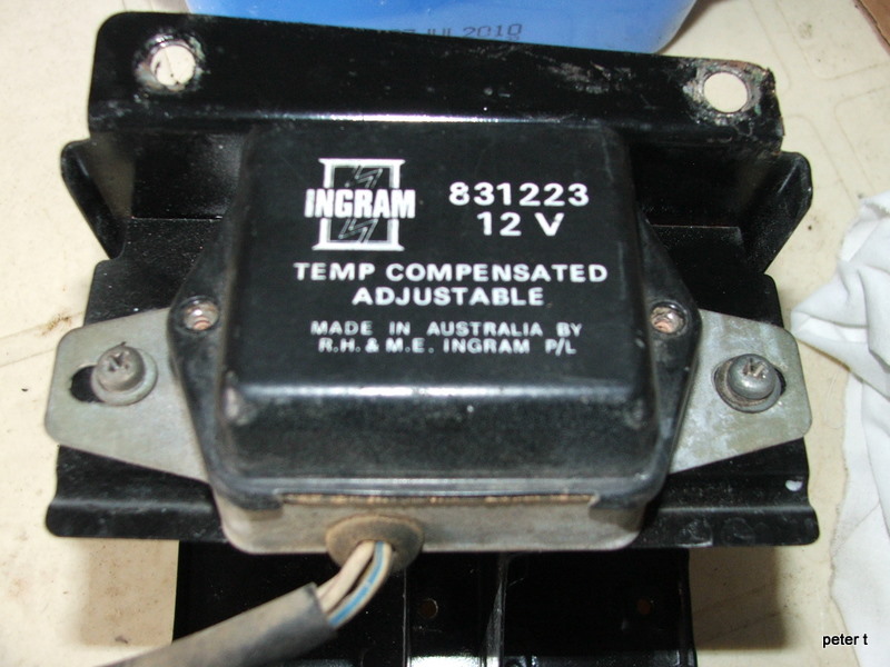

peter t Posted April 23, 2011 Author Posted April 23, 2011 Does anyone know what this is. It is located on the relay mount under bonnet. Quote
benny Posted April 23, 2011 Posted April 23, 2011 dont mean to state the obvious peter... but im pretty sure what you've got there is a flux capacitor?? otherwise known as your external voltage regulator Quote
peter t Posted April 23, 2011 Author Posted April 23, 2011 Thanks Benny, it just didn,t look like what I am use to or what is in the book. Quote
benny Posted April 23, 2011 Posted April 23, 2011 i dont think that its the original but it is a suitable replacement item!! If its stuffed here are some from the MSA site- http://www.thezstore.com/page/TZS/CTGY/SEIC03C Quote
