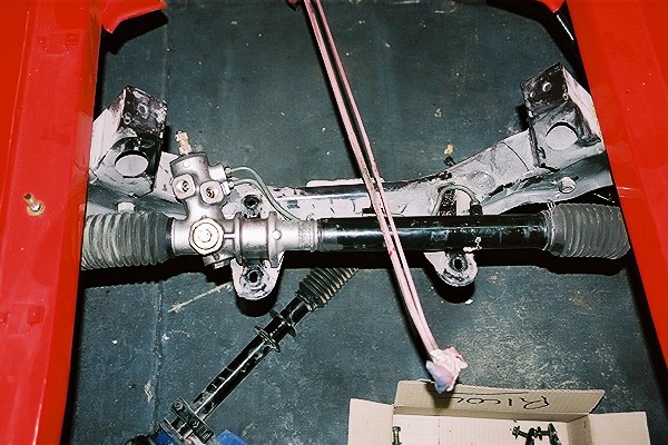

Sooley Posted February 1, 2007 Posted February 1, 2007 I have converted my car to Powersteer by using the early model MX5 P/Steer Rack and Nissan N13 Pulsar Tie Rod ends. You will need to cut and re thread the rack end and notch out a little bit of the cross member also for it to sit neatly. Overall this is a very easy mod and will I am sure make a big difference. Another point is that it may help with the bump steer problem also as you will have longer rack arms and should be able to get more travel out of the tie rod ends. Here is a pic Sooley Quote
tattoo_ink Posted February 1, 2007 Posted February 1, 2007 awsome thanks for that ! im on a mission now ! i didnt realy want to chop up the cross member to much so thats sounds like a plan ! thanks again ! chris. Quote

sco_aus Posted February 8, 2007 Posted February 8, 2007 Ok, well I have done a bit of looking around. I have found a place called www.mx5mania.com.au . I emailed them and they can supply a power steering rack from a NA model 1.6L MX5 for $250. N13 Tie rod ends are about $15 each from repco. I would be using a RB25 power steering pump which I could probably get for about $150. But there is something Im not sure about, how does the steering column go when connecting to the rack? Quote
Sooley Posted February 8, 2007 Author Posted February 8, 2007 Great work The Steering arm is on a universal so it will work just fine. You will have to notch out the cross member a little but it will fit great. Use Poly bushes and that will firm up the front end too. They also make a Poly steering arm bush that helps too. Sooley Quote

sco_aus Posted February 16, 2007 Posted February 16, 2007 Cos you have to do this to fit a subi rack, insted of a couple of small notches. Well this is my take on it all anway, im not saying im right, just what seems to be right. http://www.viczcar.com/forums/files/imgp0646_643.jpg Quote

nat0_240_chevZ Posted February 16, 2007 Posted February 16, 2007 the fellow here, i believe hes registered on this forum RBZ_260? believe it was slot and reinforce the engine stand/pedestal, and heat and bash some clearance on pass side, also i think he said a custom drivers side rack mount bush. Also rotating one half of the rack helps with lines location etc. hope he chimes in here, nato Quote
RBZ 260 Posted March 9, 2007 Posted March 9, 2007 im here. yeah wha t nato said pretty much. i wasn a fan of cutting chuncks out of the cross member or drilling massive holes. bit lazy to post a pic but here is a ling from the other forum http://www.thezgarage.com/forum/viewtopic.php?t=601 all i did is made few dents using oxy set and big hammer. rotated the power head 180deg and new pipes bent up. sloted the rhs engine bracket and reinforced fromt the inside. just under 3 turns from lock to lock. though looking at he mx5 looks bit easier. but mazda parts a xpensive. i got my rebuild subi for $180 with the mods to the pipes. Quote
