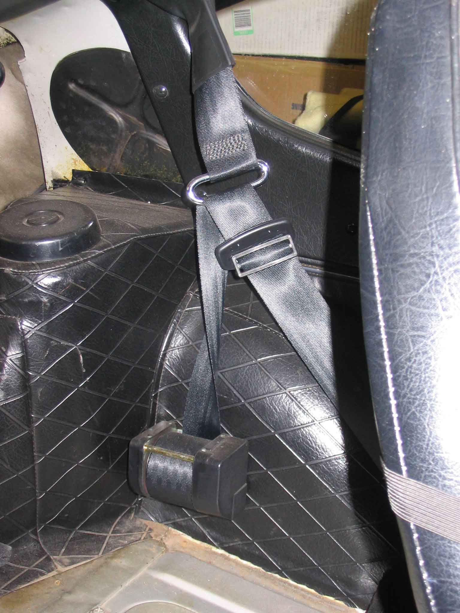

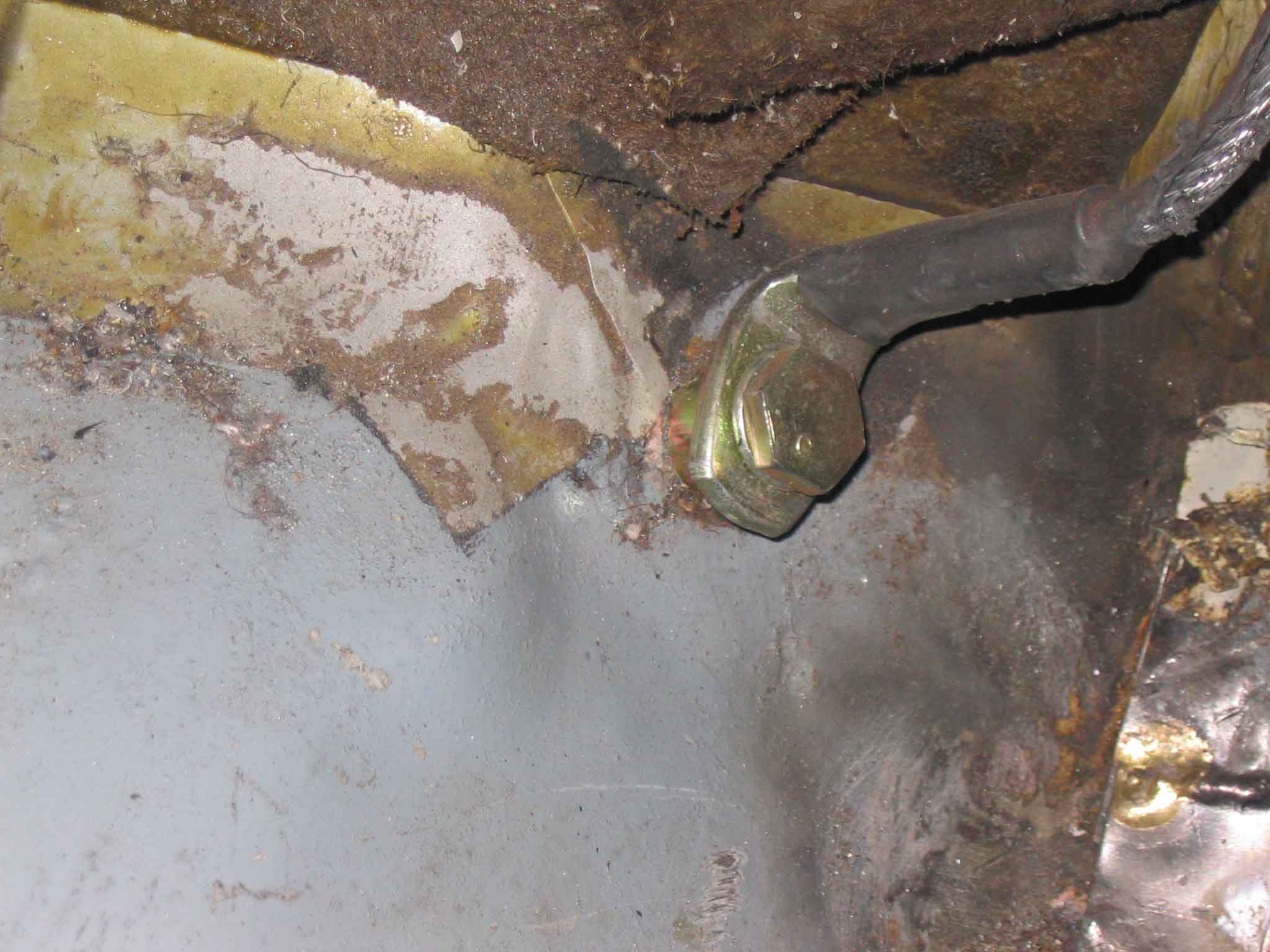

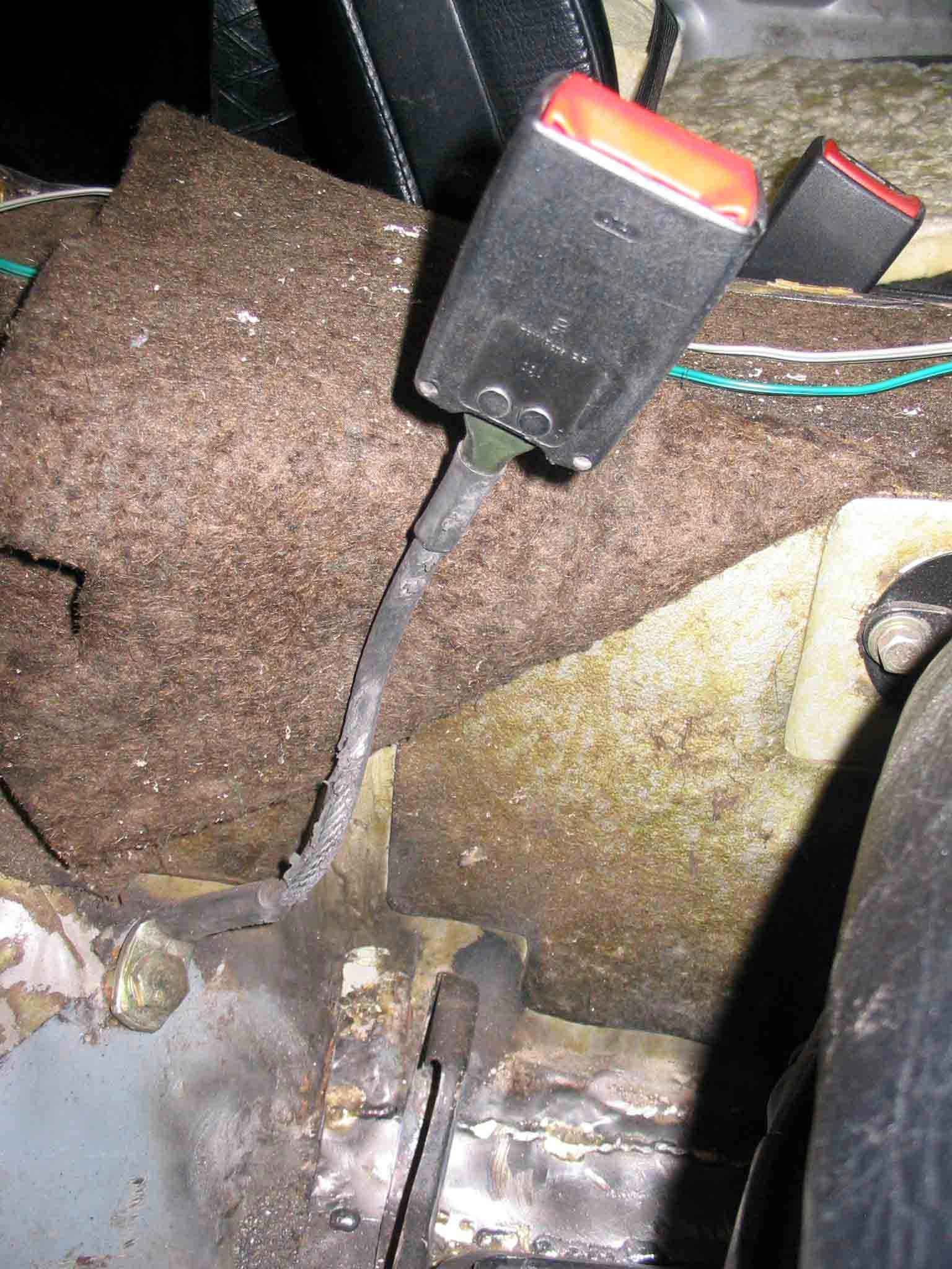

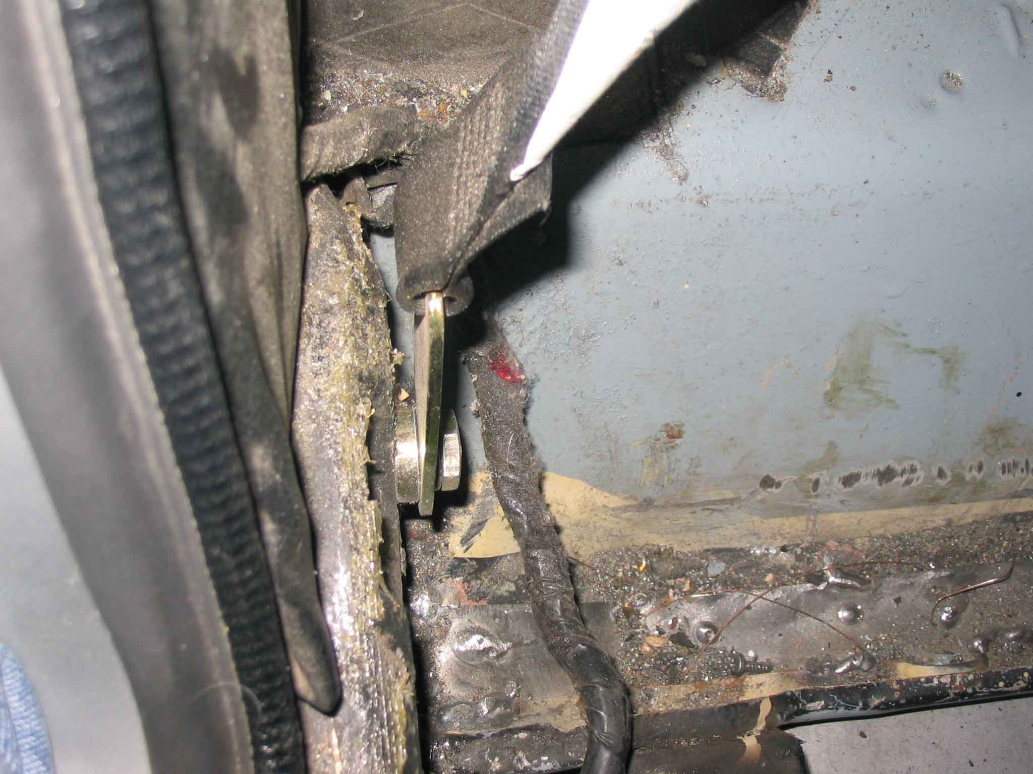

warrenz Posted March 15, 2006 Posted March 15, 2006 Hi Matt asked for pics regarding how I mounted the inertia reel belts. Since I cannot upload photo's (a question for Gav in other forum) I will post them here. Part 1 Cheers Warren Quote
matt drago Posted March 15, 2006 Posted March 15, 2006 Hey Warren, Thank you very much for the photos, exactly what I wanted to see. The installation looks neat and I think I like the idea of mounting the real to the wheel arch rather than building a bracket for the top of the strut tower. Cheers, Matt Quote
Toecutter Posted March 15, 2006 Author Posted March 15, 2006 Yer nice Warren, hmmm...nice and neat, leaves room for a half cage to mount to the top of the strutt housing. Quote
