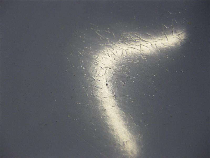

Is what you are referring to look like crows feet as per this pic?
John

The crows feet photo isn't what mine looks like. Imagine a satelite photo of a flooded river flowing to a delta, lots of inter laced streams which go no where and start somewhere, but combine to form an image of organisted chaos.

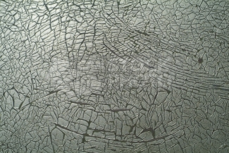

I found this EXTREME pic on the web, is this more in line with what you are referring to?
John

John, your extreme photo is exactly what it looks like, so I'm happy to start with the "cleansheet" approach recommended.
Really appreciate your input.
