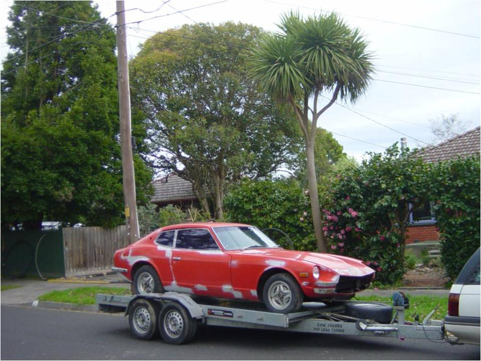

After my short flirtation with the blue 2 seater, I thought I should give the story of my 2+2. I found it in a field in Kilsyth.... got it cheap...
THE GOOD
The colour, with blue tint windows (which I kinda like)
The interior - mostly complete and in good nick - one tear in the drivers seat and the top of the back seat gone. Torn head liner. No signs of water.
113 000 original k's with matching numbers engine
Factory aircon
THE BAD
The engine - blown head gasket - on break down, every internal bolt was finger tight, including those securing the head.
The wiring - messed with, stuffed with and added to.
One rusty dog leg
It's an auto. I hate autos.
THE UGLY
House primer on some of the rust spots (nice)

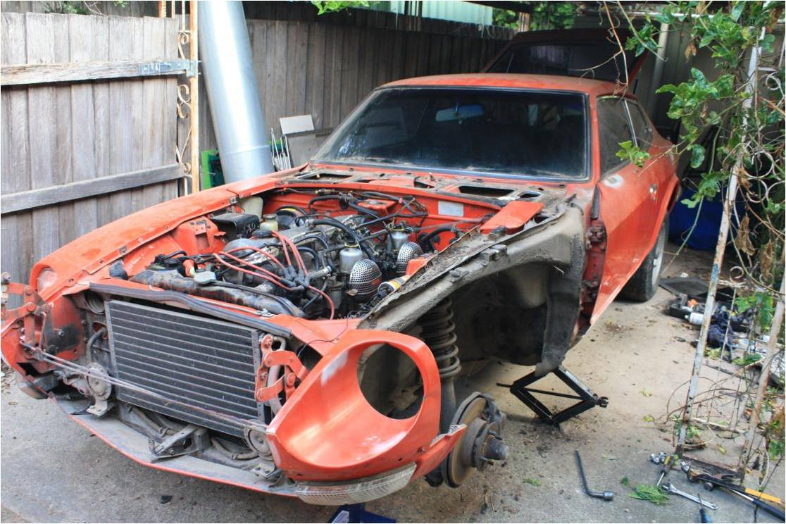

The car has been nosed under something - gouging the bonnet
I will put a few posts in to get up to speed with where I am now

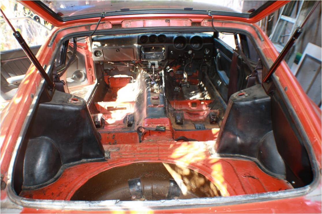

I stripped the interior out and found .... nothing. A well patched small rust hole in the drivers side. Everything looks very clean. No sign of rust in the tyre well.
I lifted her up and had a look underneath and found .... nothing. Chassis rails are very sound, floor pan looks good throughout.
Looked in all the other spots... no rust in the firewall. Pulled the guards off... no rust evident. A single bubble beside the glass on the hatch. Nothing in the support for the radiator.
In short, a very sound shell and a very viable project.

So this is where I am at now (7/2/11) ...
Have stripped out the interior and rewired the car. Added a sports steering wheel.
Sourced a replacement bonnet with vents - didn't like it - and have sourced another one from the blue 2 seater I bought. Found two new doors to replace mine which were pretty rusty inside.
Rustproofed behind the guards and over the transmission tunnel.
Bought a front air dam (Alfa Motorsports), new wheels and a duck tail. Bought 260z side strips from the US, with an extra one to lengthen them to fit the 2+2 body. Bought all new badges (from Kuwait!!).
Sourced a replacement L26 from Shan's car. Recon'd (new rings, pistons, seals) although it actually looked good - have installed the air con onto that.
Sourced the parts for the 5spd conversion (5spd box, pedal box from NZ, new master and slave clutch cylinders). Installed the 5spd on the new engine.
Nest steps...
Prep and paint engine bay.
Install engine and convert to 5spd (with Benny's help)
Trailor to Lurch for dog leg repair.
Prep all panels for paint

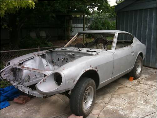

NEW PLAN.
Just bought a 240Z engine and shell and will be swapping my 260Z's bits and pieces into that. Sorry fellow bus owners, I feel like a bit of a traitor but going to recent club events had given me terrible 2 seater envy.
I think you all saw this on eBay so we won't even talk (especially to my wife) about what I paid for a bare shell......
Wooo hooo... the car I have wanted since I was 8 years old!!!
R.
well done. I have seen this shell first hand and i was one of the 2 guys that talked him out of chopping it up for parts.. Its a good honest shell with nothing to hide It has a few rusty bits but nothing major :) good luck mate  ;D
Thanks for convincing him mate.... I reckon I'm happier with the shell 'naked' like it is... it looks pretty rough but there's nothing hidden... I've seen many worse shells hidden under very pretty paint jobs... and that is a real shit to deal with......
Nice work Ross! Looking forward to seeing what happens with this one. Nothing quite like getting a blank canvas...
