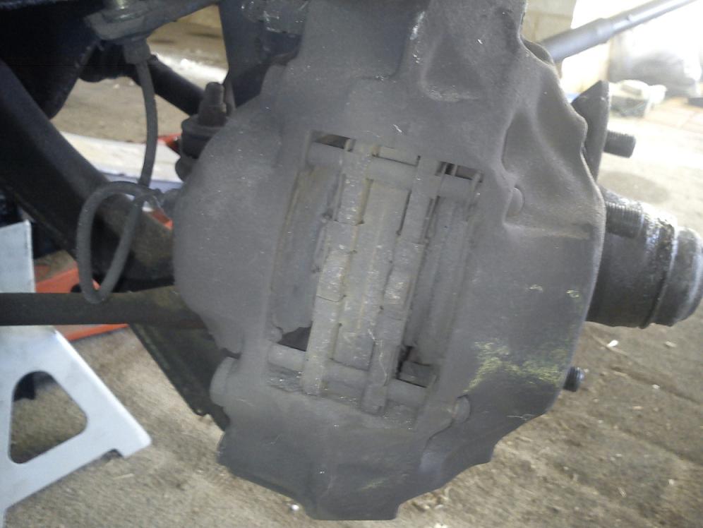

neRok Posted March 19, 2011 Author Posted March 19, 2011 update time pulled the wheel cylinder apart and cleaned everything. it all looked good condition, except the dust seal was a bit ratty, but meh. put it all back together, bled it, seems to be holding up good. so i was done with the rear, went to stand up and touched something in my hand, it was a spring that goes on the end of the piston to stop it bottoming out i guess. doh. ive left it for now, if it fails ill fix it then. moved on to the fronts to replace my pads. think i worked out why i didnt have good breaking before. there was so little pad left that the retainer clips were actually hitting each other! crazy, see the pic. new pads in, bled it up good, now it actually stops properly. so the big master cylinder does work. the pedal is pretty hard, but i have felt clutch pedals harder, so its all good imo. saying that though, you do have to push pretty hard, so here is hoping i dont put my foot through the firewall haha. also, its not the greatest for slowly braking, but it stops quick when you need to. so now this problem is over, i can work out why my car is slow Quote
