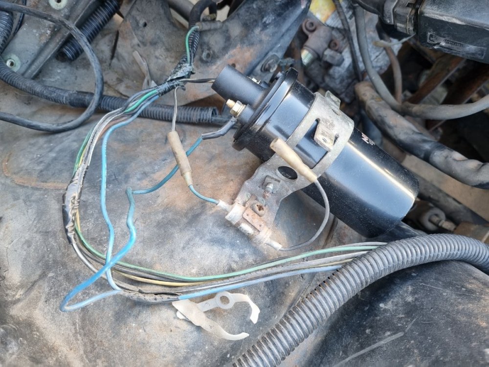

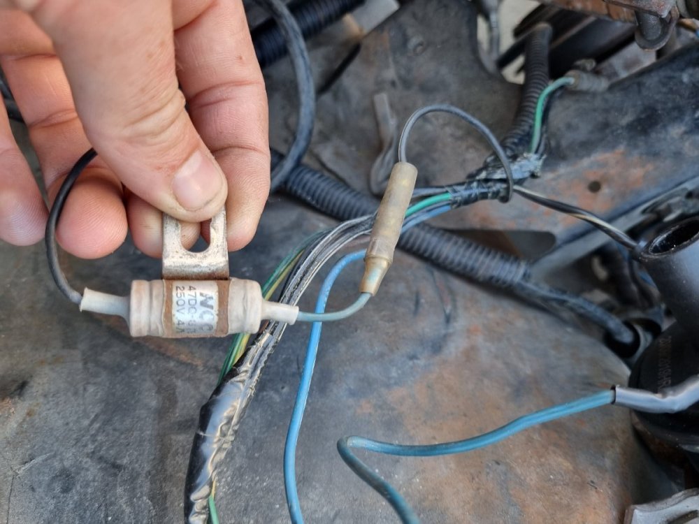

JDM280ZX Posted April 15, 2022 Posted April 15, 2022 (edited) Coil is receiving 12.4V (same as battery voltage) when ignition is on so would've thought this means no ballast resistor. However have found this that bolts onto the coil bracket and has a power lead to it from the same wire as the coil +12V source. Unsure on where the other end of it goes to though. Edited April 15, 2022 by JDM280ZX gav240z 1 Quote
Administrators gav240z Posted April 16, 2022 Author Administrators Posted April 16, 2022 I'm not 100% sure, but I think that may be a condenser used to help control static and cancel out electrical noise in things like the radio. https://www.chevelles.com/threads/ignition-condenser-what-it-is.332062/ Quote On some cars (like my '65 with factory a/c and am/fm radio), there was another condenser mounted on the coil, positive side, I think, that was also used to control radio interference generated by the ignition system.... I am not 100% sure however and happy to be corrected on this. Quote

JDM280ZX Posted April 16, 2022 Posted April 16, 2022 Just now, gav240z said: I'm not 100% sure, but I think that may be a condenser used to help control static and cancel out electrical noise in things like the radio. https://www.chevelles.com/threads/ignition-condenser-what-it-is.332062/ I am not 100% sure however and happy to be corrected on this. Yeah I was thinking the same thing too, after further research today it seems to be a condenser and not related to the issues I'm currently having. Bugger back to the drawing board. Hoping its something to do with the coil, been doing some research into the one I was sold and cant seem to find if it is designed to be used with an external resistor or not. Car won't even attempt to fire. Pulled a plug out and earthed it to the engine then turned car over and was visibly very weak. I bought the car as an abandoned project with everything completely stripped from the engine bay, with there not being too many 2.0L 280zx cars I can't find much info if I've set it up right. gav240z 1 Quote
