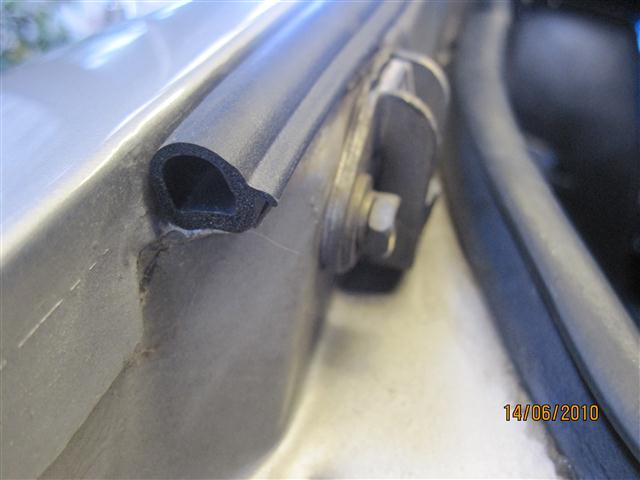

pictures speak a 1000 words...
these are my OEM rubbers.. for the "oval" shaped one (next to the main hatch rubber) I just used a good quality silicon.
The flattish one goes on the underside of the hatch (mines still the factory original) and the round/oval one goes on the body..
The perimeter seal to the right was also replaced.
Thats excellent detail Chris ... thanks.

From what i have seen on all the diagrams, on the 240Z, there are three rubber parts;
1) the inner hatch seal - looks like Darrel Lea Licorice and feels just like that too might I add... It fits on the main body cavity. I bought this part OEM.

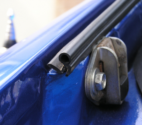

2) the outer hatch seal - being in three parts, one on the the top, that wraps around the top of the outside of the opening, and two additional pieces that fit onto the outside side rails ... and these look ROUND like the photo you have included. Just to add some more confusion on this matter, I have added a photo of a japanese guy with a seriously seriously 100% OEM 240z that I have been using as a reference .. and his outside rear hatch seal rubbers are a mildly different profile to those in your photos (as I say, just to throw a spanner in at this point), and
3) you're telling me there is an actual rubber seal that is fixed (by what means?) to that actual hatch panel itself. Are you able to send another photo, or show me where in the parts diagram this part fits? Is it glued? or does it fit into a cavity? Is this the elusive 'L' piece that I am in possession of, but do not know where it goes?

Woops sorry Adam ...I confussed myself.. :P

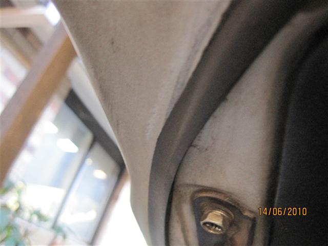

The under hatch rubber is NOT factory...I installed it myself to help eliminate possible fumes and its worked a treat..very observant  8)
its basically 10-12mm wide semi rigid foam thats came sticky on one side...I'd like to think you can buy it from bunnings, but I cant recall where i got it from.
hmmmm your right about the outer seal, quite different....I suspect the picture above is "more" OEM than mine...most importantly they both do the same job.
