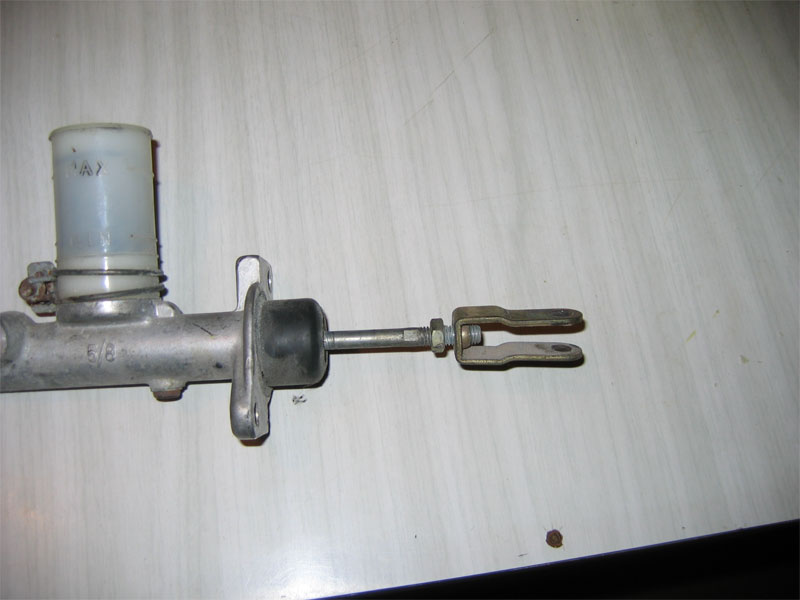

the rubber thing that your pedal hits when released is the stop - thats what it does, its adjustable so you can get the pedal height correct.
The adjustment should be, as Nat said, on the pushrod itself. I took a photo of a 280zx clutch master I have in my garage which should help you see whats going on before you stick your head under the dash again. As you can see, the forked part that attaches to the pedal is threaded, and there is a locknut behind it to stop the pushrod rotating during use and adjusting itself. Back the locknut off, and you should be able to rotate the pushrod with your fingers.
