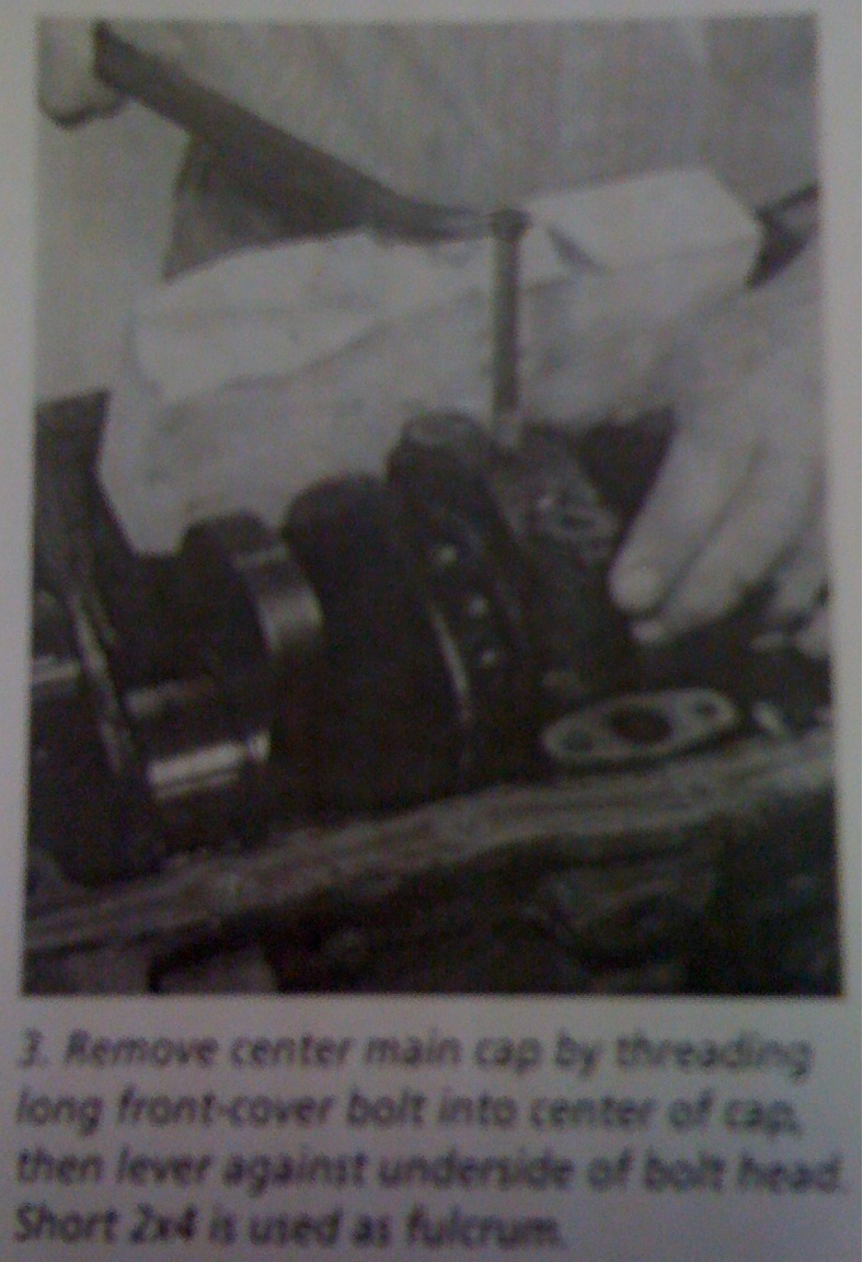

RB30X Posted May 26, 2010 Posted May 26, 2010 Just stripping the crank out of an L28 block and was wondering how you get the centre crank cap out? ('centre' meaning in between 3 & 4 pot) The others come out easy because there is clearance either side from the rotating weights/rod bearing, but the centre cap is boxed in no matter where the crank sits. And obvioulsy once the centre cap comes out the rear main cap is next on the list. Is there a trick to getting that one off as well. Cheers Tim Quote
stevo_gj Posted May 26, 2010 Posted May 26, 2010 You need to get "How to rebuild your Nissan Datsun OHC Engine! Quote
RB30X Posted May 26, 2010 Author Posted May 26, 2010 Doh I've got that book why didn't I look in there. Quote
RB30X Posted May 26, 2010 Author Posted May 26, 2010 Actually I have "How to modify your Nissan Datsun OHC Engine" Could you throw up a zoomed out version of that pic or let me know the jist of it please. I can see there is a thread there and I did try winding a bolt into it lightly but it seemed to bottom out before it popped the cap off. cheers Quote
stevo_gj Posted May 26, 2010 Posted May 26, 2010 so the text underneath doesn't make sense? I don't have a better camera on me sorry mate Quote
1600dave Posted May 26, 2010 Posted May 26, 2010 You put the bolt in the hole, then use a crowbar / claw hammer / etc to lever off the underside of the bolt head. Imagine using a claw hammer to remove a nail. Quote
