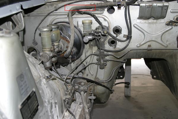

matt drago Posted September 25, 2006 Posted September 25, 2006 As luck would have it, I have a photo of my 73 240Z's engine bay. I have put a red box around the chasis number to make it easier to spot. You can just make out the HS of the number. Hope this helps you out. Quote
Bruce Posted September 25, 2006 Author Posted September 25, 2006 thanks for the photo Matt, It is definately not there. I'll go down to VicRoads in the morning and see what they can do for me cheers Bruce Quote
