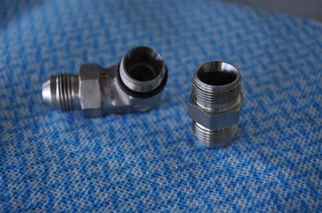

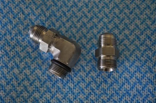

RB30X Posted May 9, 2010 Posted May 9, 2010 Many moons ago in my VLT days, I discovered by accident a stainless fitting with a fine thread size that suited the rocker cover breathers on RB30 engines. Its hard to explain as it not a normal thread size but a thread from a bi-lock pressure fitting. The rocker thread can either go into a 90' or straight into a bsp thread. Rather than tap or weld in a new thread to the rocker cover to suit fittings other than standard, these fittings screwed straight in the standard hole and allowed you to adapt to dash fittings etc. I was looking at the L series rocker cover the other day and they're exactly the same thread size. I was thinking of getting some of these fittings, cutting the rocker thread off and ordering some weld on dash fittings and tig'ing the two together to create a screw in dash fitting for L series engines (or RB engines). I was thinking around -8 to -10 size. Helps when running hoses to a catch can etc. Not sure if this would appeal to many but if your interested let me know. Quote

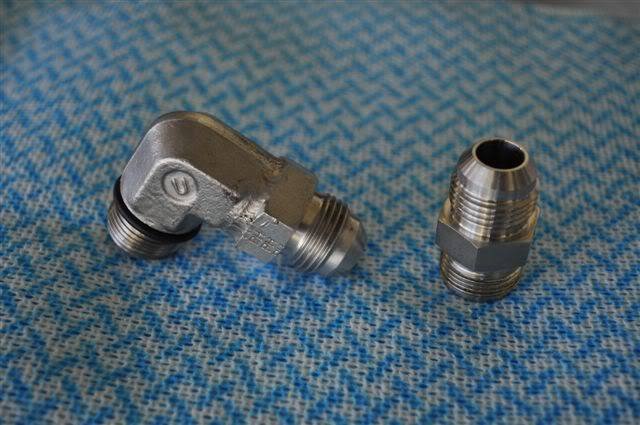

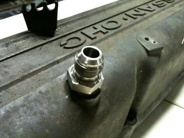

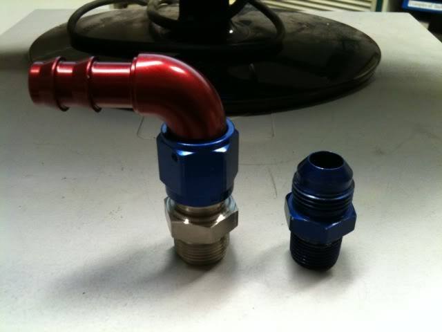

RB30X Posted June 16, 2010 Author Posted June 16, 2010 Well big interest indeed. Knocked a prototype up in the lathe at work anyway due to recent interest in such a fitting in the VL Turbo scene and on Hybrid Z. I like it anyway. Quote

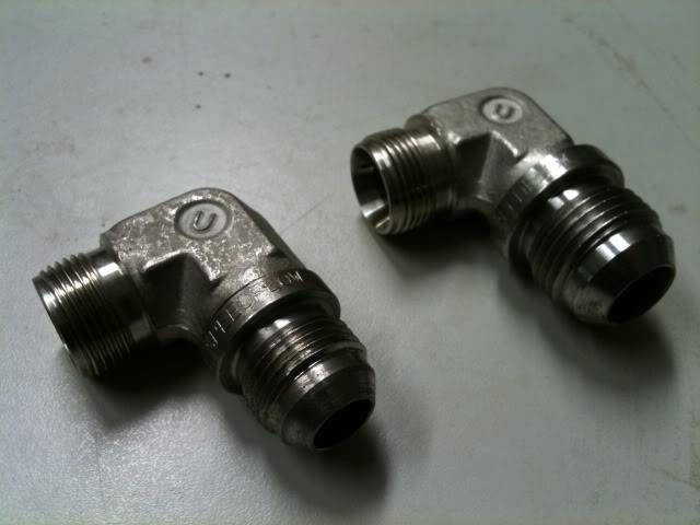

RB30X Posted June 20, 2010 Author Posted June 20, 2010 Here is another option. Elbows that screw straight into rocker cover thread, then tig welded to either -8 or -10 AN flare. This allows you to just buy a straight speedflow fitting instead of a bend. The inside diameter of the -8 elbow fitting can be drilled out to the same Id of a -10 as well, if you doubt the flow of a -8. Quote
RB30X Posted July 1, 2010 Author Posted July 1, 2010 Just updating some prices. I've found a new supplier of parts and can offer these fittings at a lower price. These 'straight' fittings screw straight into your rocker cover: -8 = $35 -10 = $45 -12 = $55 The -8 pieces are solid, straight from a CNC machine and the -10 and -12 are two stainless threads tig welded together. cheers Quote

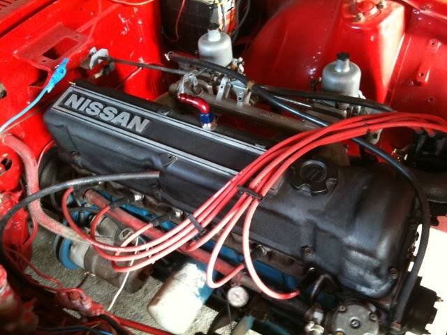

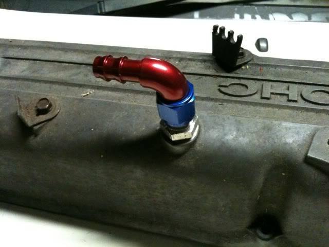

RB30X Posted January 25, 2011 Author Posted January 25, 2011 Just an update. The elbow fitting I made recently for a certain Hakosuka. Quote

RB30X Posted February 14, 2011 Author Posted February 14, 2011 Speedflow also have a similar fitting for about $20 I think. As with yours, you have to re-tap the factory rocker thread though, which requires removing the rocker cover etc and possibly damaging nice paint if its already painted. These ones screw straight in. Yours look good though. Did you say $23 for the rocker fitting and the elbow?? I thought elbows alone were much dearer than that. Do you have a good contact Have you set up your catch can yet? And in case anyone is wondering did you just drill straight through the rocker cover for the second breather and run a tap through the hole or weld in a thread to suit. Feel free to put up a pic of your here too. cheers Quote

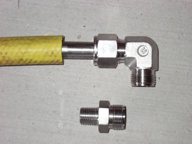

RB30X Posted August 14, 2012 Author Posted August 14, 2012 Its a 1/2 bi-lok tube fitting with the compression cap removed. Good luck finding someone to sell them to you. I had to create an international business account in India. http://www.tubefittings.biz/duc.shtml Quote
lampy Posted August 14, 2012 Posted August 14, 2012 Try Swag-lock of Gyro-Lock fittings their swage fitting thread should be the same Im pretty sure both are made in the USA Quote
