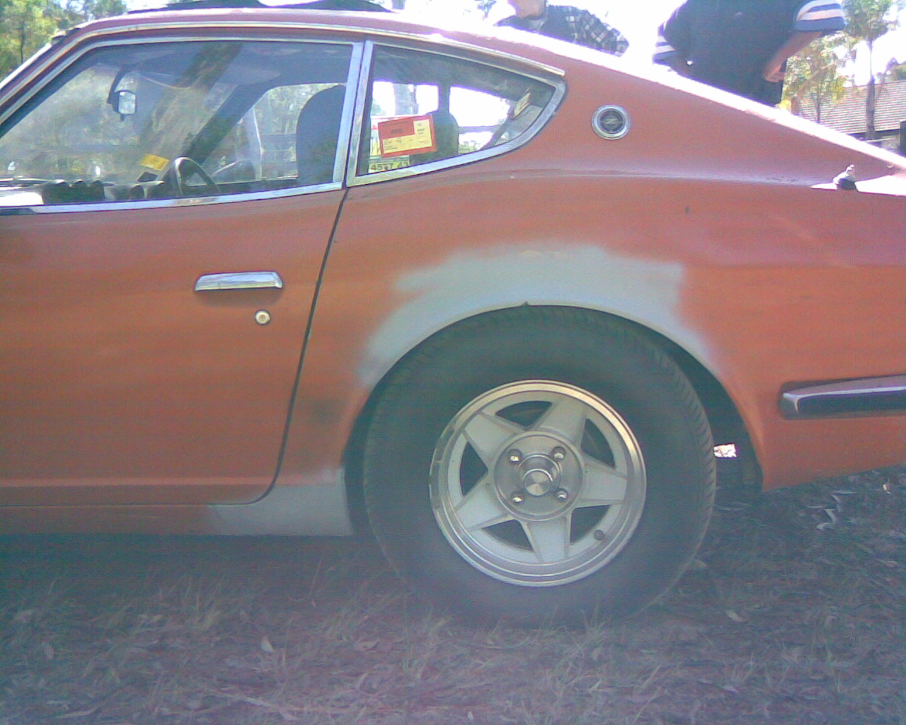

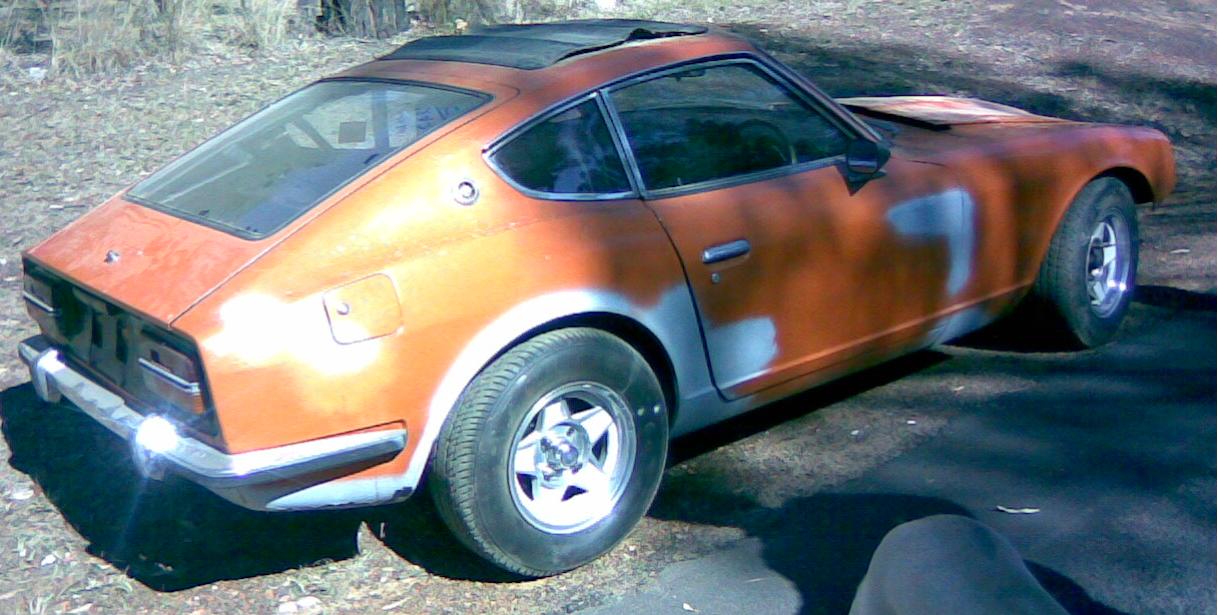

Gday fellas,
Ive just got my first 240z, everything is all good except for the camoflage colour thing going on. Im a uni student so I dont have much dosh to spend on a proper painjob at the moment, hence if someone could tell me how to go about an effective 'backyard workshop' technique that will get me by. Please if you could tell me the kind of paints needed, tools required and procedure, it will be much appreciated. Cheers[/img]

and a pic of my test door
goodluck! ur car looks like it sits nice and low at the back 8)
