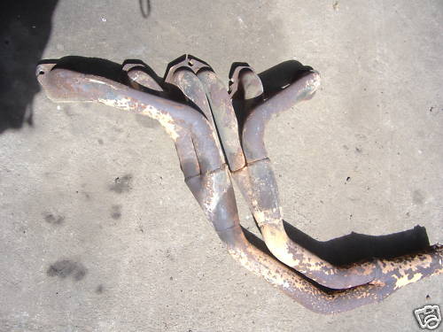

WogsRus Posted December 2, 2009 Posted December 2, 2009 Hi Guys Well would you believe it i got a set of MQ L28 extractors for 99C, that's it not even a whole dollar. I assume these don't fit the 260z due to being longer in the transition from 2 to one pipe? Anyone had experience with this? Has anyone got pics of their extractor setup to see how much i would have to modify these to suit. Has anyone fitted MQ extractors previously? Here is the extractor pic, I think for 99C i will modify these to suit with a new exhaust return to suit the Z car, or sell these on and get a different set? Quote
Moderators Zedman240® Posted December 2, 2009 Moderators Posted December 2, 2009 Best way to find out what you need to do is trial fit them in the engine bay on the motor. You may find clearance issues between the block and chassis rail. Then you will know what you have to do; but for 99c, it is worth it! Quote
C.A.R. Posted December 2, 2009 Posted December 2, 2009 They fit, BUT the outside primary needs to be cut & moved to the inside so that it clears chassis rail. I used a set on my old 2+2 Quote
