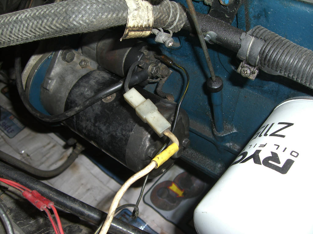

ol_skl_jp Posted December 6, 2009 Author Posted December 6, 2009 maddos i suspect it might be the immobilizer aswell. There is one cable i can't account for and i think it belongs to the immobilizer. Also i dont think i reconnected them correctly after i removed the starter. http://www.mediafire.com/imgbnc.php/1a07d545b5ab98e7394d1ec13e264d0d6g.jpg Quote
ol_skl_jp Posted December 7, 2009 Author Posted December 7, 2009 she came back to life this morning, ended up being the electrical connections. Now for a well deserved drive Quote
