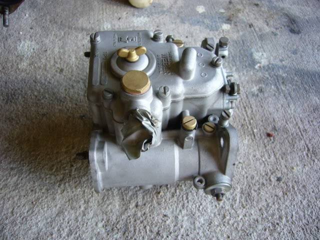

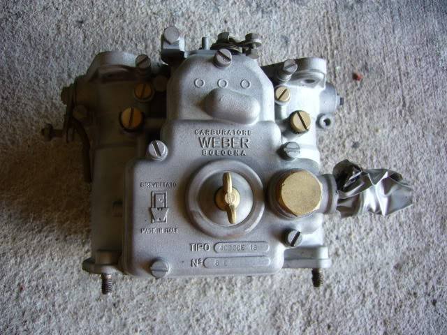

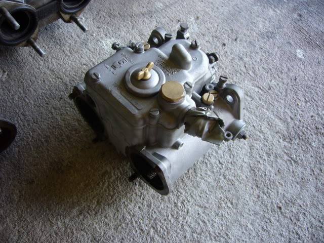

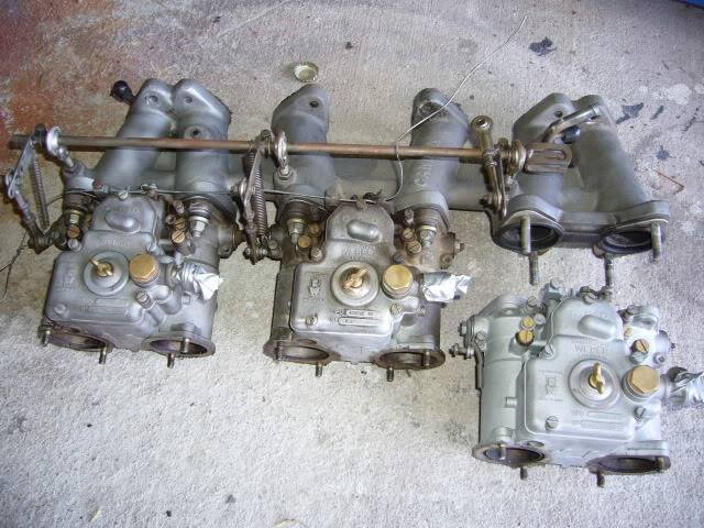

RB30X Posted November 22, 2009 Posted November 22, 2009 I'm sure many of you are cringing at the thought of bead blasting carbs just as I was but after testing it on my old SU's, the results were quite good. I built myself a wooden bead blasting cabinet yesterday and thought I'd test it out. As you know, after installing bling braided fuel lines and speed flow fittings on the L24, all of a sudden the carbs and manifold got terribly dirty. I've tried a few weak chemical cleaners and autosol etc but nothing really removed the stains. After I excepted that some of the throttle shafts were bent and would require dissassembly, i gave them a hit with beads. Before: After: The blasted carb next to the others on the manifold, which I did hit with beads in a few small sections to see how they would work. One question I do have now is should I coat the new surface in a sealer? I have a small spray can of automotive paint clear, would that work or is there a better metal sealer/cear coat I should use? Cheers Quote

RB30X Posted November 22, 2009 Author Posted November 22, 2009 Sounds like the go this coating stuff you speak of. I should've checked this thread earlier this arv. I've done the rest of the carbs and manifold and the one I did yesterday had already started oxidising on the surface where my acidic hands had touched it, so I had to do it again. I had some clear coat left in a tin so I tried that to see how the finish was. I was very happy with the result. The surface soaked up the clear and you can't really see that it has been applied. I wasn't ever going for polished bling look, just a new surface finish which I think is what I got. What did it take me so long to discover bead blasting????? Quote
Sirpent Posted November 22, 2009 Posted November 22, 2009 Look fresh clean and very impressive, Im feeling a whole lot better about eventually doing mine one way or another. Great Job ! Quote
