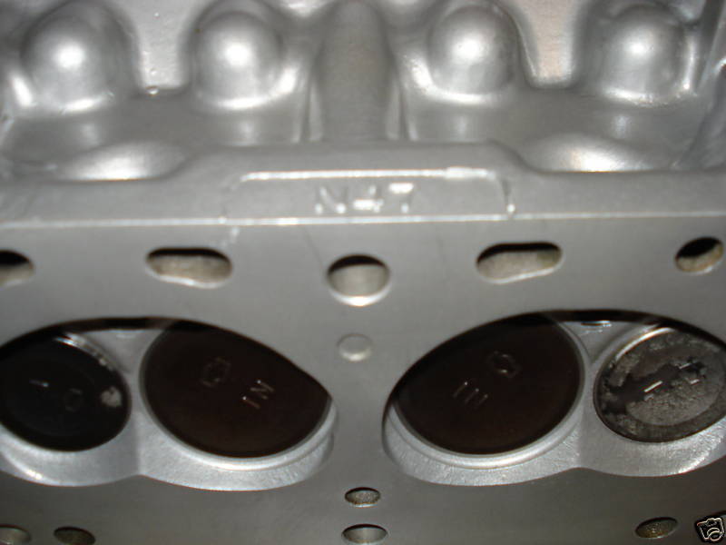

WogsRus Posted November 17, 2009 Author Posted November 17, 2009 Well hence the question, HOWEVER we have just discovered that my brothers L24e head is an MN47 as such, 39cc dish with full quench, i think the CR would work out to be about 10.3:1 with flat tops. Humm her's thinking I have no idea as to who to ask about the cam shaft TA Quote

stevo_gj Posted November 18, 2009 Posted November 18, 2009 Well hence the question, HOWEVER we have just discovered that my brothers L24e head is an MN47 as such, 39cc dish with full quench, i think the CR would work out to be about 10.3:1 with flat tops. ah, so the MN47 head is quite different to the N47. Do you have the intake and exhaust valve sizes? I'll add it to my thread: http://www.viczcar.com/forum/index.php/topic,6012.0.html Quote
WogsRus Posted November 18, 2009 Author Posted November 18, 2009 sure can, heer is a pic of one i found elsewhere. I have not got chinnas head off yet but looking into the head with a pin cam that is what it appears to be Quote
stevo_gj Posted November 18, 2009 Posted November 18, 2009 Cheers, If you could post the dimensions for the intake and exhaust valve in mm that would be sweet. Quote
WogsRus Posted November 18, 2009 Author Posted November 18, 2009 Will do, the pic os of a mates head he got from the states but looks like my brothers. From meory they are the same as N42 in size Quote
