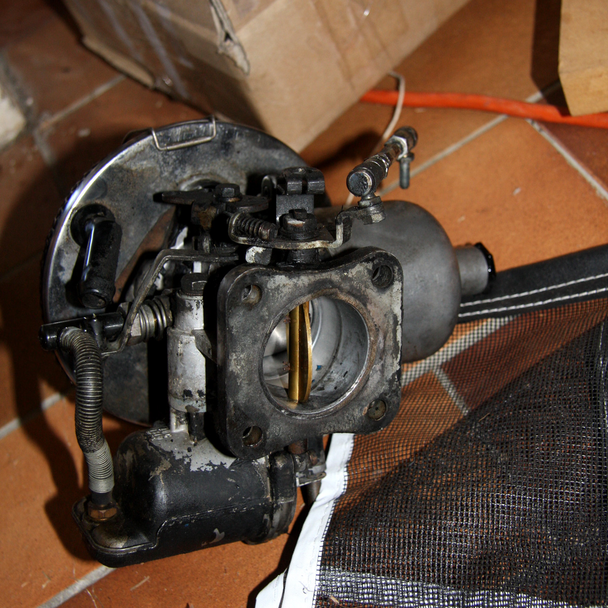

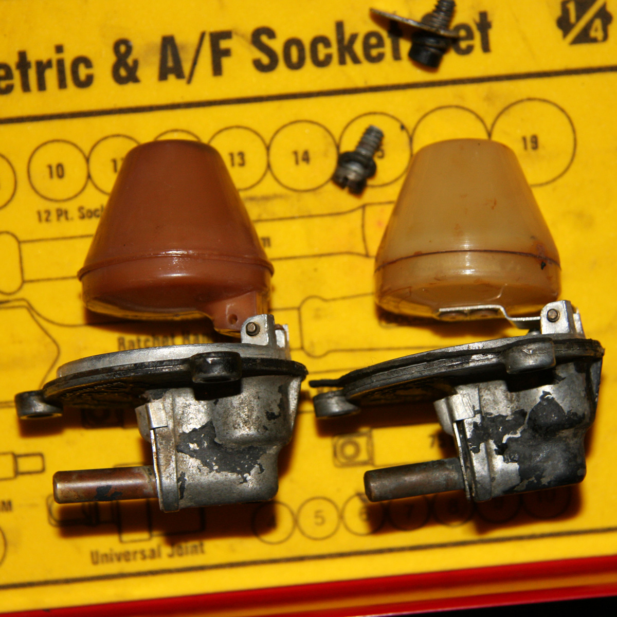

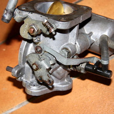

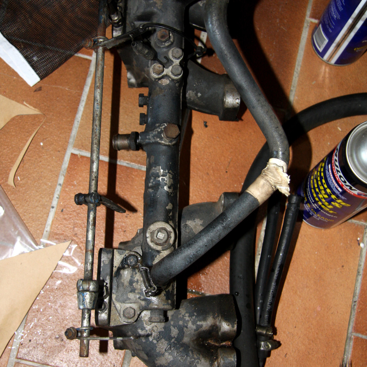

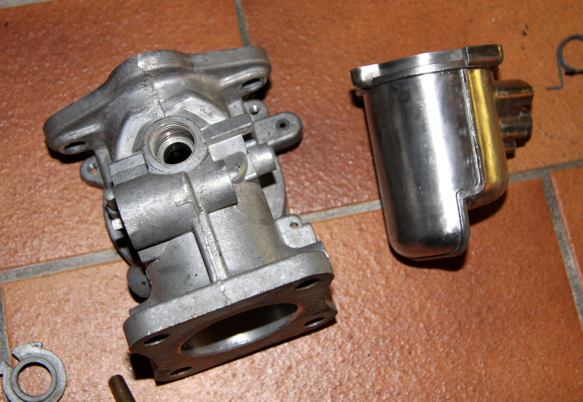

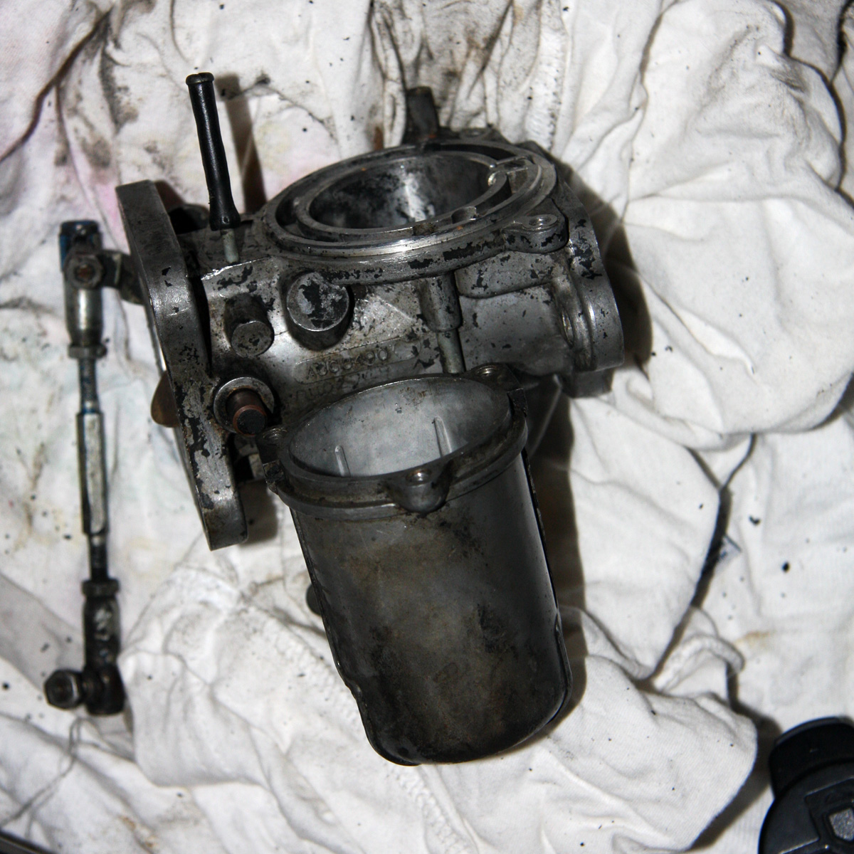

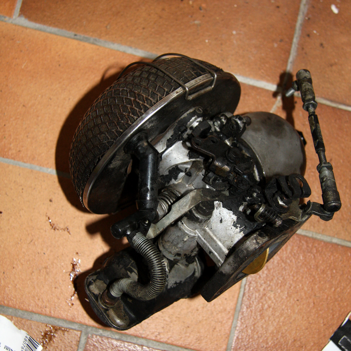

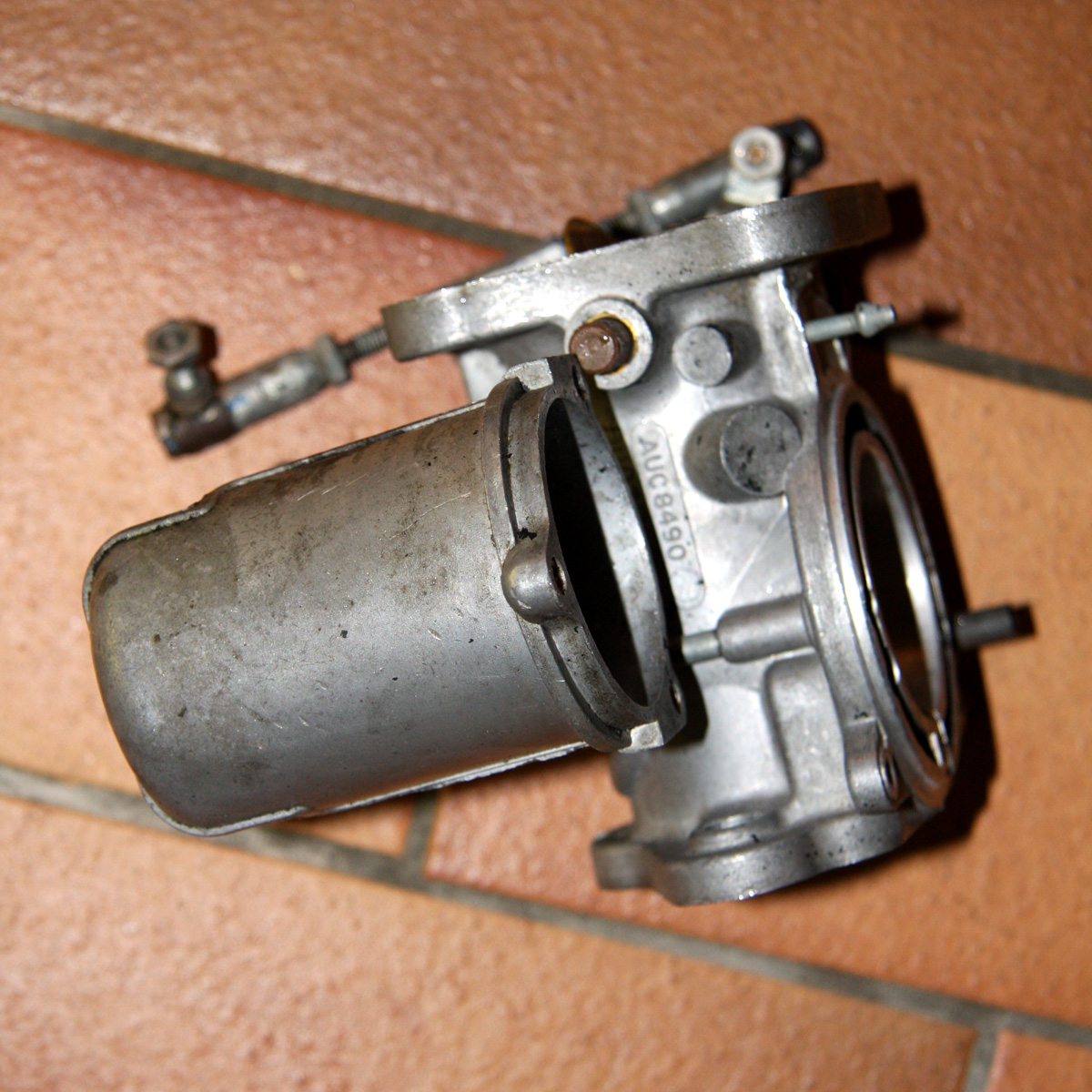

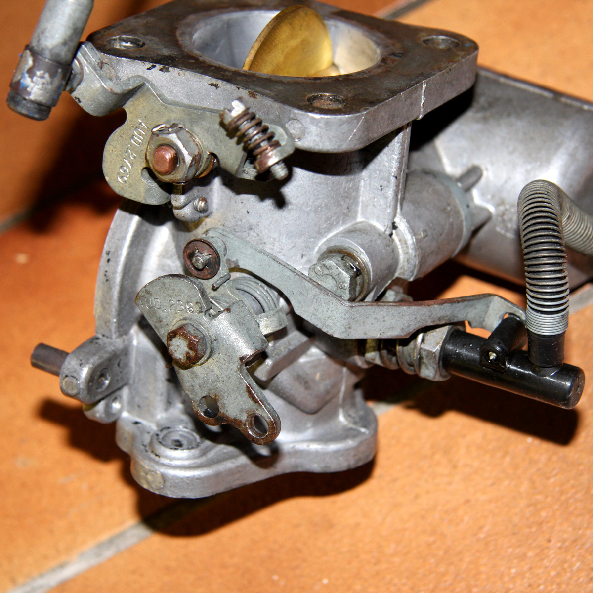

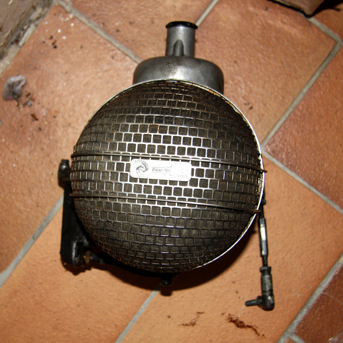

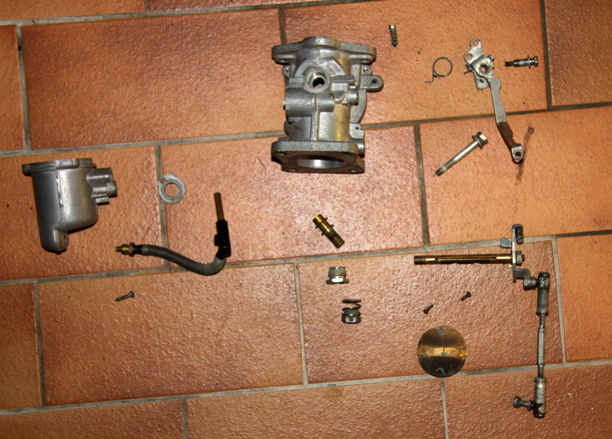

sexual_sushi Posted October 25, 2009 Posted October 25, 2009 I decided to rebuild my SU's as I have been having some fuel problems and I knew I had mismatched floats and needles. Also while I"m at it, I thought I'd just freshen up the manifold and fuel lines etc. This is what I started with Off the car with a quick degrease with carb cleaner <a href="http://www.shaun-maluga.com/Images/Z/RefPics/Carbs/carbs001.jpg"><img src="http://www.shaun-maluga.com/Images/Z/RefPics/Carbs/carbs001Small.jpg"></a><a href="http://www.shaun-maluga.com/Images/Z/RefPics/Carbs/carbs002.jpg"><img src="http://www.shaun-maluga.com/Images/Z/RefPics/Carbs/carbs002Small.jpg"></a> <a href="http://www.shaun-maluga.com/Images/Z/RefPics/Carbs/carbs003.jpg"><img src="http://www.shaun-maluga.com/Images/Z/RefPics/Carbs/carbs003Small.jpg"></a><a href="http://www.shaun-maluga.com/Images/Z/RefPics/Carbs/carbs004.jpg"><img src="http://www.shaun-maluga.com/Images/Z/RefPics/Carbs/carbs004Small.jpg"></a> A bit more cleaning prgoress, jsut using carb cleaner <a href="http://www.shaun-maluga.com/Images/Z/RefPics/Carbs/carbs005.jpg"><img src="http://www.shaun-maluga.com/Images/Z/RefPics/Carbs/carbs005Small.jpg"></a><a href="http://www.shaun-maluga.com/Images/Z/RefPics/Carbs/carbs006.jpg"><img src="http://www.shaun-maluga.com/Images/Z/RefPics/Carbs/carbs006Small.jpg"></a> <a href="http://www.shaun-maluga.com/Images/Z/RefPics/Carbs/carbs013.jpg"><img src="http://www.shaun-maluga.com/Images/Z/RefPics/Carbs/carbs013Small.jpg"></a> Different floats between the front and the back carb <a href="http://www.shaun-maluga.com/Images/Z/RefPics/Carbs/carbs007.jpg"><img src="http://www.shaun-maluga.com/Images/Z/RefPics/Carbs/carbs007Small.jpg"></a> I got new kits and floats from Pro Gas in Brisbane. CODE: SU754 DESCRIPTION: TUNE KIT HS6 .100 $36.10ea +gst. (Brand and codes on box: Fuel Miser su-754) Doesn't include the new float that you can see in the picture... CODE: WZX1300 DESCRIPTION: FLOAT SU HS NYLON SU750FT $65.20 ea +gst or the small choke screw that you can see next to the float. I'm going to reuse the fuel lines from the fuel bowl as the ones in the kit where quite thick. In the ztherapy video he talks about how this is not a good thing as it puts pressure on the main jet assembly which can cause it to stick etc. <a href="http://www.shaun-maluga.com/Images/Z/RefPics/Carbs/carbs008.jpg"><img src="http://www.shaun-maluga.com/Images/Z/RefPics/Carbs/carbs008Small.jpg"></a> Heat spacer things. I got these off ebay but they are for the 1.75 inch su's, mine are 1.5 inch. I still plan to use them but maybe I shouldn't? <a href="http://www.shaun-maluga.com/Images/Z/RefPics/Carbs/carbs009.jpg"><img src="http://www.shaun-maluga.com/Images/Z/RefPics/Carbs/carbs009Small.jpg"></a> More disassembly <a href="http://www.shaun-maluga.com/Images/Z/RefPics/Carbs/carbs010.jpg"><img src="http://www.shaun-maluga.com/Images/Z/RefPics/Carbs/carbs010Small.jpg"></a> More cleaning. I'm not actually going to polish them to be like a mirror, I don't have the time. This was just using a wire wheel on a dremel. <a href="http://www.shaun-maluga.com/Images/Z/RefPics/Carbs/carbs011.jpg"><img src="http://www.shaun-maluga.com/Images/Z/RefPics/Carbs/carbs011Small.jpg"></a> Straightening needles. The kit didn't actually come with needles. I'm using the needles out of a set of flat tops (my current needles wheren't matched). I've heard this is meant to make it run a bit leaner as SU's tend to run a bit rich. I'm not sure that this is what I want though considering these are only 1.5in and they are on a 2.6 litre engine. We'll see when it comes time to tune. These needles where actually very tight, even when coming out of the flat top pistons. I decided to "clean up" the hole for the needles in the round tops but ended up taking a bit too much meat out making the neddle bend slightly when tightened. The british carbs allow you to realign the seat anyway so it seems like it will be fine atm. <a href="http://www.shaun-maluga.com/Images/Z/RefPics/Carbs/carbs012.jpg"><img src="http://www.shaun-maluga.com/Images/Z/RefPics/Carbs/carbs012Small.jpg"></a> That's it for now. I'm hoping to get the manifold bead blasted this week and then hopefully get the linkages electroplated out at Greg's house next weekend. Quote

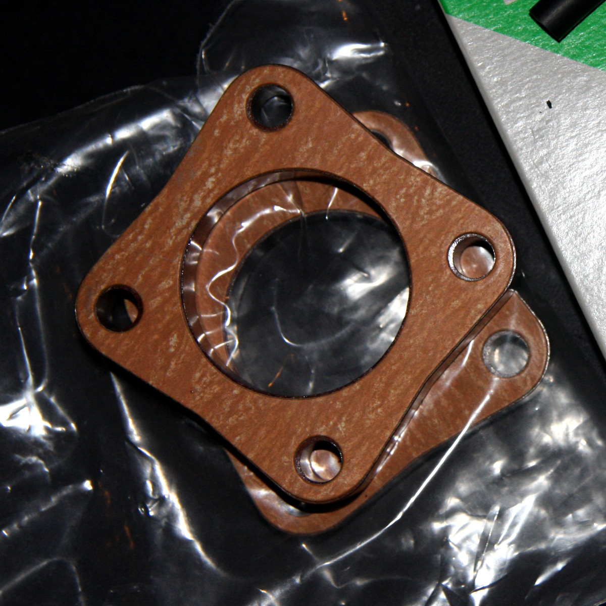

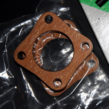

stevo_gj Posted October 25, 2009 Posted October 25, 2009 The only issue with using spacers that have a larger diameter is that it will create some pressure loss due to the flow not being as straight. Since you are not seeking performance it probably won't make a big deal really. Quote
sexual_sushi Posted October 25, 2009 Author Posted October 25, 2009 Just realised the manifold is the 260z one so that side is 1.75in anyway. I put the insulators on the back of the carbs and there isn't that much difference, only about 3mm all round. Not ideal, but like you said, shouldn't matter for my situation. Forgot to mention I have been wathcing the "Just SU's" video from ZTherapy while doing this refresh. Can't stress how valuable that video is. I recommend everyone who's running su's to buy it And a very big thanks to Greg who spent Saturday plating stuff for me when he could have been replacing his brake booster in his bre car for a motorkana on Sunday. Thanks again Greg. Quote

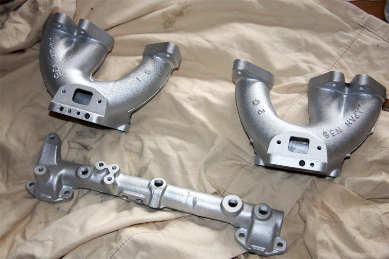

sexual_sushi Posted October 27, 2009 Author Posted October 27, 2009 Woo viczcar is back Sent off the manifold to get bead blasted. Quoted roughly $55 plus gst at: Rockpress Rocklea Pressed Metal 21- 29 Colebard Street East, Acacia Ridge Queensland 4110 (07) 3275 1566 http://www.rockpress.com.au/services/glass-bead-blasting I'll post pictures when it's done Quote

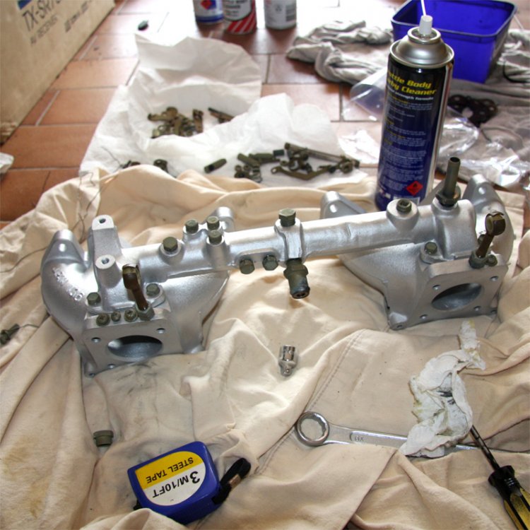

sexual_sushi Posted October 30, 2009 Author Posted October 30, 2009 Just got the manifold back, it looks bloody great. $56.10 total. I'll post pics tonight. Quote

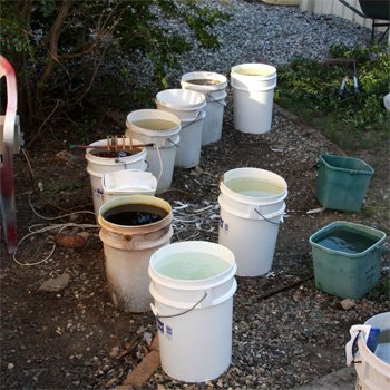

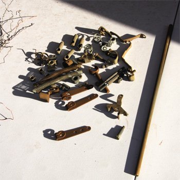

sexual_sushi Posted November 1, 2009 Author Posted November 1, 2009 Busy weekend. Spent Saturday electroplating at Greg's house. Greg hadn't plated anything in a while and things weren't coming out very bright. He thinks he might have needed new anodes but anyway it's better than paint or rusty parts at least Here is the manifold back from the bead blaster And some more reassembly I've got one carb and the manifold back together so I'll rebuild the 2nd carb tonight and then hopefully have it back on the road tomorrow night. And a very big thanks to Greg who spent Saturday plating stuff for me when he could have been replacing his brake booster in his bre car for a motorkana on Sunday. Thanks again Greg. Quote

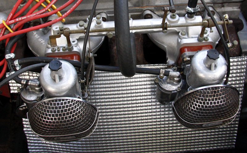

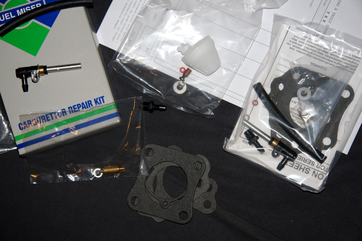

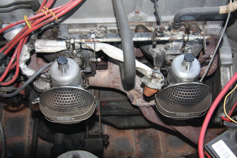

sexual_sushi Posted November 8, 2009 Author Posted November 8, 2009 And they are done... Before After Well mostly done, the car is running but it still needs a bit of fine tuning. Have to wait for my new fuel pump before I get it running 100%, it's hard to tune when the fuel level is fluctuating so much. So in the process I have: - Rebuilt the carbs with new gaskets, floats, needles, jets, filters. The needles are from a set of flat top hitachi's. It's hard to comment on the difference as so much has changed. Hopefully I'll have more info once I get the new fuel pump. - Added the double choke (was only using a single before) - Added the heat spacer things from the carb to the manifold (I realised why they were missing, you can't fit long enough bolts without it fouling on parts of the carb body. I had to drill out the holes slightly so I could angle them in) - Added a cheap heat shield. When I was tuning I noticed the rear fuel bowl was too hot to touch, so i figured I should put some sort of heat shield back in. As you can see in the picture, I snapped one of the bolts on the balancing bar so I will have to drill that out at some point. Doesn't seem to be leaking atm which is good. Quote
