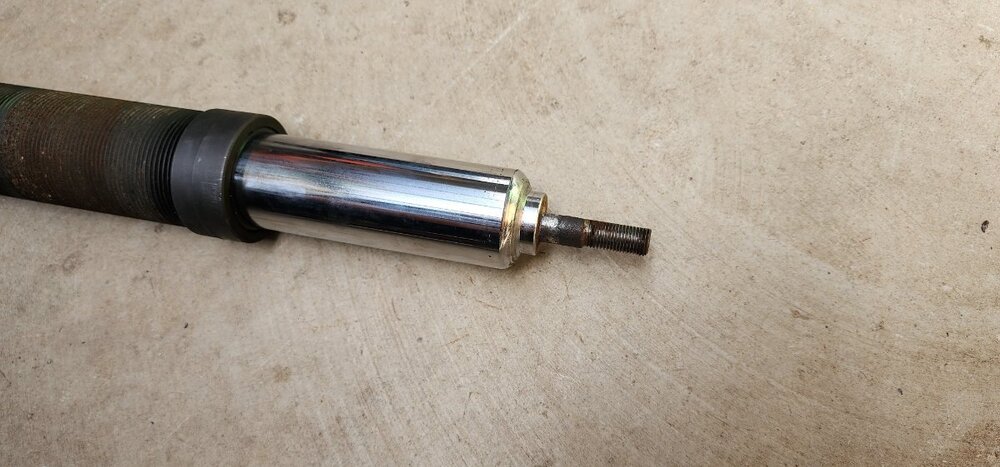

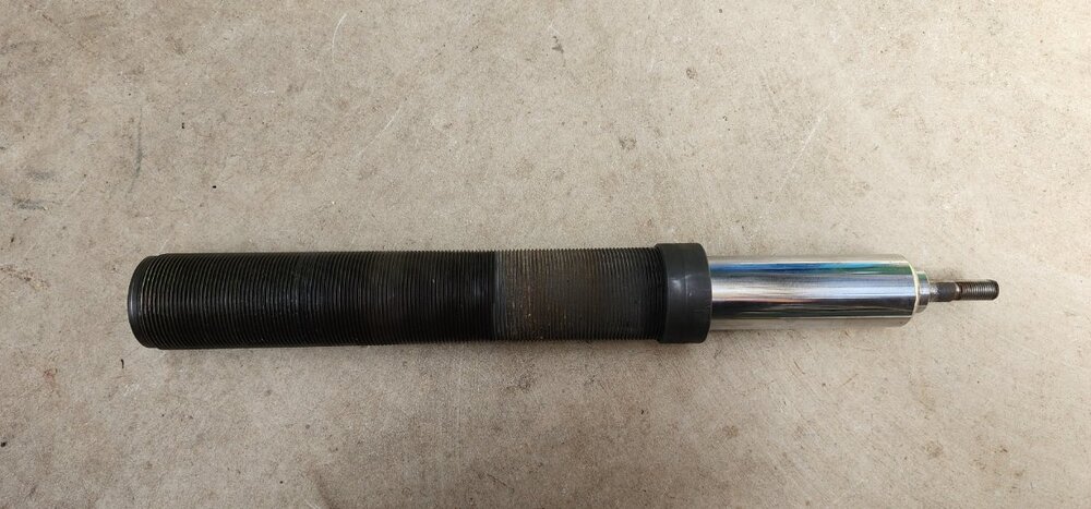

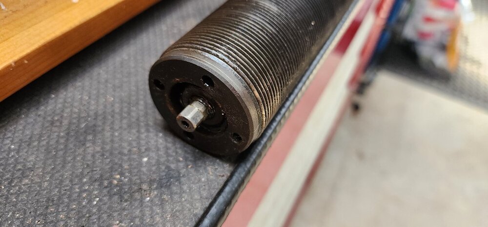

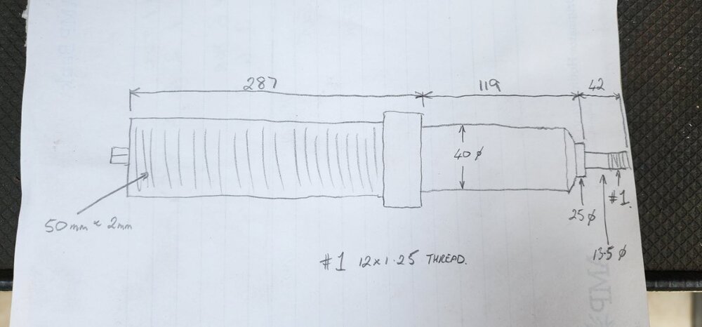

600Z Posted February 5, 2025 Posted February 5, 2025 Hi Guys, Well the time has come that one of my shocks has bleed its oil out into the strut tube, no wonder it was starting to handle a bit funny Arizona Z Car use to use HSD shocks with their coil overs and I'm wondering if anyone might know what model/part number they are through HSD. HSD have changed there housings now to a larger size by the looks of it which doesn't help. Otherwise, does anyone know what other shocks might use 50x2mm housing to save me from having to cut the welded tubes off. Cheers, Justin Quote

600Z Posted February 5, 2025 Author Posted February 5, 2025 Hi Jeff, Thanks, I have sent them an email with pictures etc to see if they are able to help me. If possible although not the cheapest option but it would be nice to run a set of there's for sure, nice gear. I use to deal with them a little bit back in the early 90's (showing my age now lol) when i was building a 2.1L with a rare 219 cylinder head and they have always been great. Do you know if Murray is still alive? I had a set of webers that Iain Stewart (his co driver) did a lot of work on to get them to run better but then changed to 48mm dellortos which were sooo much better. Hopefully they will be able to come up with something though i might have to cut the welded tube i have on off and start again. His 1200 coupe was a weapon, a friend of mine at the time ended up with his cylinder head and 55mm webers from that on his 1600 drag car and i still have one of their ported heads from back then collecting dust lol. Justin Quote

600Z Posted February 6, 2025 Author Posted February 6, 2025 Oh and Murray Coote Automotive don't do any that will fit into my welded on tubes so i would have to cut them off and start again, which may not be a bad option. Quote
