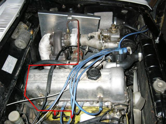

Thomo260 Posted May 19, 2009 Posted May 19, 2009 Here is the path the oil feed line travelled on my 1600. Out from where the oil pressure switch is normally then T off to new switch then behind head to the turbo. This is a solid line, but you can use braided flex hose. Quote
