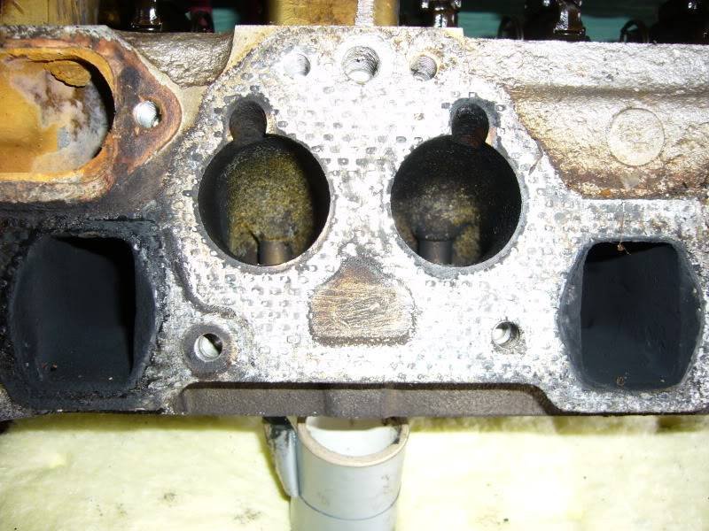

RB30X Posted May 17, 2009 Posted May 17, 2009 I've just taken the N42 head off an F54 block and I was expecting flat tops over dished but I'm not sure what these are. I've seen bigger dishes in pistons but I've also seen flatter flat tops. check out the nice bores too by the way, hone marks are still there from 30 years ago. Plans are to polish/port match this head to the gasket but I'm waiting for a carb manifold and extractors to ensure they all match up. cheers Quote
zzzzed Posted May 17, 2009 Posted May 17, 2009 they look the same as the stdard pistons in my n42 block Quote
NZeder Posted May 17, 2009 Posted May 17, 2009 Look like the standard dish piston to me - I have never seen a N42/F54 combo with flattop's yet and I have seen a few apart over the years. I believe the flat top were on the NA P90/F54 setups. These pistons (your pics) will have a 10cc dish Quote
garvice Posted May 17, 2009 Posted May 17, 2009 That is one way to check, fill the piston dish with water and then poor into medicine glass, or vice versa to see if it matches NZeders 10cc. Quote
RB30X Posted May 17, 2009 Author Posted May 17, 2009 Bugger. Thats half the reason i bought this car the wreck, the F54 block with the supposed flat tops. Oh well looks like i'll have to buy some seperately. Quote
luke_mcmahon85 Posted May 17, 2009 Posted May 17, 2009 yeah dished pistons.... the flat tops in my f54/p90A have no dish at all Quote
