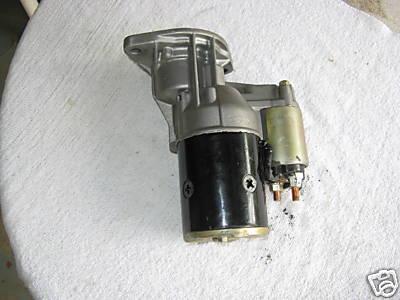

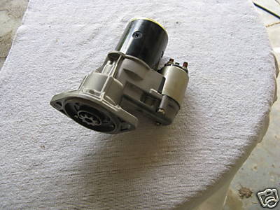

xa1973 Posted May 13, 2009 Posted May 13, 2009 Alternate.......... OEM starters draw a lot of current from your battery, more so when they get on in age, even with a new battery youve only fixed half the problem.. I bought a High Torque for my ZX, works very very well, is half the size of OEM and spins like a tornado.... Quote
xa1973 Posted May 14, 2009 Posted May 14, 2009 Is High Torque the brand??? More info please Specs and info as per the link by Jane You can either buy them here in Aus or from Ebay USA ( they donot cost what the UK site has them listed for ) Ive put one in both my Fords and Mustang...Au $200.00 Chev's the same $$ value I paid Au $170.00 for the L series unit....as pictured Cheers Quote
Moderators Zedman240® Posted May 14, 2009 Moderators Posted May 14, 2009 Mine is a planetary gear starter which isn't old at all but when that wears out, that last one there will be going in for sure! Lighter, quicker and draws less power...what else do you want? Quote
