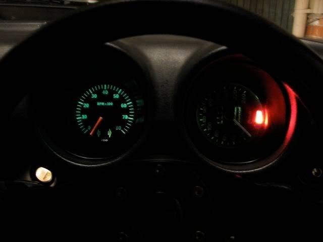

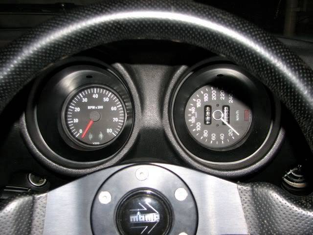

mtopxsecret6 Posted August 25, 2009 Author Posted August 25, 2009 does anybody know what size aftermarket tacho fits in the original position? Thanks. Quote
garvice Posted August 25, 2009 Posted August 25, 2009 I have a 100mm Tacho in mine, little bit smaller then factory but a good fit. Quote

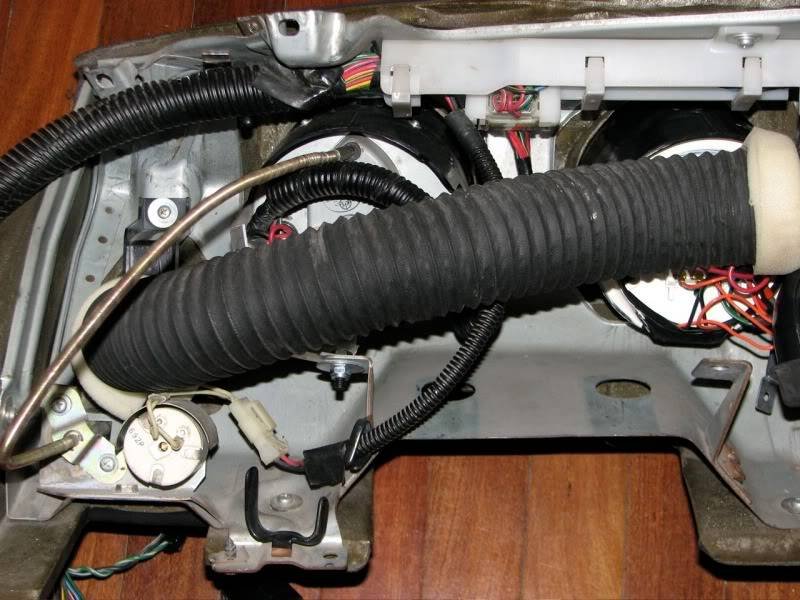

Moderators Zedman240® Posted August 25, 2009 Moderators Posted August 25, 2009 To remove the tacho, there are two wingnuts on the back that you have to undo, then unplug the electrical connector and remove that screw from the front/top and it should come out from the front. It may be easier with the steering wheel removed. Removing it is simple; re-installation is the PITA! edit: Sorry..that's for 240Z! Garvice has the right info! Quote
garvice Posted August 25, 2009 Posted August 25, 2009 Oh yeah, to remove there is the front screw and there is also a screw at the rear of the tacho. You can see the brackets underneath the speedo and tacho although I am not using the tacho one. Quote

mtopxsecret6 Posted August 26, 2009 Author Posted August 26, 2009 garvice, did your tacho come with the indicator lights on the face, or did you custom fit them on yourself? thanks. Quote
garvice Posted August 26, 2009 Posted August 26, 2009 No, I made them. Here is the writeup http://forums.hybridz.org/showthread.php?t=143337 Quote
mtopxsecret6 Posted August 29, 2009 Author Posted August 29, 2009 awesome.. such a simple concept! Quote
