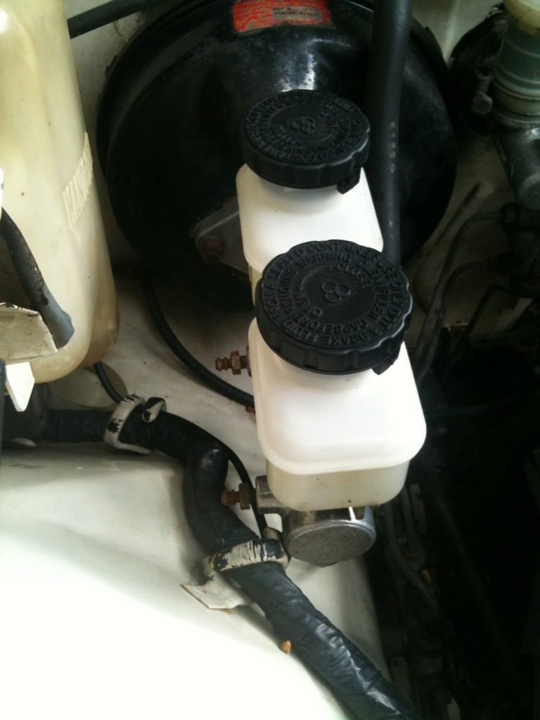

GongZ Posted December 31, 2010 Posted December 31, 2010 Hi all - I am still looking to buy a 1979-1981 280ZX (15/16") brake master cylinder for my 240Z (1973). As others have said - new ones only seem to be available from the US. I have done lots of searching on the web and Black Dragon seem to have the best price at US$139. The only hesitation I have is that the bleed valves are on the right hand side of the cylinder (I assume they were the same on Australian 280ZX's?), which would make the bleed valves quite close to the inner guard. Can someone with a 280ZX master cylinder in a 240Z or 260Z tell me if this is an issue when bleeding the cylinder? Happy New Year Ian Quote

Riceburner Posted December 31, 2010 Posted December 31, 2010 I've done this mod, there are no clearance issues, one of them is a little harder to bleed. If you really want to you can remove the bleeders and put them on the other side with a some extra work. I just left them on the right side as I won't need to bleed it again. I also fitted my 240 reserviors and caps as they were in very good condition. Quote
Riceburner Posted December 31, 2010 Posted December 31, 2010 Here's the pic. The front bleeder has about 25mm clearance and the rear has a truckload Quote
RayRay Posted December 31, 2010 Posted December 31, 2010 Ah there you go, mines almost like Gareth's picture, except I swapped my reservoirs from the old master cylinder to the new one. Quote
GongZ Posted December 31, 2010 Posted December 31, 2010 Thanks Ray and Gareth - great responses! Quote
