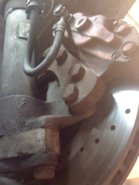

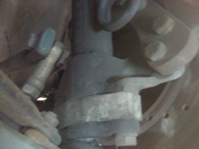

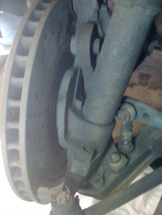

Meeting with my new engineer on Wednesday so I thought I best know what going on with the front brakes/suspension...

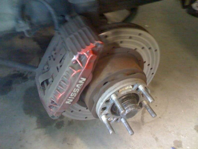

Can you please let me know what struts these are, either 240 or 260??? I know that they are r33 calipers, and BMW 735 discs, but do we think I could pull the disc and have them machined to be 4x113.4 PCD?
Are the alloy blocks the bumpsteer removing ones?
Cheers,
Thomas
Easy way to identify the strut is to measure (with a vernier caliper) the diameter; 51mm 240Z, 55mm 260Z.
As for the hub, looks like you are using the BMW disc and hub. Might be easier to find another suitable disc to use with a 260Z hub. You would have to re-drill the hub for the 114.3 PCD and not the disc.
Ok. I will rip out the verniers tonight  8) Question though - due to me having the koni adjustable insert coilover setup would these values remain constant?
So your saying that I am using a BMW hub and disc? So your saying the best option is to find a 260 hub and then a suitable disc and go from there? I know of a 260 at a Pick-A-Part not far from home....
