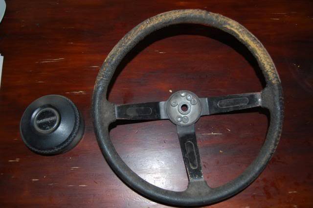

I did a bit of a search here on the forums to see if anyone had tried to repair the grip on their original Zed's steering wheel.
I may have missed something but I couldn't find anyone who had tried (or bothered)
There are some companies out there that either restore the wheel skins by re-injecting them with polymers or products you can buy yourself, but they seem to have mixed results.
Here's the wheel from my 260z that I was thinking of restoring
If anyone has any info or ideas on this I would greatly appreciate it.
if u want to retain the original most prob try source one in better condition or get it redone in leather. rough cost 80-100. other than that.
if u want to do it your self.
i would repair the steering wheel so it looks like its in good conditions ie body filler.
make a mould. strip the steering wheel. position it correctly and than pour new rubber in the mould. u can get polyrubber kits
but the time and effort to get anywhere near as good as new will far outweigh the trimmer cost in getting it redone in leather or just buying a nardi or similar old school steering wheels.
or get a 240z wooden one.
I'm guessing the wheel I've pictured above isn't worth a lot in good condition anyway.
I know 240z steering wheels are worth a bit in good condition. You might be able to source a new 260z style wheel from Japan for cheaper than repair cost.
