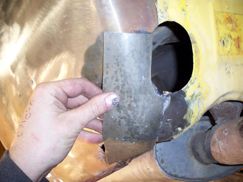

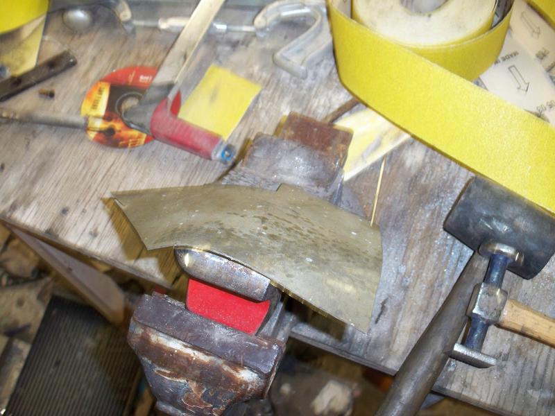

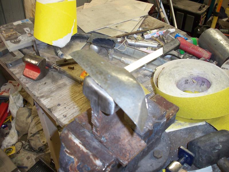

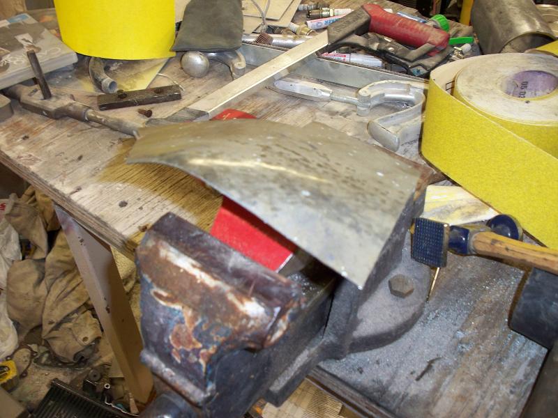

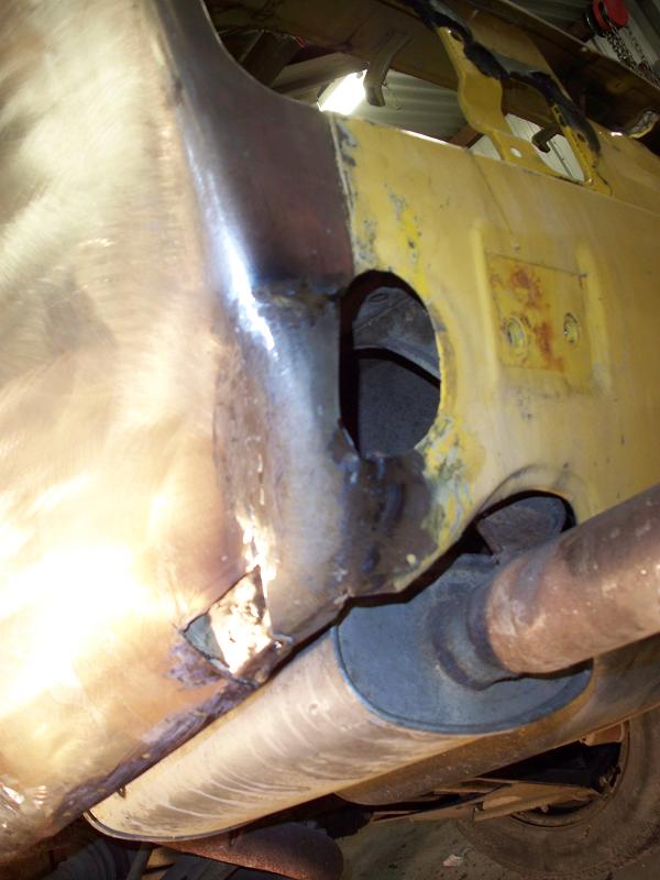

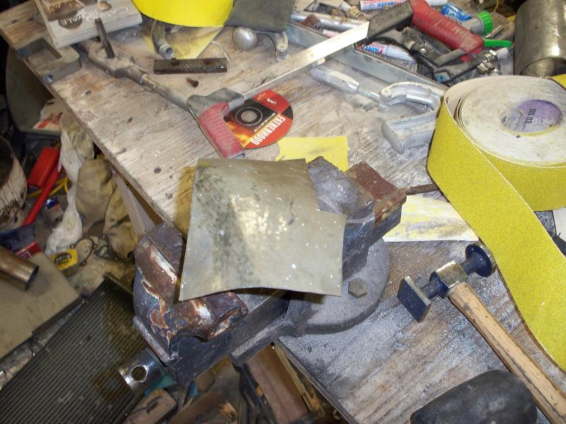

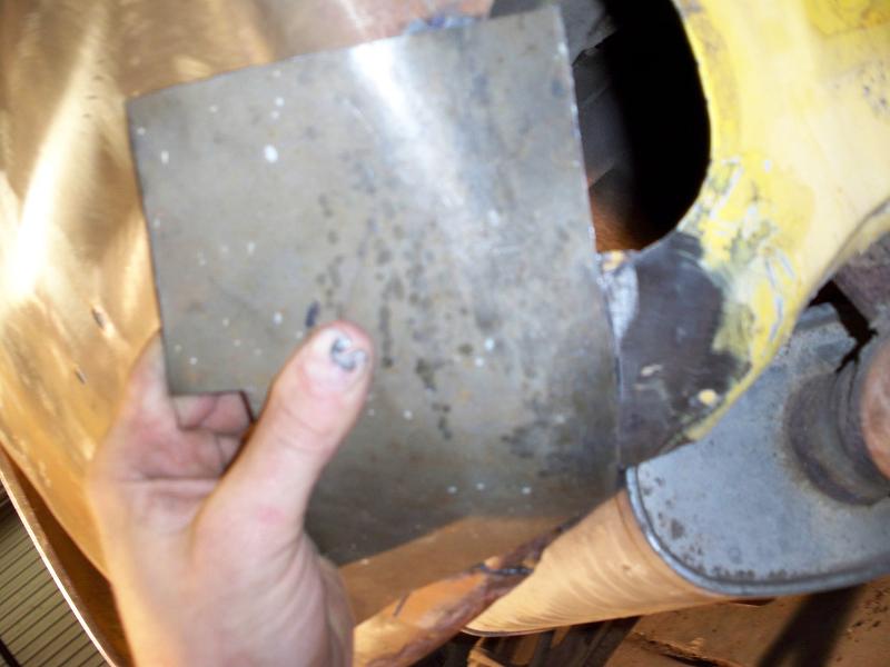

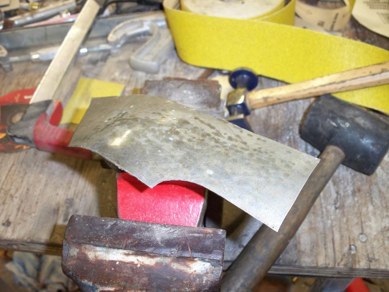

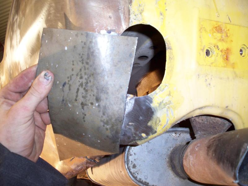

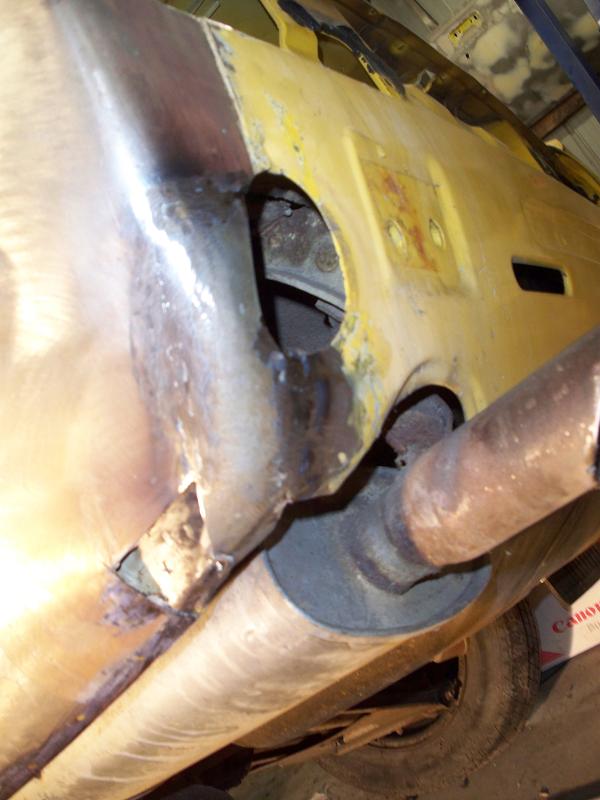

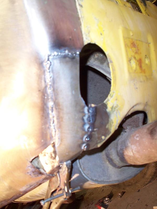

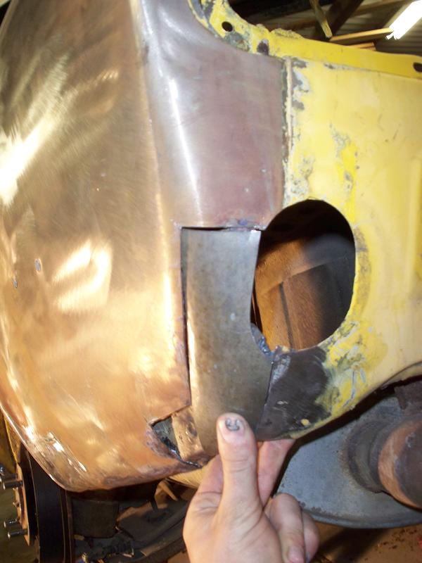

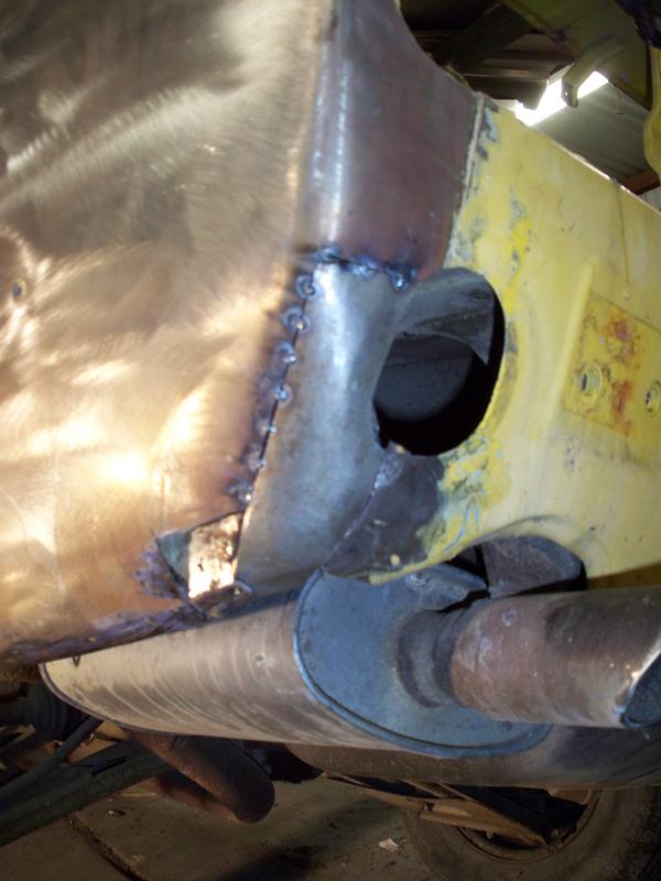

Dingo Dave Posted December 14, 2008 Author Posted December 14, 2008 Started work on the rear corner of the car. Quote
zzzzed Posted December 14, 2008 Posted December 14, 2008 Nice mate. Its amazing what you can do with a bench vice and a hammer. Did you hit your thumb nails did you? I did that a few months back and had to relieve the pressure by drilling a hole in my thumb nail lol. It was instant relief Quote
sco_aus Posted December 14, 2008 Posted December 14, 2008 A red hot needle also works well and maybe a little more hygenic Quote

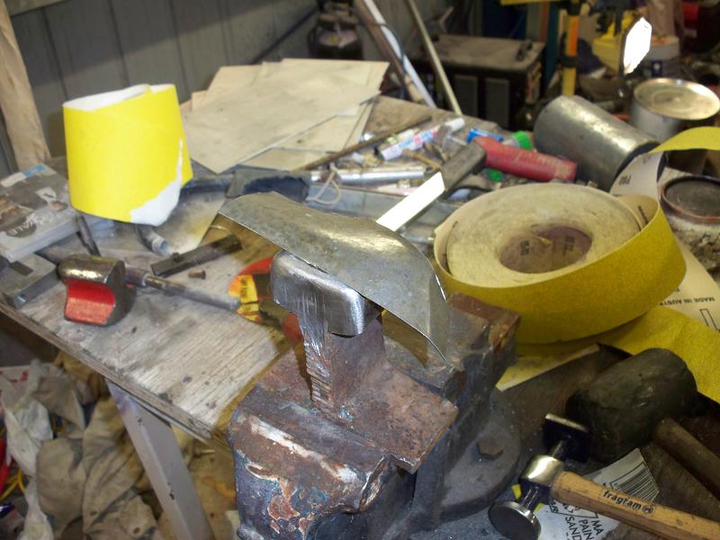

Dingo Dave Posted December 15, 2008 Author Posted December 15, 2008 nah got a love bite from the milling machine lol. no need to relieve pressure it did it for me. didn't even hurt till like the next day. I hit my fingers and thumbs all the time. but when your panel beating your not hitting hard. If you actually look i have a few different dollies i put in it. some made from rail way line. you just cut it off then shape it and then start playing with it. Most of the dollies i use I make. I think of something cut the metal out shape it as see how it works. Made an anvil once from a piece of rail way track. had to mill it and lath it and heat it and cool it and it made a mad little anvil for an apprentice fitter machinist. then someone broke into my workshop and stole it. Quote
Dingo Dave Posted December 16, 2008 Author Posted December 16, 2008 I'm back. A little dirty and a little tired but more work has progressed. It is getting near the finishing of this quarter. I am happy to say. Did a little bit of electrical work last night. Turns out that the alternator is the cause of my electrical problems. Its grounding out. No worries I'm Sure I have like another 4 in the storage shed. So I had her turning over last night. Not starting But there are reasons for that. Quote
zzzzed Posted December 16, 2008 Posted December 16, 2008 Good job that is a tricky shape, but not as tricky as the bit inside the dog leg Quote

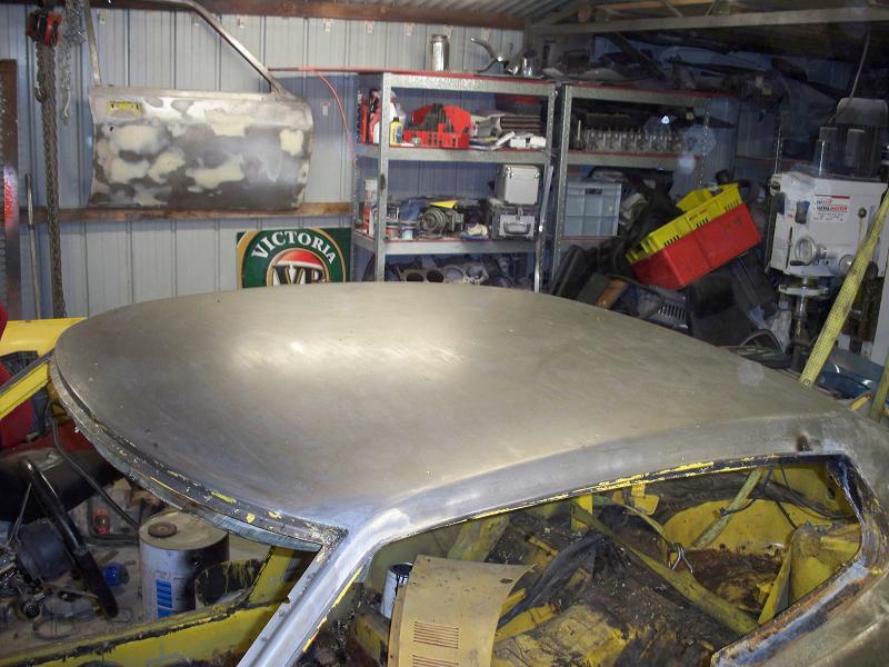

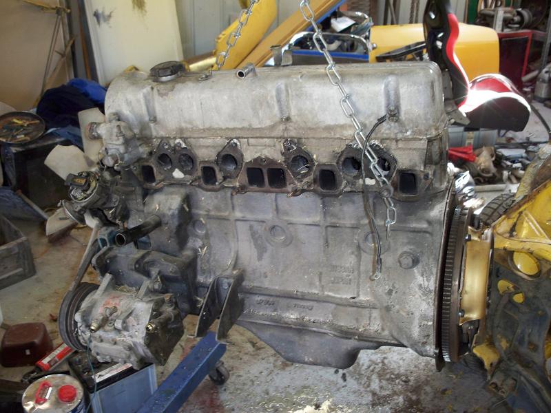

Dingo Dave Posted January 1, 2009 Author Posted January 1, 2009 A little work has progressed. more paint stripping and preperation. Ran out of gas for the welder but that hopefully will be fixed tomorrow. The state of the engine tells me that its been looked after of its been out before. I dont think i have pulled an engine out that clean before lol. The engine bay is coming up nicely. As did the roof and the rest of the car. Few spots to finish then it can be painted and put back together. still a bit of a way off as of yet. Quote

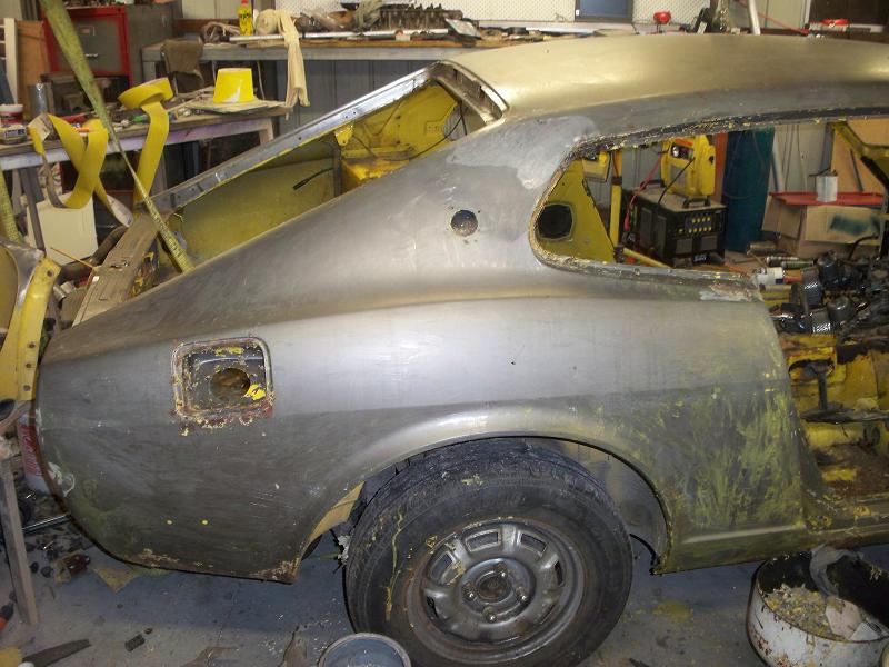

Dingo Dave Posted January 6, 2009 Author Posted January 6, 2009 As i was stripping out the engine bay i realized how much damage had been done to the front end. There was a bit of a crumple after the radiator wall. So the car was torchered. Finding a decent place to fix an anchor to the back of the car and then using the bumper mounts the mount the front we stretched the car. The idea is to put pressure on the body so that when you start to hammer it into shape it pulls out the right way. So after a little hammering. a bit of slid hammering and some stretching the front is a lot better then it was. there is still a bit of work but much better. There was no frame bent in the damage which makes it alot easyer. Sorry I forgot to grab pics. The roof got some attention today as well with the fact that i found some ribs in it. So the oxy got bort out to help with that. Unfortunatly not long after starting I ran out of oxygen so work had to be stopped. But the mig got started up and some more welding took place and the hammer has been happily working and making a difference. More to some. Maybe some primer. Quote

Dingo Dave Posted February 24, 2009 Author Posted February 24, 2009 Well I would like to thank those who have and are helping me on my car. Its good to sometimes have a team at work on something that is mine and not a customers. Anyone is welcome to come and help if they wish. I will apologise in advance if you do lol. Well I really haven't posted anything up on the thread for a while. Not because I haven't done anything but because I been slack on posting it. Well the roof is pretty much in primer. I have welded up the passenger side. It went in primer this arvo. I am quite impressed on the lines and quarter of the car. The line half way up is sharp enough to shave off. So why am I still hairy. Some people have been doing some crap work for me around the car like prepping for primer and cleaning and sanding. Doing a great job. Scott and I are heading out on Thursday to look at a 1200 coupe. See what condition its in and how well dressed it is. See if its worth the money being asked and if I can work my sweat and blood into it and make it like new again. But as it is there is no pics. I forgot to charge the camera so they will wait till tomorrow night. Maybe. Quote

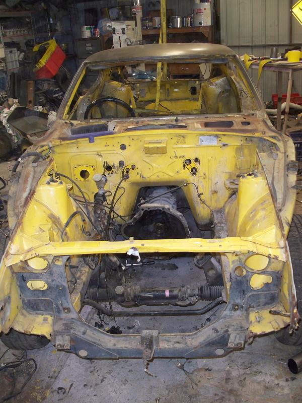

Dingo Posted March 9, 2011 Posted March 9, 2011 Good evening to everyone. Well it's been on hold for some time now but yella is back in the workshop and getting some attention. Engine bay has been stripped and getting ready for paint. Quote
