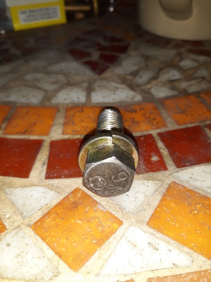

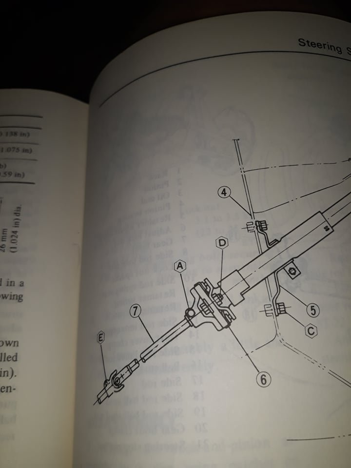

old and bold Posted October 10, 2021 Posted October 10, 2021 G'day. So I stuffed up and cross threaded 2 bolts on the steering assembly (didnt have the splines lined up.) Can anyone help with bolt/thread size - they are 25mm long or failing that a datsun/nissan part number. Picture of bolt attached and on the assembly diagram they are bolts A and E (they are the same size.) Thanks if anyone can be of assistance Quote
C.A.R. Posted October 10, 2021 Posted October 10, 2021 M10x1.25, 25mm long, Nissan grade 9 I don't have a Nissan part number, I'm afraid. Ponyo240z 1 Quote
