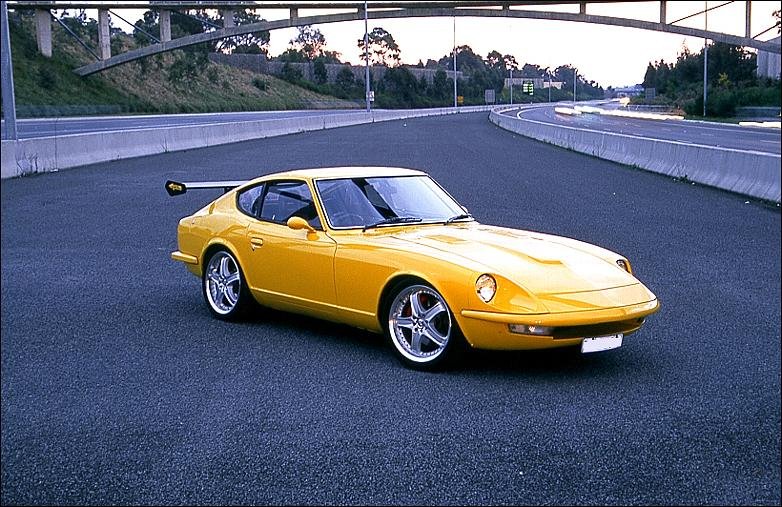

I was under the impression Jack's (yellow 240z with L28ET) had an FJ20 box, or maybe it was an FJ20 bell housing?
I'm not sure, Jack hasn't signed in here in ages and I never see him on MSN anymore. He might still be watching the site???
There is a guy in Queensland called Simon with a yellow L28 Turbo Z. I think he used an S13 gearbox, with 260z bell housing - not 100% sure though.
if thats the car in the mag then it confirms what lurch has said
from what i remember jack saying at that awesome cruise lurch organized is it is a 25 gearbox, was it has to be done just right otherwise it spits out (either the flywheel or clutch plate) though the bellhousing?!?
the article that image is stolen from says the car has a "heavily internally modified late model FJ20T gearbox", so maybe it was changed since it was written?
I positive it now runs a 25det box.
I remember talking about it in the Safeway carpark in Belgrave after that insane cruise... ;D :P
