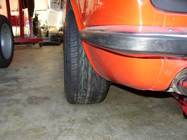

NZeder Posted January 9, 2006 Posted January 9, 2006 sweet, a good wheel rim combo for those rims would be. 205/55/16 on the 16x7 fronts and 225/50/16 on the 16x8 rear. this will be the same same (well almost front will be 2mm taller total) rolling diameter as the stock 260z tyre 195SR14. These size tyres are a good fit on those rims (I used to have 205/55/15 on a 15x7 and 225/50/15 on 15x8 but they were not wide enough so they were swapped for a genuine Z-Gnose. Attached is a pic of 15's with this combo. What are the offset of those rims? +20? if you are using stock suspension the max back space is 4.5" so if these have more you will need to run a spacer to give you 4.5" of back space (the rears you can get away with 4.75" if I recall correctly) So that makes +12 on the fronts and +6 on the rear. The rims I had were 15x7 -6 and 15x8-12 (photos on with them installed on mates 240z stock suspension) Quote

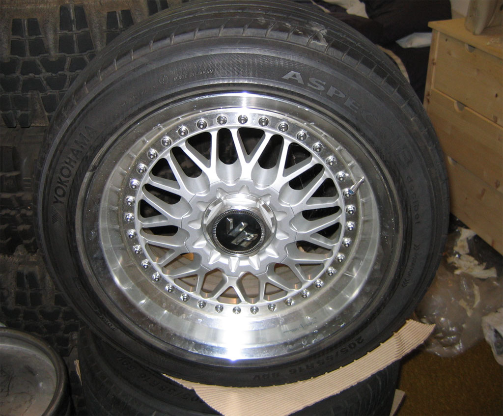

Zeddophile Posted January 12, 2006 Author Posted January 12, 2006 Arrived today, and some suprises - some expected, but pleasant nonetheless, others quite unexpected. All rims are very clean, apart from a little dirt here and there, absolutely no gutter rash anywhere. They appear to be genuine Volks, with Rays Engineering on every single bolt around the rim, and also stamped on the rim itself - also with nice little metal valve caps, which probably won't last long in melbourne, might take them off and put normal black plastic ones on. The centre centre cap screws on, and is made of metal, although the bit that actually covers wheelnuts is plastic (Rays engineering stamped in there too!) Tyres are Yokohama Aspec dB, look quite decent, although unfortunately they are all 205/55 - 16 (On 8inch rims, thats a little odd!) Offset is +25 on both the 7 inch and the 8 inch rims, which wasn't as massive as I expected, so adaptors will be about half as thick as I thought. The biggest surprise though, is that the fake rivets are not fake. These are actually two piece rims! I nearly fell over, it was very unexpected. Quote
